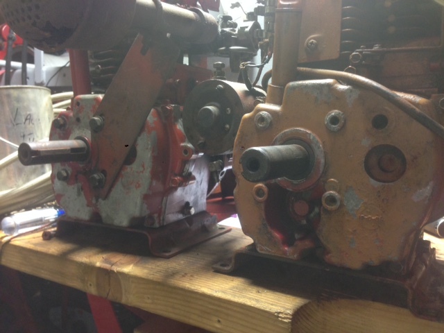

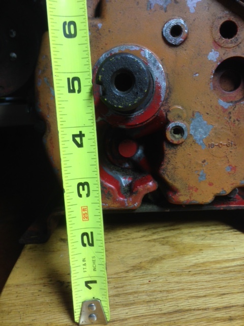

formariz 12,370 #4 Posted August 5, 2017 (edited) On 7/29/2017 at 11:54 AM, Tgtack said: Does anyone know if the Lauson/Tecumseh HH55 and HH60 engines are physically the same size? Heard you could substitute an HH60 engine for the HH55 on a WH model 551 tractor. I can get a clean running HH60, good luck finding an HH55! The correct engine for the 551 the H55D-2113 has a cast iron base attached to engine. On all H60s that I have there is a steel base that places the bottom of engine 1-1/4" and shaft at 4-3/4" from frame as opposed to 3/4" and 4-1/4"for the correct engine. There are some H55s with that same base as you can see in photo. Those are identical in size to the H60s but place shaft 1/2" too high for the 551 as the H60 will. Although I cannot verify it since it is on tractor and deck is in way, the bottom cast plate should be removable since it is attached to block with bolts as you can see in engine parts diagram. In all the others I have the steel base is bolted on block as you can see in photo so the one on the 2113 spec should also be bolted on block. H55 with steel base H55 and H60 side by side Bottom plate attached to H55 Edited August 5, 2017 by formariz Share this post Link to post Share on other sites
