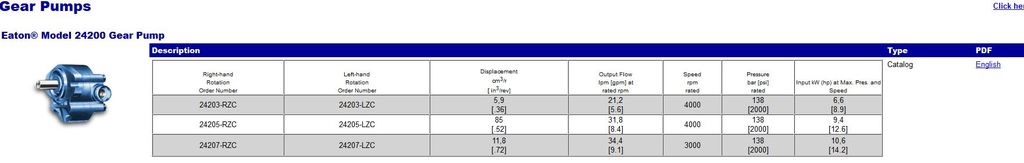

hondagod64 81 #1 Posted July 29, 2017 i'M LOOKING FOR INFORMATION AND OR A GOOD SOURCE TO PURCHASE A NEW HYDRAULIC PUMP FOR MY 78 550 LOADER NUMBERS ON THE O E M PUMP ARE H24203-RAG -5NC43-LAL.. I CAN'T FIND ANY INFO ON THIS PUMP AND LOOKING FOR SOME HELP IN WHAT A GOOD SOURCE OR DIRECTION I MAY GO IN, HYDRAULIC SHOPS AROUND HERE SEEM NOT TO BE BOTHERED ...ONE PERSON AT ONE SHOP TOLD ME I'M WASTING MY TIME WITH A TONKA TOY...CAN YOU BELIEVE HE SAID THAT!!! ANYWAYS, ANY HELP WOULD BE GREAT... THANK S AGAIN Share this post Link to post Share on other sites
pfrederi 21,231 #2 Posted July 29, 2017 This one should be close at least give you specs on displacement and pressure. http://www.vickersmexico.com.mx/images/pumps/pdf/gear_pumps/01-619.pdf Cessna and Eaton now seem to bee one company 1 Share this post Link to post Share on other sites

MalMac 1,337 #5 Posted July 29, 2017 Eaton did buy out Cessna hydraulics. Find a Eaton hydraulics dealer and they might be able to help match you up. Probably be some big $$$$$ though. Seems like a while back I did find a Eaton that was identical to the Cessna that was used 1 Share this post Link to post Share on other sites
Shynon 7,723 #6 Posted July 30, 2017 Here's the pump we put on @prondzy loader, recommended by @wallfish loader works great. http://www.northerntool.com/shop/tools/product_200329712_200329712 3 Share this post Link to post Share on other sites
