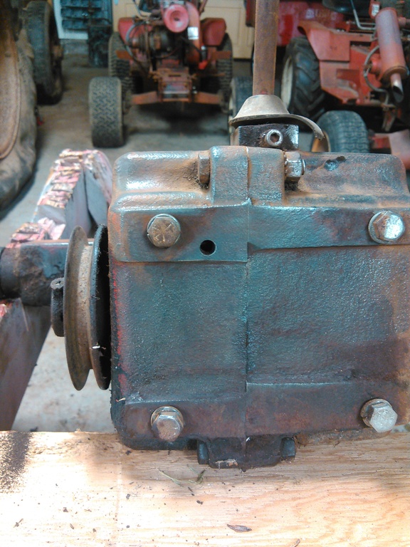

Mikey the Monkey 701 #1 Posted July 27, 2017 What's this hole on front of a 3 speed trans for? Share this post Link to post Share on other sites
WHX?? 57,887 #2 Posted July 27, 2017 (edited) That's for installing/removing the detent balls & spring for the shift rails. Supposed to be a welsh type plug in there. Covered by the frame but I just fill it with a dab of silicone just to keep dirt & water out. Get a decent boot for that shift lever too...goes a long way in keeping crap out. @wheelhorseman has them in the vendor section. Edited July 27, 2017 by WHX11 speeling 9 Share this post Link to post Share on other sites
