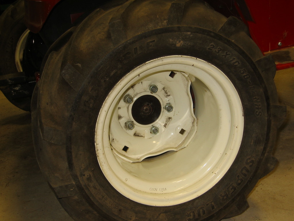

Your gonna need a wide rim to flatten out an ATV tire. Only a couple horses have wide rims, 520s and 1800 series, possibly some others. But cub cadet, John Deere, and sure there are others that use wide rims that share the same bolt pattern. Also look at Jacobson and toro turf mowers, some have 10"'rims. I picked up a set at a junkyard for $40.

Ah the one thing I forgot to mention. I have a set of 8" wide that came off a cub, when mounted on mine they are real close to the tank/seat bracket, like 1/4"'or so away. The 10" wide ones are on now and they fit like a stock wheel. Adjusting the backspace isn't hard, can move the wheel hub in/pit but only so much.
  • Like 2

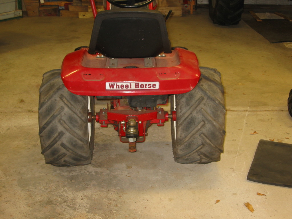

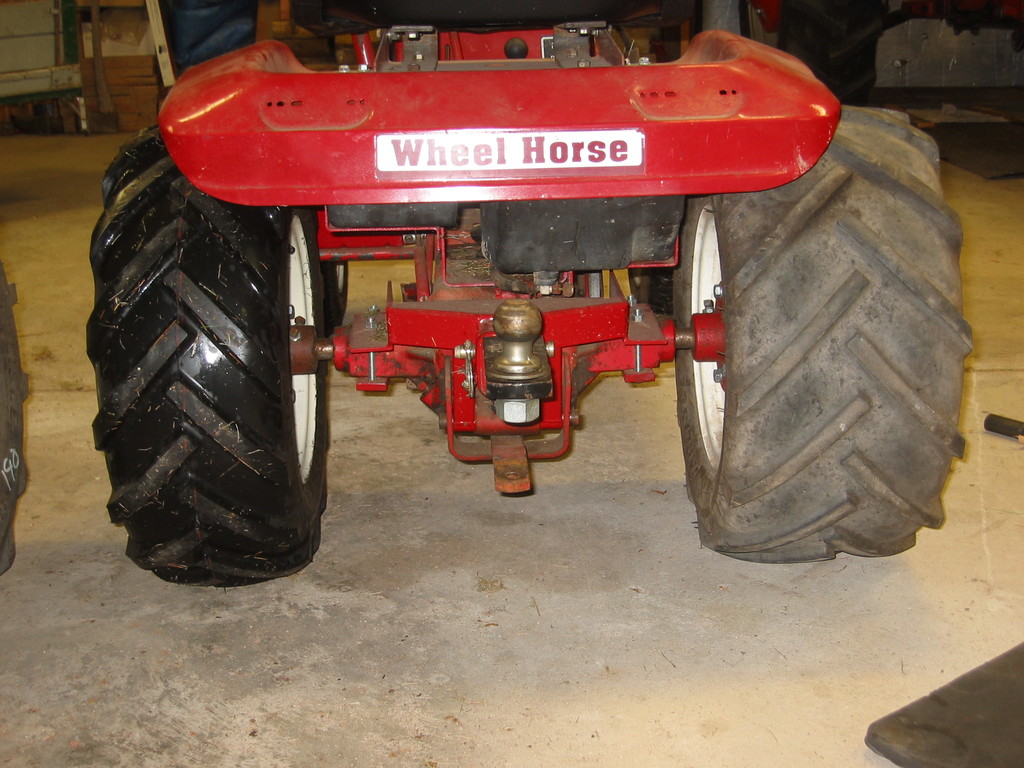

Remember your 312-8 has an open differential..so when you are in the mud one wheel will spin the other not move.  I put a limited slip in my 310-8 as i got tired of not being able to go up icy hills.  Note both tires are the same size marked on the sidewall Sizes vary by brand,  The smaller ones are deestones the larger Carlisle
  • Like 2
