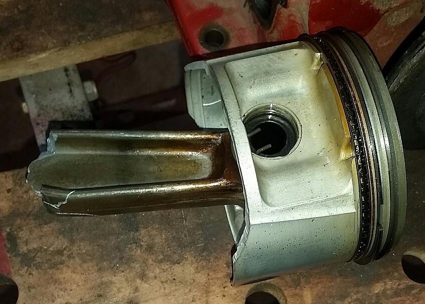

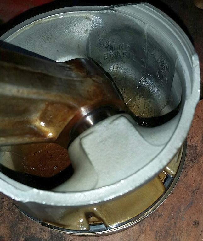

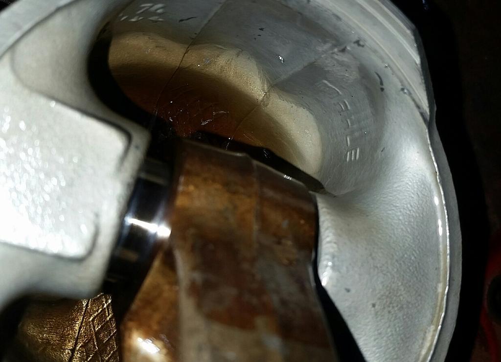

Texas Todd 1,026 #28 Posted September 6, 2017 Took some pics. The rod has no markings. The piston says Brasil and Mahle on the inside. Means not genuine Kohler to this seasoned investigator.... hah Not bad camera work for a smartphone, if I do say so myself! You can make out the .030 and there is a plus next to it. Brazilians type small! Thats about all the pics I could come up with. I am going to rely on my guy at the machine shop once I take it down next week. He is a knowledgeable fellow and at the end of the day, ya gotta have faith in somebody when you are as inept as I. 1 1 Share this post Link to post Share on other sites
Searcher60 209 #29 Posted September 7, 2017 That is a the over $200 Mahle piston. I think it lists for $240. It is listed as the "new style" in Kohler parts books. The rod is not the "new style" rod. Perhaps if you flip the rod over, is there is a number? The Kohler service manual is very clear about mixing THEIR rods and pistons between the old and new style. That rod sorta looks like it got hot. If that piston was used with the wrist pin that it came with, you would have added over 1 ounce to the weight versus the original piston and pin that a K-341 crankshaft was balanced for originally. The piston weight is ok, the wrist pin that it comes with is where the weight gain is. As for that eBay seller, my one experience with him was a total disaster. Ask him. I still have his e mails and the eBay e mails. Ask him if he gives refunds when he screws up, even after the wrong parts that he shipped are returned????? Share this post Link to post Share on other sites

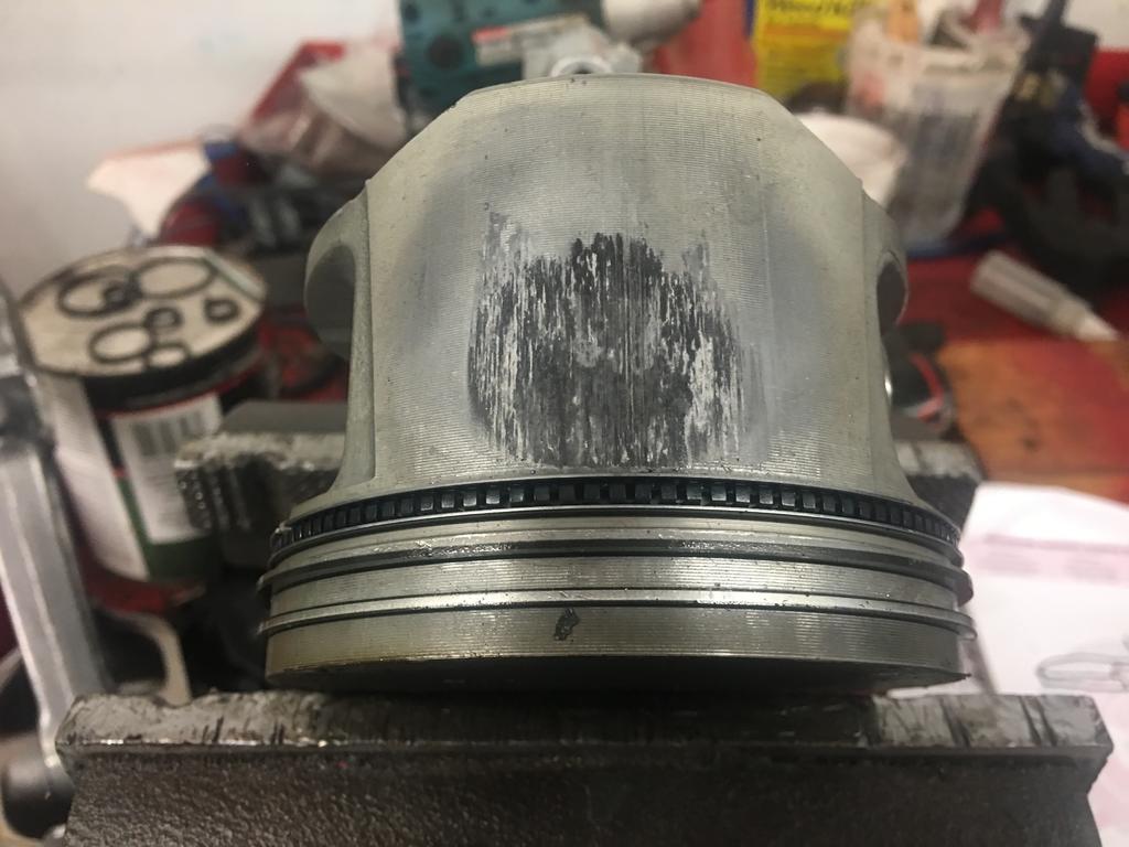

Searcher60 209 #40 Posted September 7, 2017 Yes, it's my hobby also. The last thing I need is a tractor, or the 3 that I have now. I cannot afford screw ups as I am retired and on fixed income. The picture below is what happens when a machine shop cannot follow simple instructions. I still have the tag with the piston clearance they wrote down and wired to the block. but did not bore too. They admitted not boring to right clearance when they checked after seizure. However, they balked at paying for the over $200 Kohler piston that was destroyed by their negligence. I use the current machine shop because about 15 years ago, the other machine shop in town screwed up a jug off my BMW R-90S engine. I consider this totally my fault because I knew better than to trust any machine shop, any where, anytime, from past experiences. I have been needing to buy a bore gauge for years to accurately check behind the machine shops. Now, I will not have anything else bored without first buying a bore gauge. People need to realize that this ain't the country it used to be. It's all about the cabbage. Nothing but thieves, crooks and liars. Share this post Link to post Share on other sites

wildman 205 #43 Posted September 7, 2017 6 hours ago, Searcher60 said: Yes, it's my hobby also. The last thing I need is a tractor, or the 3 that I have now. I cannot afford screw ups as I am retired and on fixed income. The picture below is what happens when a machine shop cannot follow simple instructions. I still have the tag with the piston clearance they wrote down and wired to the block. but did not bore too. They admitted not boring to right clearance when they checked after seizure. However, they balked at paying for the over $200 Kohler piston that was destroyed by their negligence. I use the current machine shop because about 15 years ago, the other machine shop in town screwed up a jug off my BMW R-90S engine. I consider this totally my fault because I knew better than to trust any machine shop, any where, anytime, from past experiences. I have been needing to buy a bore gauge for years to accurately check behind the machine shops. Now, I will not have anything else bored without first buying a bore gauge. People need to realize that this ain't the country it used to be. It's all about the cabbage. Nothing but thieves, crooks and liars. OUCH! Share this post Link to post Share on other sites
