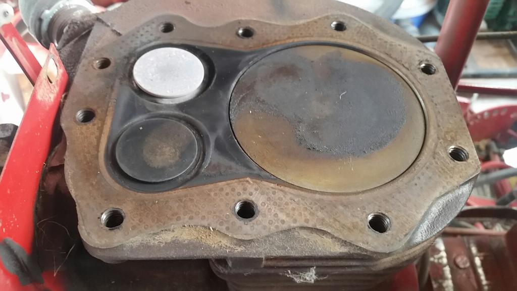

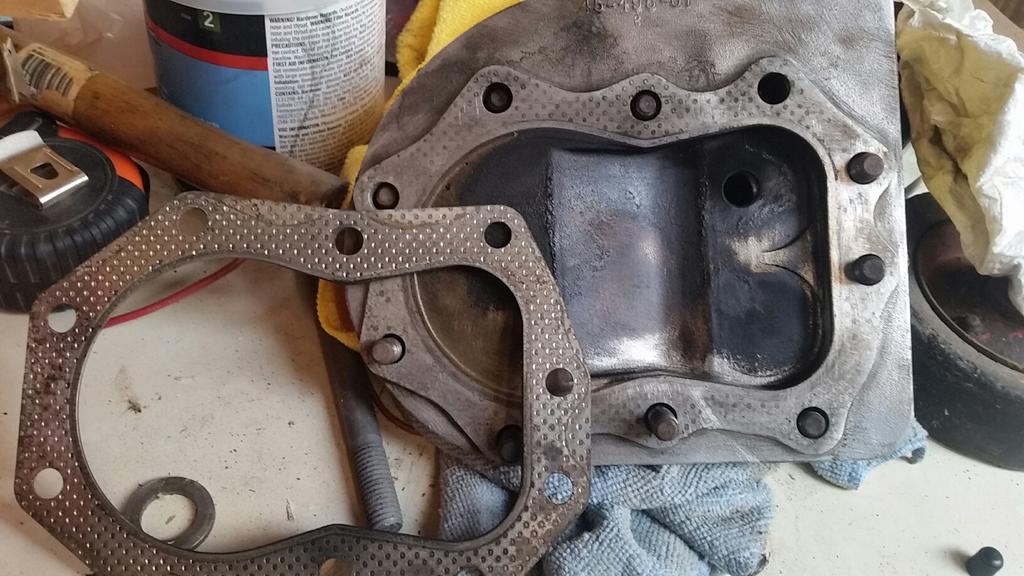

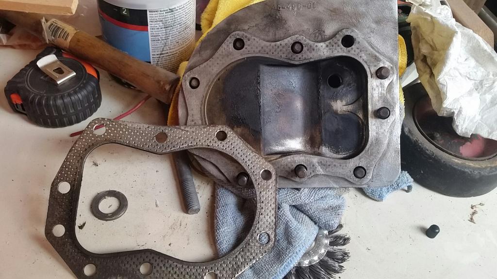

Texas Todd 1,026 #8 Posted September 3, 2017 Finally got around to tearing into this, this morning. Is the white exhaust valve normal? I took some pics of the head and gasket. Drained the oil. No metal stuck to a magnet as the oil drained. Turning by hand, Nothing out of the ordinary. I could hear the governor weights flapping and valves seemed to operate fine. I put a drill motor on the flywheel and spun it as fast as the drill motor would spin. Nothing out of the ordinary. Everything felt tight and working as it should. Don't have time to pull the engine and look inside today. Haven't checked the valves, but just wondering if anyone sees anything obvious. Pics of both sides of head gasket taken. Nothing looks obvious to me. Any clues before I pull the engine sometime this week? Thanks! Share this post Link to post Share on other sites
oldredrider 2,553 #9 Posted September 3, 2017 (edited) The white valve indicates too much heat. Three primary reasons for this condition: Timing too far advanced, lean carb mixture or poor air flow across the head or a combination. I would check the timing first. I would also do as recommended and check assembly of the breather. My guess is the excessive heat is actually causing the oil to vaporize and burn causing the white smoke. Until these suggestions are investigated, I see no need to tear into the bottom end. It's, in my opinion, a top end problem. P.S. check to make sure the spark plug is the correct heat range. Edited September 3, 2017 by oldredrider 1 1 Share this post Link to post Share on other sites

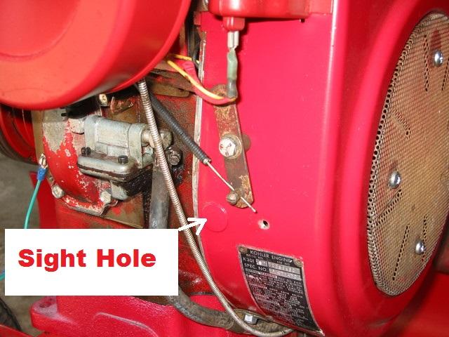

953 nut 66,588 #10 Posted September 3, 2017 (edited) On 7/16/2017 at 3:21 PM, Texas Todd said: did notice a knock. 22 minutes ago, oldredrider said: Timing too far advanced, Paul is right on the money here. The heat from timing too far advanced will over heat the combustion chamber and cause it to knock. I presume the cooling fins were clear of build up when you removed the tins. Here is a method for setting the timing. If your flywheel cover doesn't have a timing sight hole to view the mark from you will need to remove the cover. Kohler static_timing.pdf Edited September 3, 2017 by 953 nut Share this post Link to post Share on other sites
Searcher60 209 #11 Posted September 3, 2017 I would not tear this down yet. The valve may be white because you didn't leave enough clearance when you adjusted the valves. In other words, you mite have screwed up the valve adjustment and the exhaust valve clearance is to tight not allowing the valve itself to cool properly. Best thing is to do is a leak down test. But, you will have to buy a leak down tester at like Harbor Freight. Or, you could check and adjust the valves to the proper clearance and try it again. My money is on you screwed up the valve adjustment. You have to get the clearance right. Share this post Link to post Share on other sites

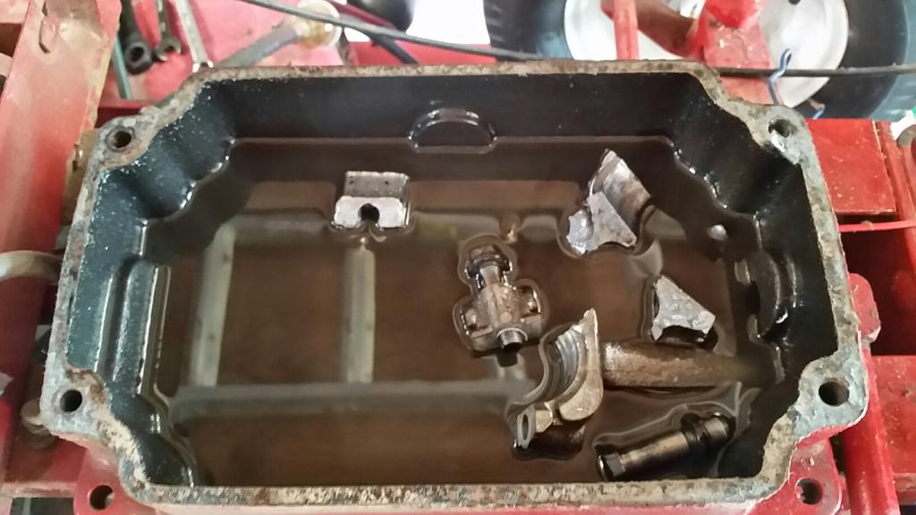

Texas Todd 1,026 #15 Posted September 4, 2017 Well I got er tore apart and the exhaust valve was well out of tolerance. Intake was right. Did the static timing routine and buttoned her all back up. Fired right off and ran pretty good. Was still getting some smoke out of the breather vent, but it seemed to be dissipating when I heard a gremlin leaving the engine...well at least I know what it sounds like when a connecting rod breaks loose. So I begin the re-tear down process and sure enough..... The worst part of it all is being told when I bought this that his dad bought it knew and never did anything but keep the oil changed...."never gave us a minute's trouble." and then I wire wheeled the piston face and saw the +.030. That's a real bummer......never a minute's trouble he says..... Think I will call it a day and not labor the rest of this labor day... 1 Share this post Link to post Share on other sites
