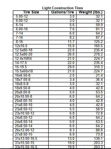

pfrederi 21,233 #2 Posted July 16, 2017 (edited) If you do it do not use calcium chloride it will eventually leak and destroy your rims. i have rim guard in my d200 26-12x12, about 80 lbs. Also do not over fill beet juice or what ever you use is not the best thing for your tire pressure gauge. http://www.rimguard.biz/wp-content/uploads/2014/04/Hydro-Flation-tables-2014-PDF.pdf Edited July 16, 2017 by pfrederi 4 Share this post Link to post Share on other sites

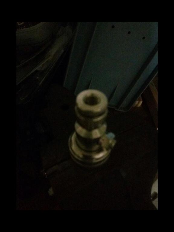

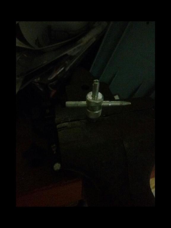

mmmmmdonuts 274 #10 Posted July 18, 2017 (edited) Just some images of the tools used. Valve removal tool. Adapter to pump fluid in. Garden hose fitting on one side, valve fitting on other. The small push button on the side is used to purge the air while filling. Edited July 18, 2017 by mmmmmdonuts 2 Share this post Link to post Share on other sites
