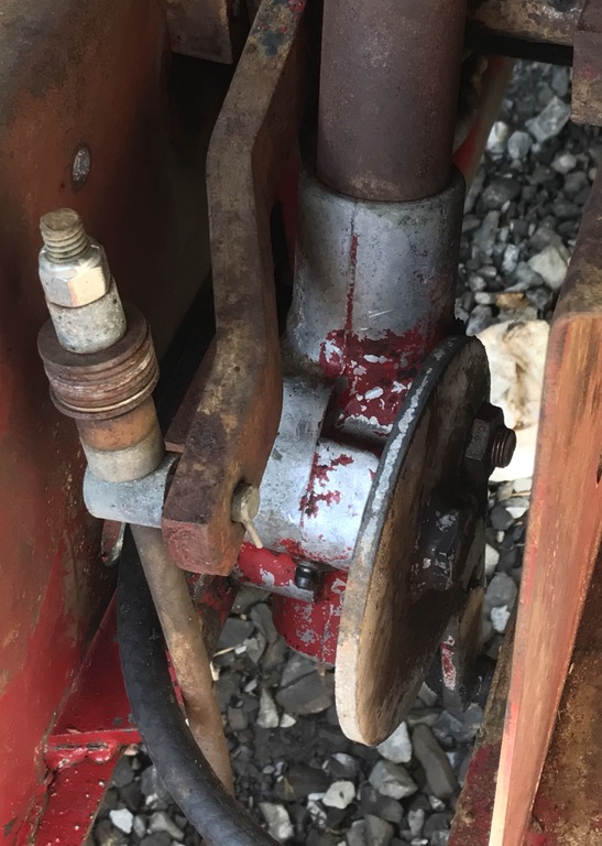

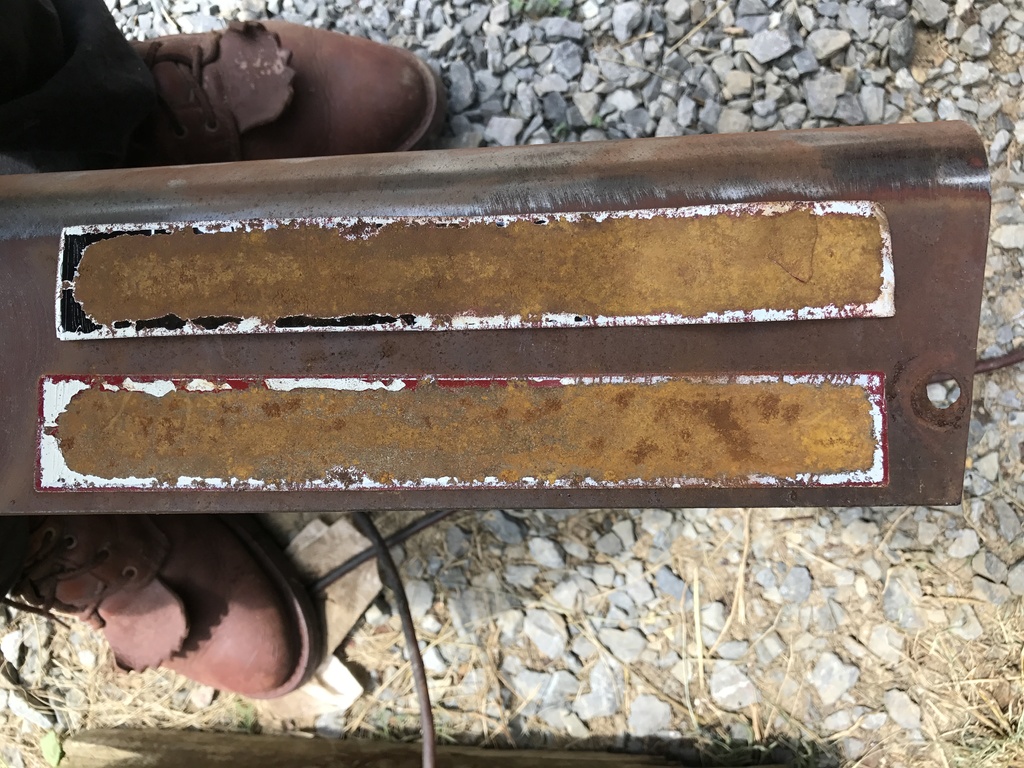

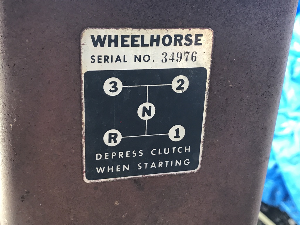

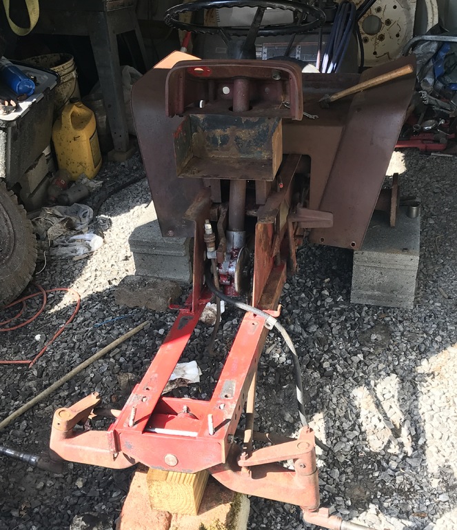

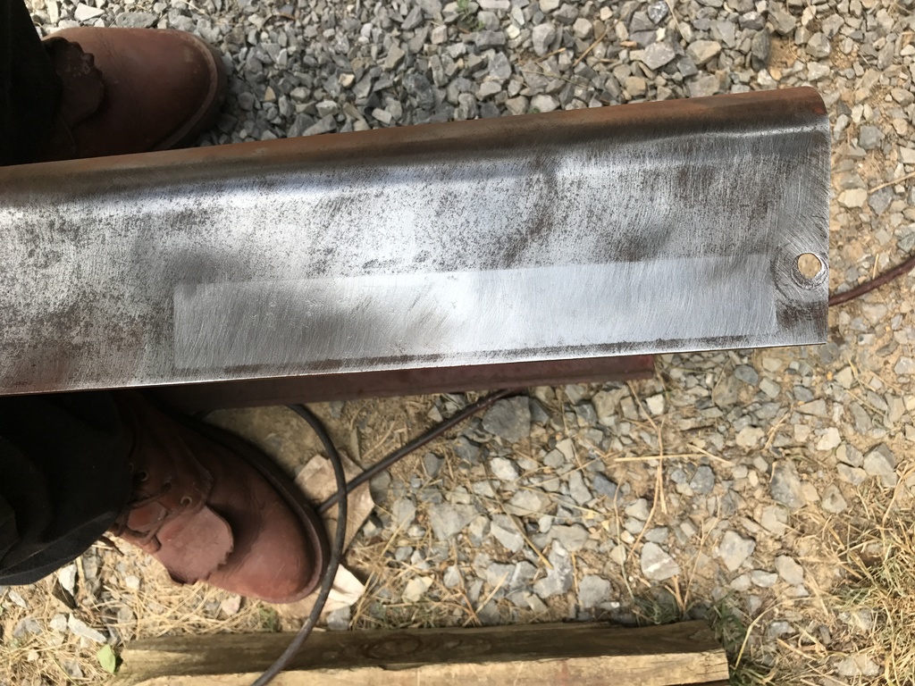

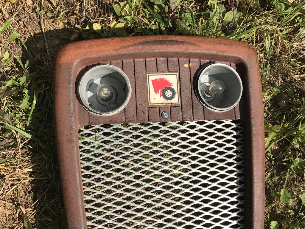

dells68 7,499 #1 Posted July 16, 2017 Richard wanted to know if I was going to start a thread on my 953 refresh, so blame him for my ramblings. I'm terrible at taking pictures, but here are a few. Please ignore the clutter around my shed - I'm a messy worker and a pack rat. A couple of questions. My 953 has the early steering box, but later headlights. How early is this machine? Seems to be maybe a crossover machine between the first thousand or so with early boxes and later 1963 machines. I've included the serial number if that helps. Also, when I took off the hood decals, it seemed like there was no paint under most of both decals. Did wheel horse scrimp that much on paint? One pic shows the decal just above the area it was moved from. Well, I'll post more pics s as I finish the refresh. I'm hoping to get it assembled to take to our annual tractor show this thurs-sat. Check it out at www.oldgladetractors.com. If you're near Southwest Virginia this week, come spend a few days with us! 16 Share this post Link to post Share on other sites

953 nut 59,735 #3 Posted July 16, 2017 5 hours ago, dells68 said: Richard wanted to know if I was going to start a thread on my 953 refresh, so blame him for my ramblings. 5 hours ago, dells68 said: How early is this machine? Seems to be maybe a crossover machine between the first thousand or so with early boxes and later 1963 machines. Yours and the one that @TravelinJavelin picked up both have the Ross steering and the later headlights and steering wheel, also both in the 3XXXX serial number range. The information @gwest_ca has on file shows that the first 1,000 or so had a serial number in the range of 62-00XXX and then the next group spans from 32508 to 36637, then it jumps to 41516 to 42111. Hope we can get a bit of feedback from others on this; seems to be another conundrum the Pond family left us to consider and debate. 8 Share this post Link to post Share on other sites
TravelinJavelin 620 #4 Posted July 16, 2017 I just compared serial #'s mine is a little earlier 34696........I know one thing, i'll be glad when my shifter is fixed 5 Share this post Link to post Share on other sites
dells68 7,499 #5 Posted July 16, 2017 Thanks guys! Seems like they used up every part they had before going on with the new model changes. Frugality seems to be the key to success. That's what has me wondering about the decals - seems like there never was any paint at all under them! 2 Share this post Link to post Share on other sites

steelman 252 #8 Posted July 16, 2017 Love the grill and headlights on that old girl. Look forward to seeing pics of the finished restore. 2 Share this post Link to post Share on other sites

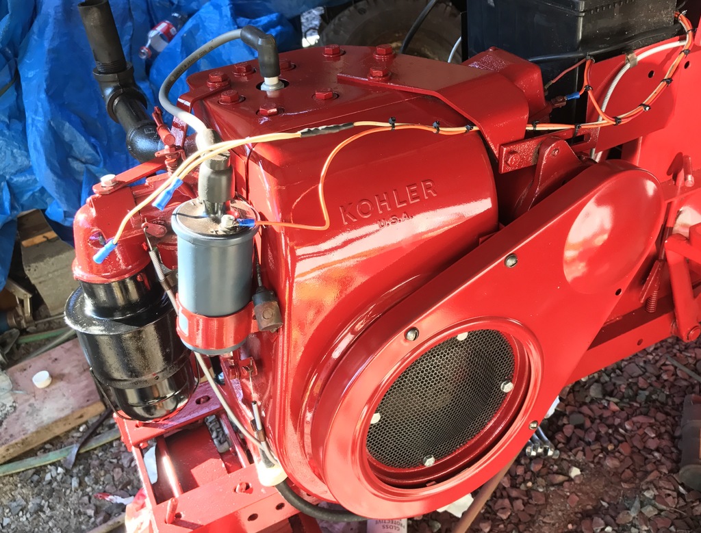

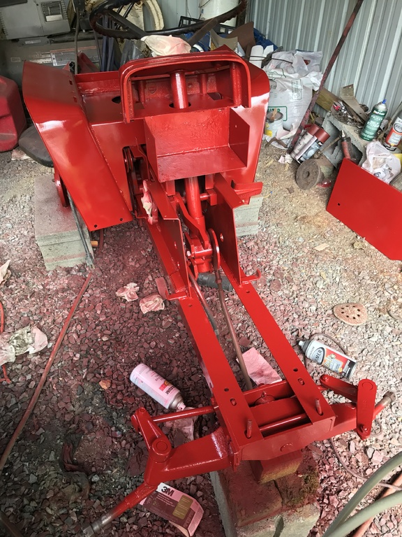

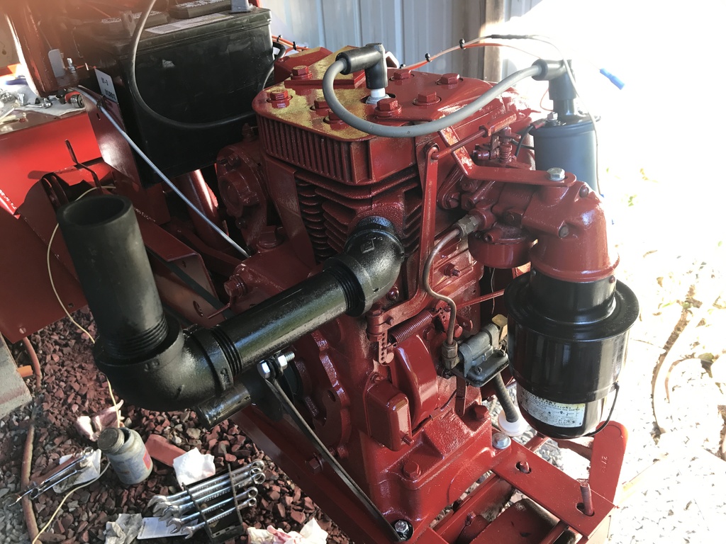

dells68 7,499 #10 Posted July 18, 2017 Got a little further today. I got the motor finished up, foot rests on, wheels primed and painted (well, fronts anyway - just primed the rears as I hope to get to mount the ags I ordered last week mounted), and the grille and hood mounted. Hope to have it finished by Wed. On 7/16/2017 at 10:58 AM, TravelinJavelin said: the big wheeled horse I've always I think had a thing for I do wish they made a gear version of GT-14 or i'd be having one of those too well i'd take one anyways if the price was right I've actually got 2 GT14s. One is all original and the other is powered by a 13.5 horse predator. Both transmissions are in great shape. Below is a picture of my wife riding the original GT14 and Emory beside her on his lawn ranger. 8 Share this post Link to post Share on other sites

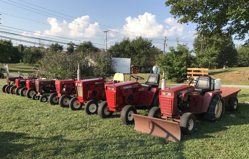

dells68 7,499 #15 Posted July 20, 2017 Well, I'm pooped, but I managed to get 8 horses to our annual tractor show today along with my 8N Ford. I got the 953 back together and running. Still need to get my ags put on the rear and make my seat covers, but she's sitting in the field ready for the show with her other stablemates! Below is a teaser pic of all 8 lined up. 953 is trying to hide in there too! More pics to come later. 11 1 Share this post Link to post Share on other sites

953 nut 59,735 #17 Posted July 20, 2017 Sharp Looking herd there. 2 Share this post Link to post Share on other sites
TravelinJavelin 620 #18 Posted July 20, 2017 beautiful collection.......the GT-14's even look beefy next to the 953......only if they were geared I would definitely have one! 1 Share this post Link to post Share on other sites

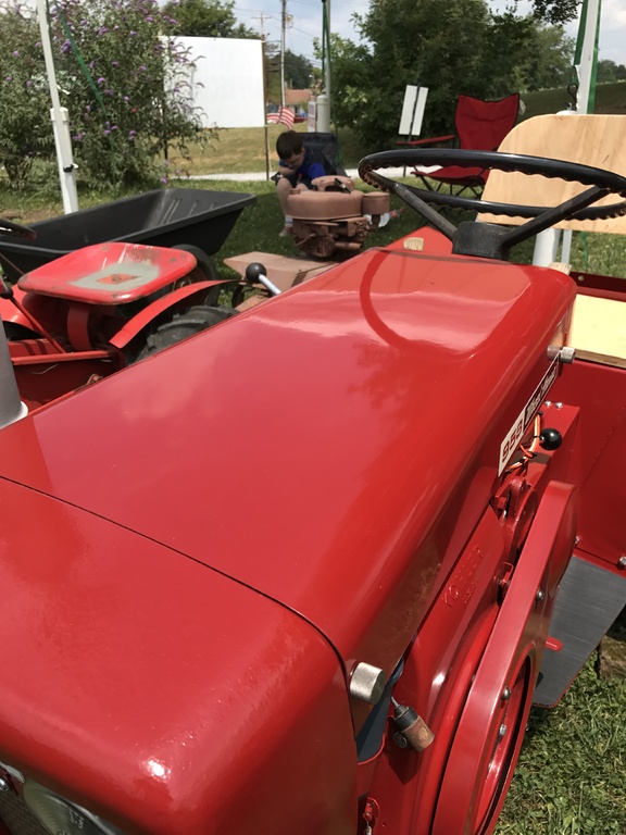

dells68 7,499 #21 Posted July 20, 2017 6 hours ago, Rob XC700 said: Nice collection. 953 turned out great. Paint question, since it was mentioned here. I'm new to this. Is there a standard "rattle can" that is a close match to the original colour, or do you have the paint mixed accordingly at a paint supplier? Has the colour always remained the same over the years, or did it change at different stages? Thanks! I have used Rustoleum regal red on our tractors. Seems to be the closest rattle can match. I think Farmall red is very comparable. The only trouble I've had with rattle cans is they are so dependent on the temp and humidity. I painted part of the 953 one morning with great results. Painted the hood another with more humidity and got a lot duller finish. Good thing is that you can cut and buff the rustoleum with good results if you are very careful. Attached is a pic of the 953 hood after a cut and buff job. You can see the reflection of the steering wheel and clouds. 5 1 Share this post Link to post Share on other sites
Rob XC700 75 #22 Posted July 20, 2017 Thanks for the paint info. That hood looks pretty good for a rattle can, and a cut and buff. Can't complain about that at all. 1 Share this post Link to post Share on other sites
ebinmaine 72,366 #23 Posted July 20, 2017 Nice looking paint job. Me and paint-on-metal aren't good friends.... A skill I need to acquire for sure. 3 Share this post Link to post Share on other sites
