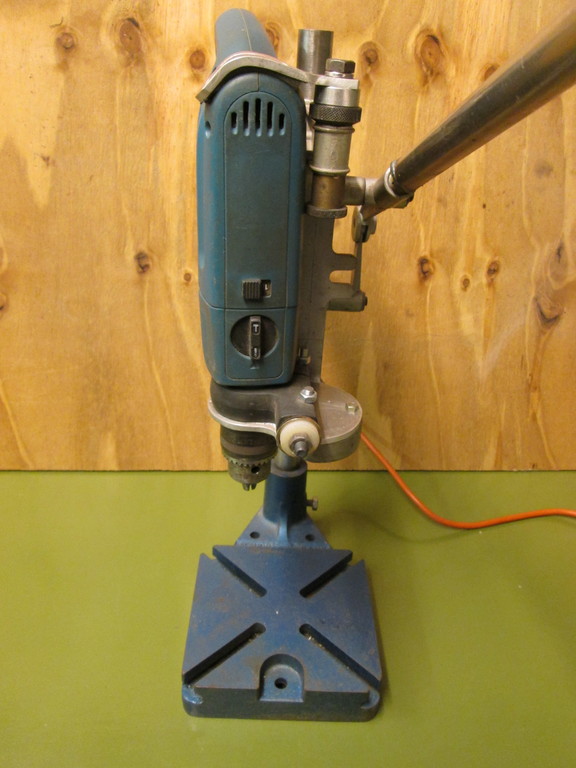

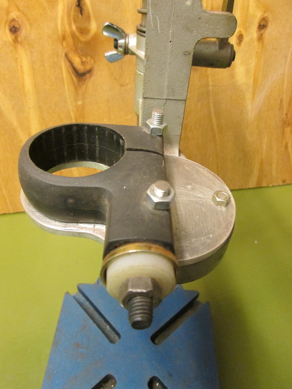

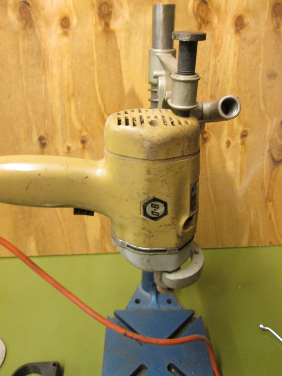

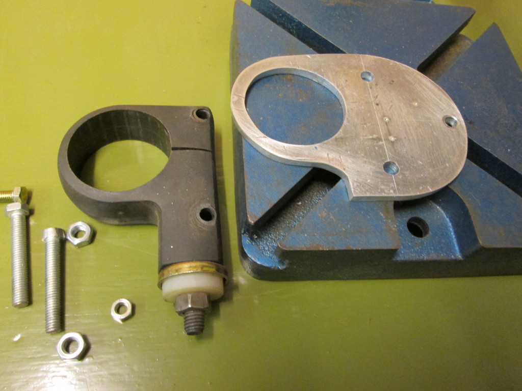

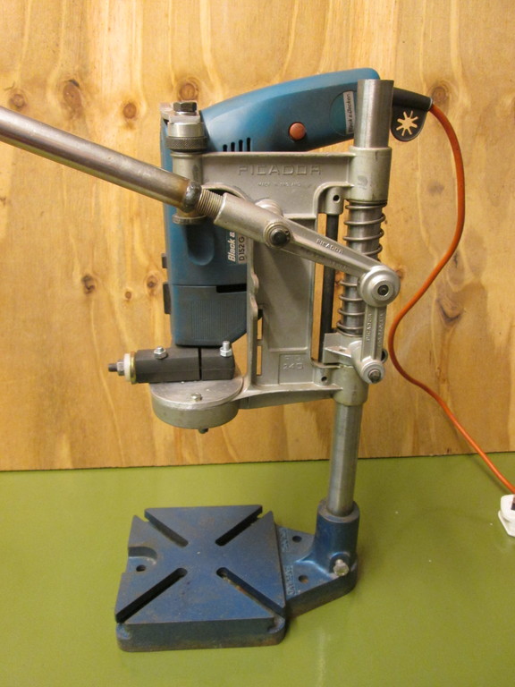

Alan R. 316 #19 Posted July 18, 2017 (edited) On 16/07/2017 at 10:57 PM, elcamino/wheelhorse said: @Alan R. How about sending some photos of your drill press . We colonists across the pond are always interested in tools and your drill press sounds like something I have never seen. Keep up the great work. Here you are Jim. My converted drill press. The first photo shows it fitted with the type of drill it was intended for. Low powered and with a 5/16" capacity chuck. The larger drill was too long to fit so an adapter was made which offset the drill to one side. The original top clamping bolt was reused, turned upside down with additional spacers and a bent metal clamp. By chance the lower end of this bolt, now the top, was internally threaded 3/8" UNF which made life easier. The black lower clamp was just part of the larger drills chuck end hand grip. Hope this makes sense. As mentioned earlier, although I managed to drill the axle and the adapter hubs the drill was too fast for the larger drill bits. The variable speed control didn't help much, nor did the slight side play on the slide assembly. Probably OK for drilling wood which these drill presses were mainly made for. Edited July 18, 2017 by Alan R. 4 Share this post Link to post Share on other sites
