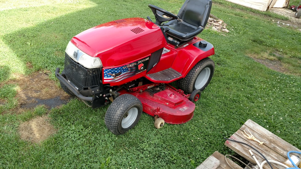

Texas Todd 1,026 #1 Posted July 2, 2017 Well I really like all the old classics, but kept reading about the newer models. An old friend of mine popped up with one with 600 hours so we made a deal. I like the heft of the machine. I like the 52" deck and the cruise control. It mowed my 1.5 acres much faster than my 316-8 with 48" deck. First thing I did was change the fluids and sharpen the blades. It cuts nice. Questions: The deck is quite loud. Is that normal or do perhaps I have a spindle in need of a bearing? After mowing for about 45 minutes I disengaged the pto. When I went to re-engage the pto it would not spin the belt. Waited about 10 minutes and it kicked into spin mode. (spindle bearing?) Gas gauge doesn't work. Is their a sending unit in the tank? Easy to replace or not worth the effort? Reverse Warning Light is always on. Gas tank is almost double the size of the classics. Does the 20hp twin burn twice the fuel? Front plastic piece is gone. Which from what I see is quite common. Anyone found a suitable replacement or just live with it? With only an hour of seat time, I'm not sure I am sold on it, but will give it a few more chances before sending it down the road. Thanks for any input. 5 Share this post Link to post Share on other sites

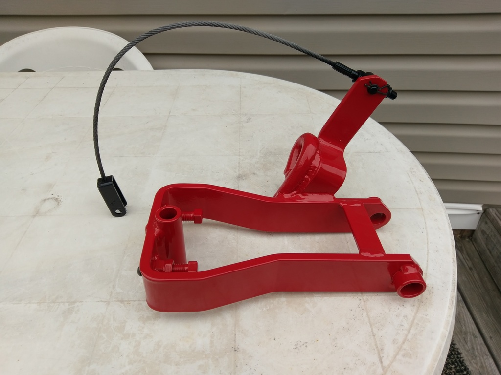

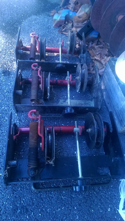

WVHillbilly520H 10,379 #8 Posted July 4, 2017 Toro still offers the front valance but it's $95 + from Partstree.com, and I have a refurbished like new sleeve hitch and extra mule drive available for the Xi's if you (or anyone else is interested give me a PM ) as all I have in the line now are 2 520H classics, Jeff. Share this post Link to post Share on other sites

WNYPCRepair 1,924 #10 Posted July 5, 2017 On 7/3/2017 at 9:45 AM, shallowwatersailor said: The deflector does lessen the noise somewhat, but I use muffs all the time now due to the tinnitus from not wearing them. Do you mean that the PTO would not re-engage? Sounds like a wiring issue. Check the contacts/connections and the fuse block as well. Gas gauge could be wiring as well. Depends on the year tractor. Does yours have the key switch in the seat frame? Its a big twin so uses more gas than a single. Previous owners seem to have a penchant for running into things. All three of mine have been cracked. Looks like a decent tractor, especially for 1-1/2 acres. Do you hear the PTO click, and it just doesn't turn, or is it not even clicking on? I bet someone rigged the reverse safety switch. The light is normally on after you turn the override key. If you can mow in reverse without doing anything first, then the override is on. Yeah, the bumper cover doesn't seem to last long. The headlight lenses seem to be an issue as well. Share this post Link to post Share on other sites

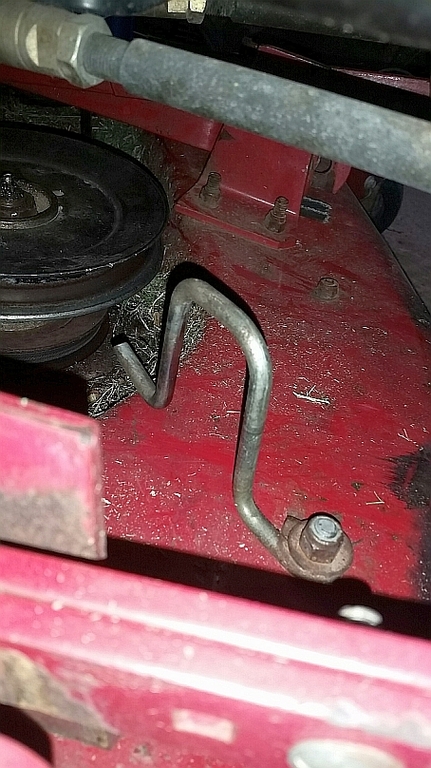

Texas Todd 1,026 #12 Posted July 8, 2017 Replaced all 6 bearings and "WoW" what a difference. Quiet as a church mouse! Mowed about 3/4 acre and then shredded the PTO belt. I may have had the guide in the wrong position. I read on here that removing the guide is one way to ensure it doesn't get in the way. Has anyone done this? If not a good idea, how should it be positioned? I bet @squonk knows the answer. I had it going more toward 12 o'clock in the picture but when the belt shredded it ended up in this position. I may have had the mule drive to tight, not sure. Ordered a B94 belt for 8 bucks on Vbeltsforless on the advice of another thread on this site. The OEM 95-4094 is $50 smackers.... Very pleased with the huge noise reduction and smooth action with new bearings. $50 for 6 bearings to my door from USA Bearings and Belts "Toro Wheel Horse 251-257 113514" Did learn that its just as easy to change the bearings leaving the housing attached to the deck. First came off with no problem. Second had one bolt I had to cut off (PITA). Left the third one on and removed the blade and pulley, popped out the bearings and spacer and reinstalled, E-Z Peazy.. 1 Share this post Link to post Share on other sites
