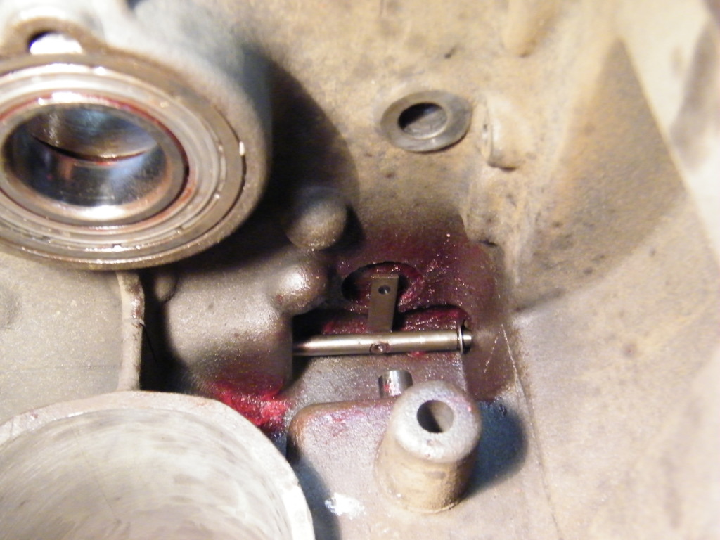

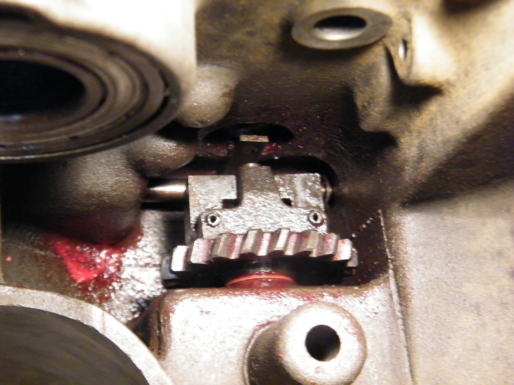

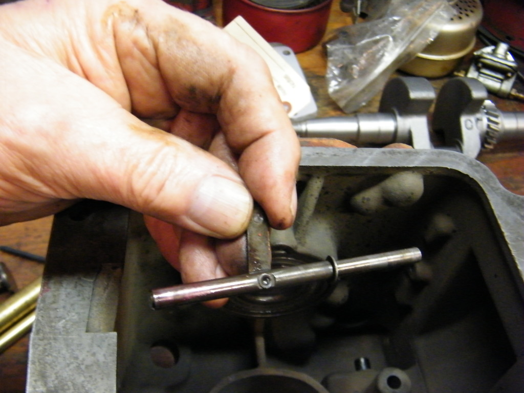

stevasaurus 23,708 #2 Posted June 30, 2017 I wonder if you didn't break off this flag. 2 Share this post Link to post Share on other sites
N3PUY 1,031 #3 Posted June 30, 2017 (edited) could have broken the lever off the governor shaft yeah ... like that Edited June 30, 2017 by N3PUY 1 Share this post Link to post Share on other sites
rmaynard 17,221 #4 Posted June 30, 2017 See if your shaft rotates more than 1/4 turn in either direction. If it does rotate completely around, you have broken the tab off, if not, you should be okay. 2 Share this post Link to post Share on other sites

stevasaurus 23,708 #6 Posted June 30, 2017 Chris @clueless, you are correct, but he said he had a problem screwing the brass nut back in on the 1st try. Maybe the shaft was not set back in the far hole, and the flag got caught on something. Can't think of anything else that would pop. Anyway, like Bob said, if he can't turn that shaft more then 1/4 turn, he may be OK. Share this post Link to post Share on other sites

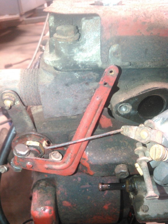

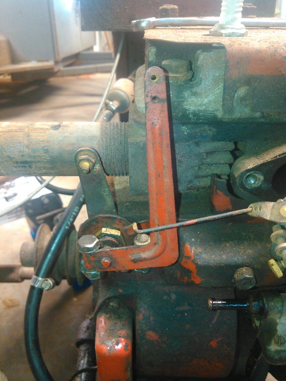

Mikey the Monkey 701 #8 Posted July 1, 2017 If the pictures uploaded that's how much it will go back and forth before it stops. There is a tiny bit of resistance as I move it with my finger. Any thoughts? Am I OK? Share this post Link to post Share on other sites
stevasaurus 23,708 #9 Posted July 1, 2017 I think you need to take the arm off the shaft and then see how far it turns. That linkage will stop the arm from rotating and you can't tell if the flag is broken or not. Share this post Link to post Share on other sites
Mikey the Monkey 701 #10 Posted July 1, 2017 It is off. Just hard to tell. Sincerely, mikeasaurus Sorry. The linkage is off, and it stops before the arm hits anytging 1 Share this post Link to post Share on other sites
stevasaurus 23,708 #11 Posted July 1, 2017 You should be OK then. You will know when you start it up for sure. Share this post Link to post Share on other sites
