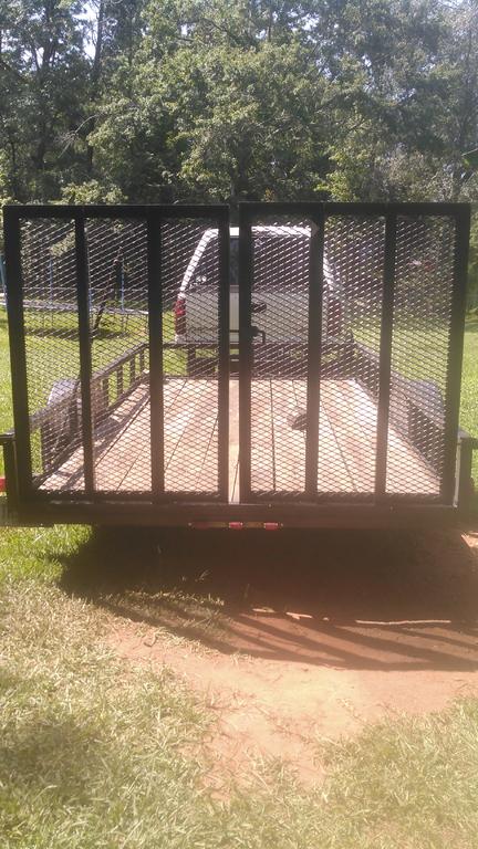

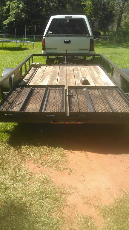

JPWH 6,544 #80 Posted August 20, 2017 After finally getting the new gates and latches in. I removed the damaged gates, latches and hinges loaded the new parts and delivered it to a trailer repair center. (Never again.) I had to remove the gates and hinges to rework them so they would work properly. This is one project I'm happy to have behind me. Delivered back to owner today. All damage repaired plus all new wheel bearings, replaced 2 marker lights, and 1 tail light. And upgraded hinges to greaseable bullet style and made the gates removable. 1 3 Share this post Link to post Share on other sites

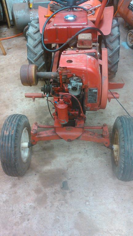

JPWH 6,544 #83 Posted September 3, 2017 I got one 854 drivable so the grandkids could ride. Carburetor was broke on one half of the mounting flange and the treads had pulled loose on the exhaust. 3 1 Share this post Link to post Share on other sites

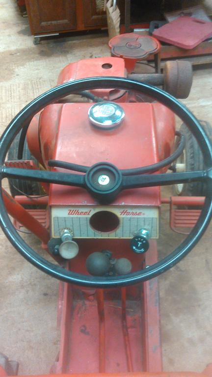

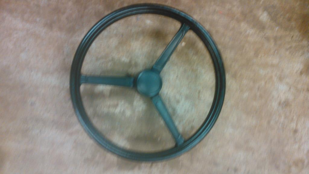

JPWH 6,544 #87 Posted February 11, 2018 My grandsons took the gas tank and front wheels off the 854 6 speed at Christmas. They got the tank back on then. Today I removed the steering wheel and shaft and reinstalled the steering shaft and and an original steering wheel. Put new bearings in the front wheels and installed a good carburetor. This is the steering wheel that came on it. 5 1 Share this post Link to post Share on other sites

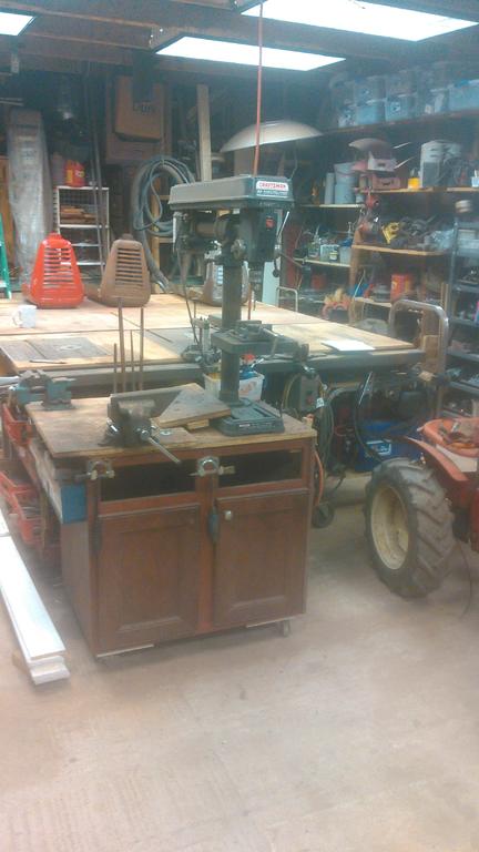

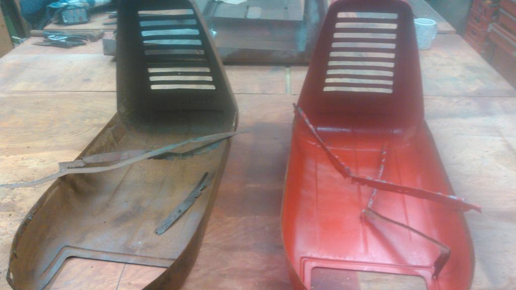

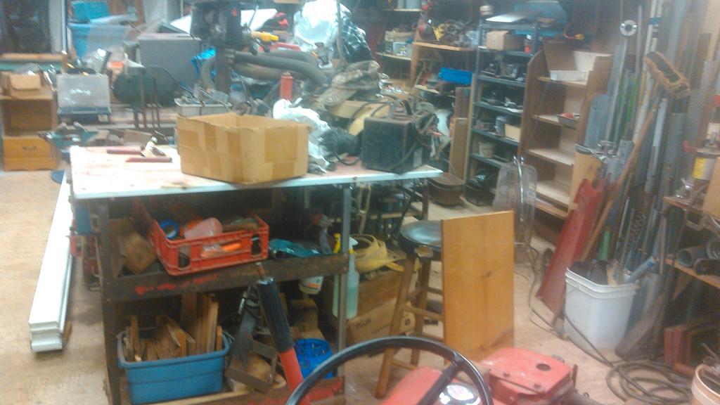

JPWH 6,544 #88 Posted March 6, 2018 I have earned a little more shop time after doing some honey do remodeling. After 2 weekends of rearranging and reorganizing my shop I have room to work again so I put the 854 hoods on the table and started by removing rusted out trim pieces. shop before After Hood trim removed. 3 5 Share this post Link to post Share on other sites

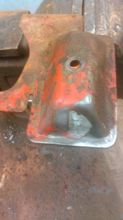

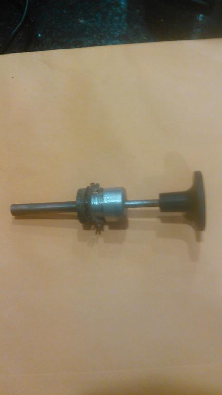

JPWH 6,544 #91 Posted March 8, 2018 Has anyone replaced the conduit and wire on a choke like this? I'm going to give it a try. Any advice before I do? Share this post Link to post Share on other sites
elcamino/wheelhorse 9,363 #92 Posted March 8, 2018 @JPWH Where did you put all of your stuff ? Magic shed or dump ? 1 Share this post Link to post Share on other sites
JPWH 6,544 #93 Posted March 8, 2018 1 minute ago, elcamino/wheelhorse said: @JPWH Where did you put all of your stuff ? Magic shed or dump ? 3 - 33 gal trash bags went to trash. Everything else is still there. 1 Share this post Link to post Share on other sites
953 nut 67,873 #94 Posted March 8, 2018 Haven't ever done that but here are some that may do the job. https://www.kaiserwillys.com/engraved-choke-cable-assembly-in-black-fits-46-66-cj-2a-3a-3b-5 https://www.kaiserwillys.com/engraved-throttle-cable-assembly-in-black-fits-46-66-cj-2a-3a-3b-5 1 Share this post Link to post Share on other sites
wallfish 20,335 #95 Posted March 8, 2018 (edited) 51 minutes ago, JPWH said: Has anyone replaced the conduit and wire on a choke like this? I'm going to give it a try. Any advice before I do? The conduit should screw into the holder. It's been a long while but I think you need to srew it in backwards. Meaning the conduit spiral must shrink and not expand as you turn it in. Attaching the wire to the knob is a pain because that metal is difficult to drill. I've gotten some drilled deep enough to hold the wire and I used crimpers to crimp the wire in. Doing communications for years means I have a bunch of different size crimpers. I've also ruined a few but they were already broken so what's the difference. Edited March 8, 2018 by wallfish 1 Share this post Link to post Share on other sites
JPWH 6,544 #96 Posted March 8, 2018 Thanks John. That's kind of what I figured to do. I have an old crimper that I think will work. I got the.old wire out of the knob by heating the end with the wire clamped in a vice then used a claw hammer like pulling a nail. Share this post Link to post Share on other sites
WHX?? 57,600 #97 Posted March 8, 2018 I might be missing something here Hank but that's the newer style choke that can be cheaply had yet? Just replace the whole thing? Pats small engine plus has them too. Guy that was selling at the BS had them too. Now if one can figure out how to put the older small knobs on the new style assemblies? Or is that what you are trying to do? Share this post Link to post Share on other sites
JPWH 6,544 #98 Posted March 8, 2018 @WHX14 I threw away a set of throttle and choke cables and went that route the first time around. Then I got the idea that maybe I could have saved them. If this works I will be looking for the older style to refurbish. I like the covered conduit so I bought a roll to replace the cables on the custom 12 and figured why not do the 854 and lawn ranger as well. I can do all three for the cost of one set. 1 Share this post Link to post Share on other sites
19richie66 17,930 #99 Posted March 8, 2018 5 hours ago, JPWH said: @WHX14 I threw away a set of throttle and choke cables and went that route the first time around. Then I got the idea that maybe I could have saved them. If this works I will be looking for the older style to refurbish. I like the covered conduit so I bought a roll to replace the cables on the custom 12 and figured why not do the 854 and lawn ranger as well. I can do all three for the cost of one set. I have the old cabkes off the gt14 you can have if they would work. 1 Share this post Link to post Share on other sites
JPWH 6,544 #100 Posted March 8, 2018 Thanks @19richie66i I don't need the cables just the parts in the picture. Share this post Link to post Share on other sites
