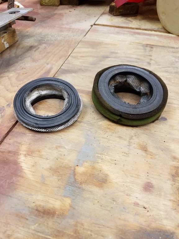

JPWH 6,544 #59 Posted July 30, 2017 I removed the hoods off of th 854s to see what the hidden damage might be. 1 gas tank, 1 air filter assembly, 2 air filters and 2 sets of hood thumb screws. The new to me tractor hood stand is twisted but I could not tell where without taking it apart. Share this post Link to post Share on other sites
Sarge 3,473 #60 Posted July 31, 2017 If those air cleaners got smashed that far - I'd bet the carburetors are cracked as well , maybe not...? It might be tough to figure out where the point of force stopped , I'd imaging the hood stands should be about the limit but might want to check the tunnel sheet metal as well . Heartbreaking to see these photos for sure .. Sarge 1 Share this post Link to post Share on other sites
JPWH 6,544 #61 Posted July 31, 2017 I was thinking the same thing on the carberators but it will be a while before I can find out for sure. Share this post Link to post Share on other sites

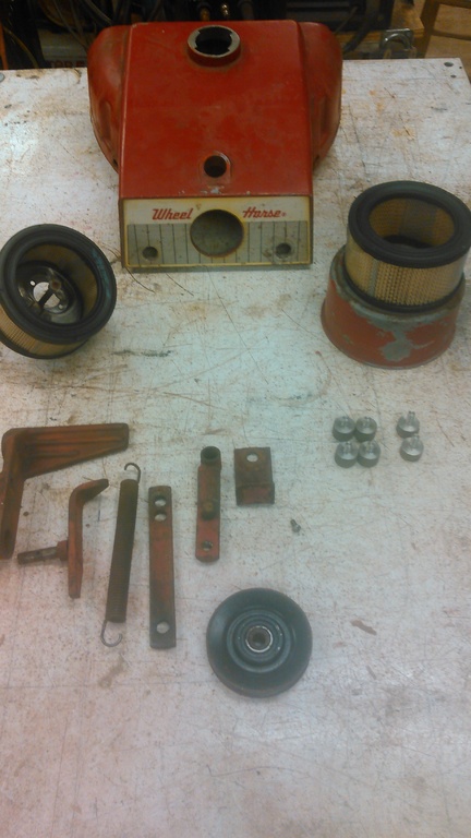

JPWH 6,544 #62 Posted August 7, 2017 I have had the hood for a while now but I got a box of parts today. 2 Share this post Link to post Share on other sites
19richie66 17,932 #63 Posted August 7, 2017 That's an LSE hood! It has the owner name tag on it glad it's all coming together for you Jay! 4 Share this post Link to post Share on other sites
953 nut 69,133 #64 Posted August 7, 2017 38 minutes ago, JPWH said: I have had the hood for a while now Is that the hood that @Bert found a few months ago? Share this post Link to post Share on other sites
JPWH 6,544 #65 Posted August 7, 2017 (edited) 10 minutes ago, 953 nut said: Is that the hood that @Bert found a few months ago? It is. I figured someone would remember it. @19richie66What is an LSE hood? Edited August 7, 2017 by JPWH Share this post Link to post Share on other sites
953 nut 69,133 #66 Posted August 7, 2017 14 minutes ago, JPWH said: What is an LSE hood? That is one of the new fancy ones we walk past while looking at our old stuff. 4 Share this post Link to post Share on other sites
JPWH 6,544 #67 Posted August 7, 2017 I may need to save it for someone who collects such items. Share this post Link to post Share on other sites
19richie66 17,932 #68 Posted August 8, 2017 Its a joke leaning on the 420LSE model they only made 200 of. They had tags riveted to the hoods that you could have the owners name engraved on. Yours has a tag riveted to it hence the lse comment. Oh well.... it was funny when I thought of it. 3 Share this post Link to post Share on other sites
JPWH 6,544 #69 Posted August 8, 2017 You had me worried for a minute I thought it was the wrong hood so I was trying to figure what was.different. You got me good. It was funny after Dick informed me what an LSE was. 2 Share this post Link to post Share on other sites

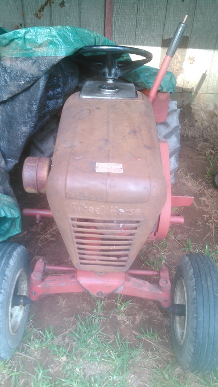

953 nut 69,133 #70 Posted August 8, 2017 1 hour ago, 19richie66 said: That's an LSE hood! It has the owner name tag on it glad it's all coming together for you Jay! Here is a picture of one from another thread. Brass plate is on the hood. 5 Share this post Link to post Share on other sites

SylvanLakeWH 32,457 #73 Posted August 8, 2017 15 hours ago, 953 nut said: Here is a picture of one from another thread. Brass plate is on the hood. That can't be an LSE...It has dirt on the tires...!!! 4 Share this post Link to post Share on other sites

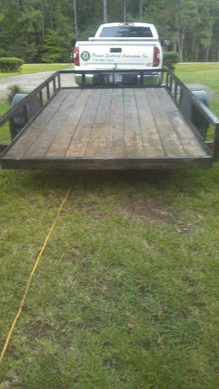

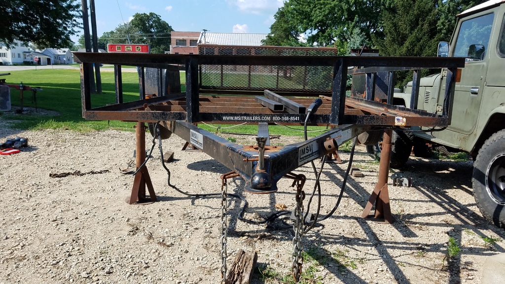

JPWH 6,544 #74 Posted August 10, 2017 (edited) The replacement gates, latches, and hinges came in yesterday. Now it is hooked up and ready to go to the trailer repair shop tomorrow. I have already cut off all the damaged parts except the rear cross frame. If this happens again it will be my own trailer to worry about. Edited August 10, 2017 by JPWH 5 Share this post Link to post Share on other sites

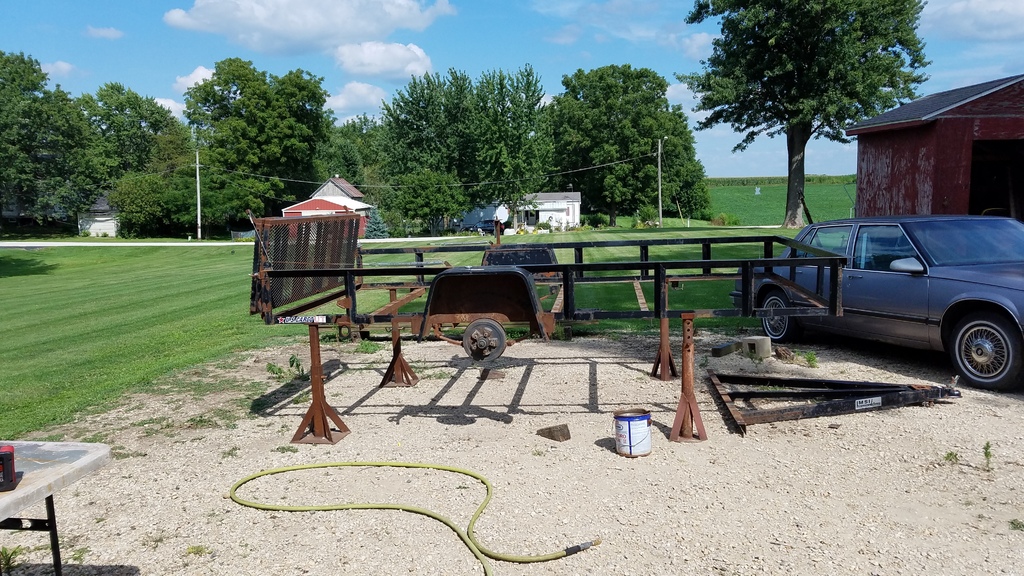

Sarge 3,473 #75 Posted August 10, 2017 I feel your pain - the damage to my utility trailer was from the tongue failing under a load and supported by the jack - I had intended to add a tie-in member to prevent this - didn't get the time to get it done . It basically just fell over , loaded and sitting on the jack the day I broke the engine coupling in the D when I tried to hook it to the truck . Pretty crap design and far too light of materials from the manufacturer . Pre-built a new one out of 2x3x3/16" rectangle box tubing - gotta weld that up today if it doesn't rain . The new tongue should stop the exaggerated flex in the front half of this trailer - the way they make them now is trusting too much in the engineers and not enough in quality of materials ....ugh . Might sell this one and go hunt down a 77"x14" utility with a 5,000lb rating instead of these lightweight junk 3,500lb models . Wish steel was a bit more fairly priced right now , I'd just use the new tongue to build a new , and much heavier unit . Sarge 3 Share this post Link to post Share on other sites
