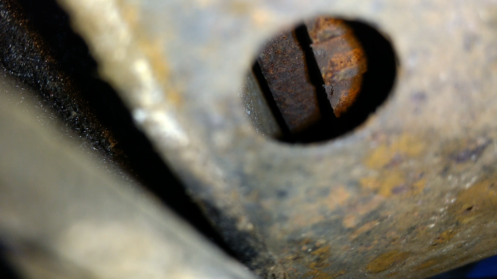

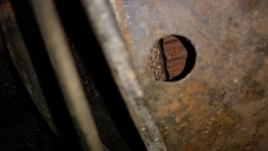

I looked through the hole at the fly wheel but the edge of it was too rusty to find any marks whilst I turned it slowly.

I just tried getting rid of the rust on the flywheel so I could see the marks on it but couldn't find anything, is this good enough to be able to see the marks?
Tim.0
use a bright flashlight and go slow I would think you would be able to see it. Unless it was stamped that bad. I found mine and it had more rust on it than that, then maybe it was just stamped better. use your hand so you know your on the compression stroke and it might help narrow it down some.
The rust may be in the stamp yet you might find the stamp by the outline.
