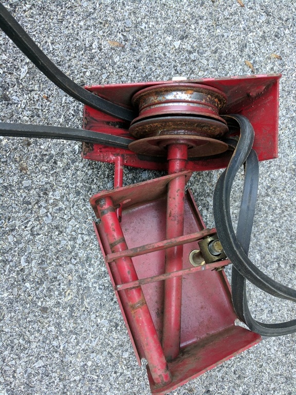

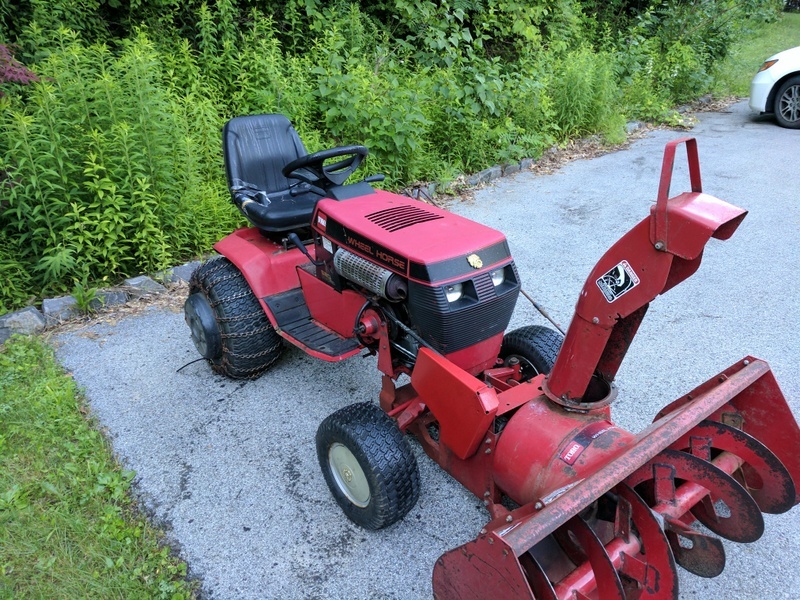

toddr 19 #1 Posted June 22, 2017 I just picked up my first Wheel Horse, a 1996 or 97 520H with 356 hours. It runs great, but looks like it was stored outside from the surface rust I'm going to need to work on. It came with the 2 stage snowblower, but no mower deck. I'm really looking forward to using the snowblower on my 500 ft driveway come winter. In the mean time, I want to set it up for mowing, so I'm looking for a 42 or 48 inch deck. This brings up my question on the mule drive, from the picture can anyone tell if this is the drive for the 60 inch deck or will I be able to use it with the smaller one I want? Oh, lurking on this forum already cost me $250. After seeing it, there is no way I can live without the pedal mod. Thanks in advance for the help 7 Share this post Link to post Share on other sites
TDF5G 2,074 #2 Posted June 22, 2017 Your horse looks mighty fine. That's very low hours. The 22 stage snow thrower ought to do the job on your long driveway. I can't answer your question on the pulley support box, I have no experience with the 60" deck, but it looks like the ones I have for the 36" and 42" decks. You will need the correct length belt to correspond with the deck. 1 Share this post Link to post Share on other sites
1995 520H+96+97 939 #3 Posted June 22, 2017 That mule drive will also work for the 48" deck. 2 Share this post Link to post Share on other sites

cleat 9,324 #12 Posted June 24, 2017 That mule is for a 42 or 48" deck. You can not mount a 42" side discharge deck to that machine as it will hit the rear tires (trust me, I tried). However, a 48" deck will work perfect. You can also fit the monster 60" deck on your 520. 1 Share this post Link to post Share on other sites

cleat 9,324 #14 Posted June 24, 2017 The rear wheels on the deck hit the rear wheels of the tractor. Other models of Wheel Horse and also the older 520 used smaller 23 x 9.5-12 tires. Your 520 uses 23 x 10.5-12 rear tires. They are just wide enough to rub the rear wheels of the deck. 48" deck is wider so the tires clear. 42" rear discharge deck fits I believe but have never tried. 3 Share this post Link to post Share on other sites

stratostar250 934 #19 Posted June 25, 2017 (edited) 3 hours ago, AMC RULES said: Well yeah... how much does that 60" deck weigh? about 315 lbs. its not fun trying to put it on, but it does mow like no one elses business. but yes, you have the correct mule drive. the one for the 60" deck has a goofy spring on it which no others do. Edited June 25, 2017 by stratostar250 4 Share this post Link to post Share on other sites
