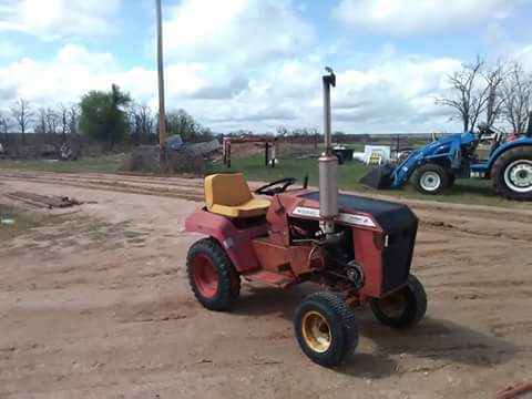

ClassicTractorProfessor 5,455 #9 Posted June 10, 2017 Here's mine 1 Share this post Link to post Share on other sites
