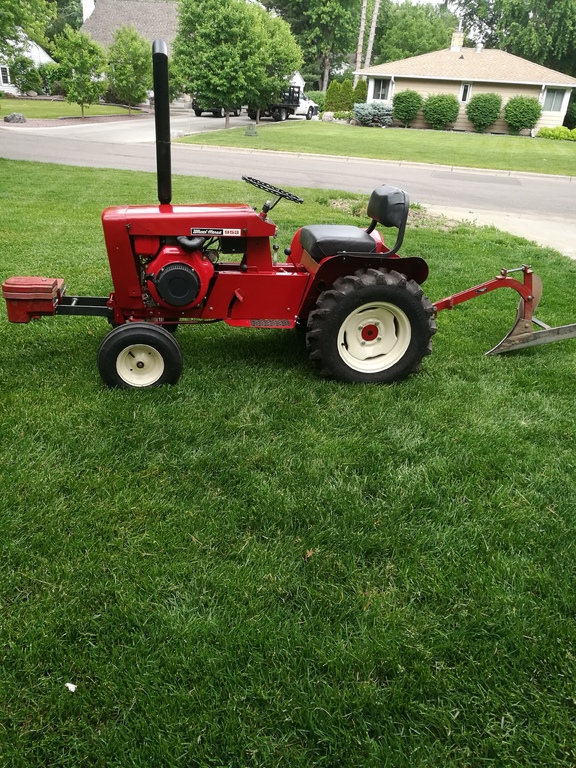

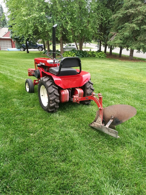

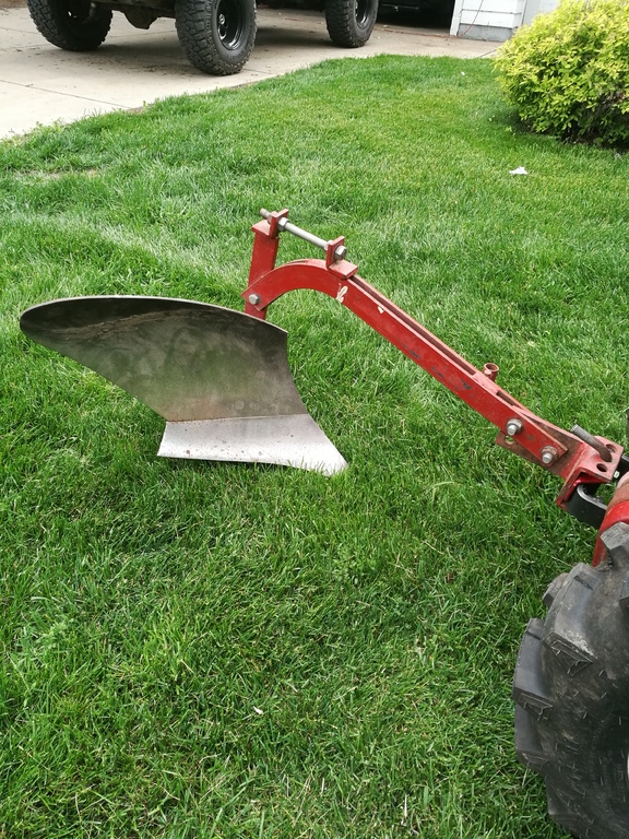

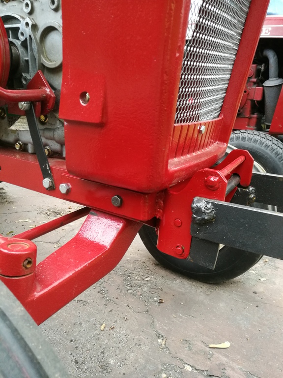

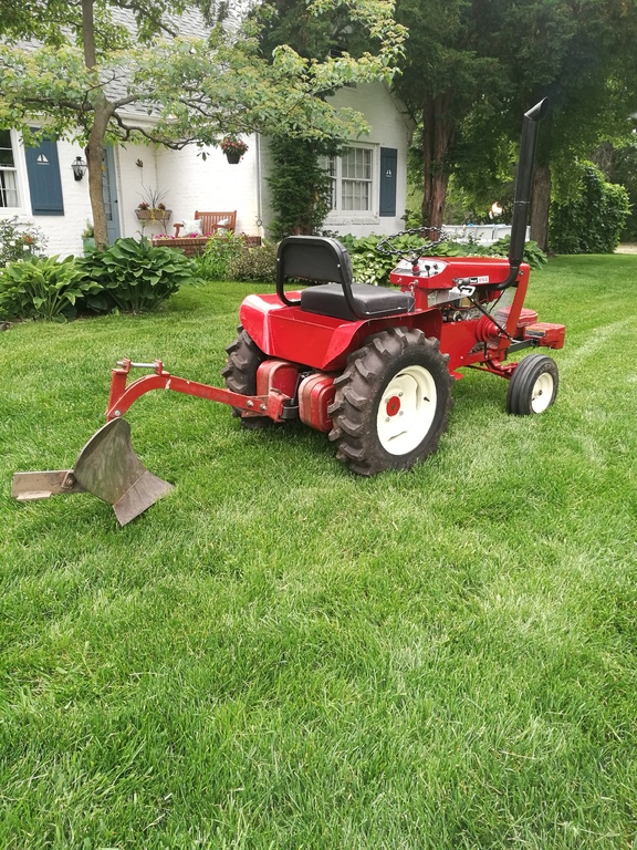

JamesC-120 204 #1 Posted June 8, 2017 Working on building the 953 Diesel into a beastly plow tractor. I just made a few brackets for some weights in the front and rear. I also picked up a Wheel Horse 12" plow. It was in excellent condition and I thought a great price for a 12". Now I'm looking into converting to a 5/8" belt because pulling a 10" with no weight it was eating up the stock 1/2" belt. Anybody that wants to give me any tips on the belt conversion or anything I should add let me know. 15 2 Share this post Link to post Share on other sites

953 nut 67,519 #3 Posted June 8, 2017 That is quit nice. I would think you will need to have one machined to fit your needs, the "3L" for the hydraulic lift pump and a 5/8 for the drive is not a stock configuration. Chances are you will need to space the belt guard out a little too. Another option would be a "2B" pulley for the engine and a "B" belt to the pump, but that would move the belt guard out a bunch. 5 Share this post Link to post Share on other sites
JamesC-120 204 #4 Posted June 8, 2017 There is plenty of room for a wider belt and pulley. The belt shroud sits out pretty far. So I'm thinking of buying the two pulleys I need then cutting and welding them how I need them. Just have a little more measuring to do before I order the pulleys. 2 Share this post Link to post Share on other sites

artfull dodger 441 #7 Posted June 8, 2017 Looks good, hope you put a brace on that tall stack! The cast alum block isnt gonna like all that weight hung off of the exhaust manifold area! Cant wait to see video of it rolling coal pulling that plow. Mike 2 Share this post Link to post Share on other sites
