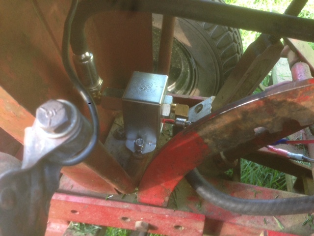

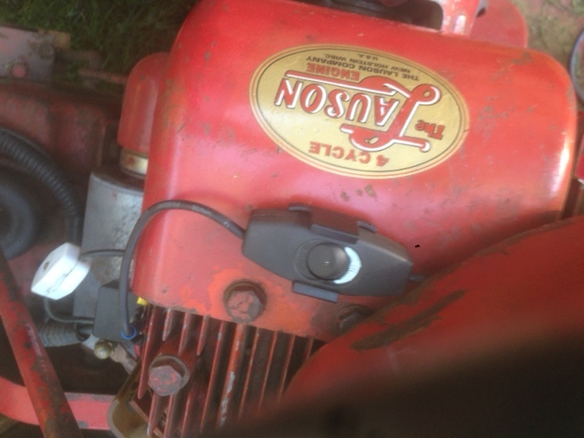

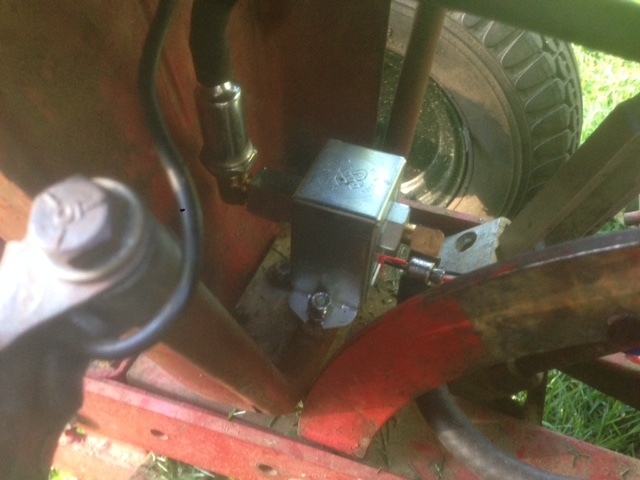

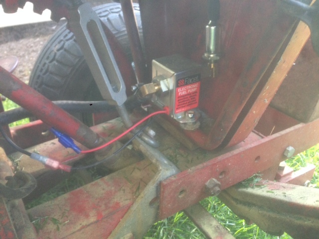

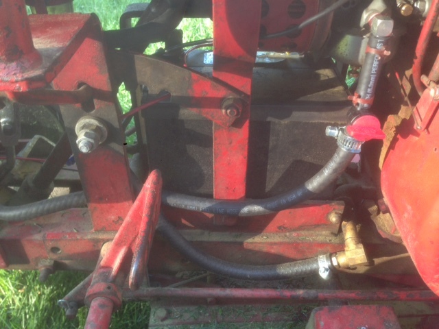

formariz 12,381 #1 Posted June 2, 2017 Decided to install a fuel pump on the old girl. Typical for these tractors once tank is at about half they start getting fuel starvation unless they are on level ground which I don't have much. Now she goes until the last drop. Noticeably works better also since there is constant fuel pressure. Like everything else on her, pump is switched by a ground. 11 Share this post Link to post Share on other sites
Retired Wrencher 7,037 #2 Posted June 2, 2017 formariz Good job that will work. Enjoy the ride! Share this post Link to post Share on other sites
