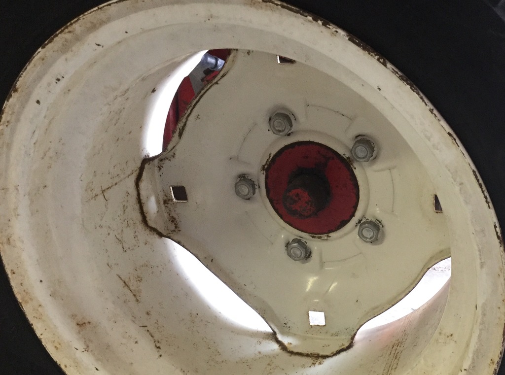

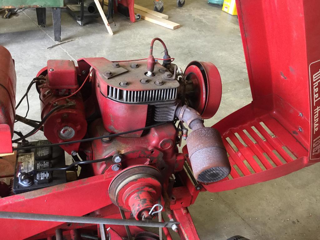

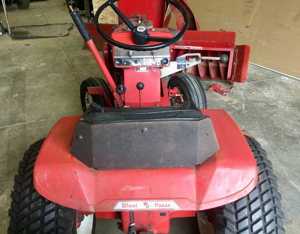

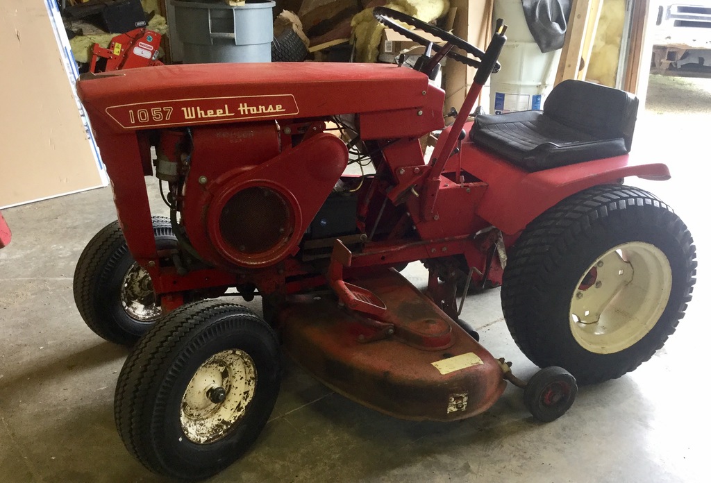

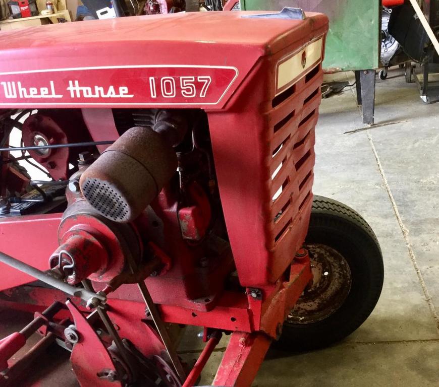

ACman 7,761 #1 Posted May 20, 2017 (edited) This was his uncles tractor (only other owner) and he wouldn't budge much on price. All original paint but I do have a couple concerns. Rear wheel hubs are pushed in on both wheels and the front grill has a dent (but I know really good old timer body guy) , runs on full choke . I think she'll polish up real nice though...she deserves it after 50yrs of faithful service . You can definitely tell the previous owner took very good care of her . So what you guys think ? @elcamino/wheelhorse here some pics of my sons beater . Plan on brushing on a used oil finish , Removable bedsides and tailgate . Edited May 20, 2017 by ACman 8 Share this post Link to post Share on other sites
Racinbob 13,286 #2 Posted May 20, 2017 That looks great. No worries about the hubs. That happens. Just move them back out and snug them up. Maybe add a second set screw. It kinda looks to me like the rear seals are leaking and they kept the oil wiped off. The carb probably just needs a good going over and I think a good body man can straighten the grill out nicely. Definitely a very well cared for machine. 3 Share this post Link to post Share on other sites
elcamino/wheelhorse 9,363 #3 Posted May 20, 2017 That is a nice looking tractor , like you said it could use a little TLC. I like the truck , looks like road salt is gave a great time eating the metal on the cab. You would think after eating all the bed off the truck it would leave the cab alone. A stake body comes in hand, you can always haul more than a pickup. Thanks for the picture. 2 Share this post Link to post Share on other sites
953 nut 70,340 #4 Posted May 20, 2017 3 hours ago, ACman said: runs on full choke . As Bob said, the carb. is due for a cleaning. I would replace the fuel line and filter while you are at it. 2 Share this post Link to post Share on other sites
