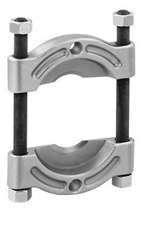

pfrederi 19,279 #2 Posted May 14, 2017 (edited) Bearing /Flange Puller??? Heat the pulley if you go that way. Try standing engine so pulley faces up. Hit it with Kroil and wait a day.... Edited May 14, 2017 by pfrederi 13 Share this post Link to post Share on other sites

Morecowbell 23 #4 Posted May 14, 2017 Thanks Paul - haven't seen one of those before, looks like a good option. Thanks Dan - I'm not in a big rush so will try a little more soaking and patience. Seems like you and I are destined to meet! Share this post Link to post Share on other sites
pfrederi 19,279 #5 Posted May 14, 2017 Some Auto parts stores rent / loan out things like that. I am more of the Norm Abrams school. He says a wood worker can never have to o many clamps. I feel you can never have too many pullers. 10 Share this post Link to post Share on other sites

JAinVA 4,638 #9 Posted May 14, 2017 As stated the bearing flange puller is the trick.You can find them at Harbor Freight for cheap.Jaw puller will destroy the pulley if you re not real careful.JAinVA 5 Share this post Link to post Share on other sites
