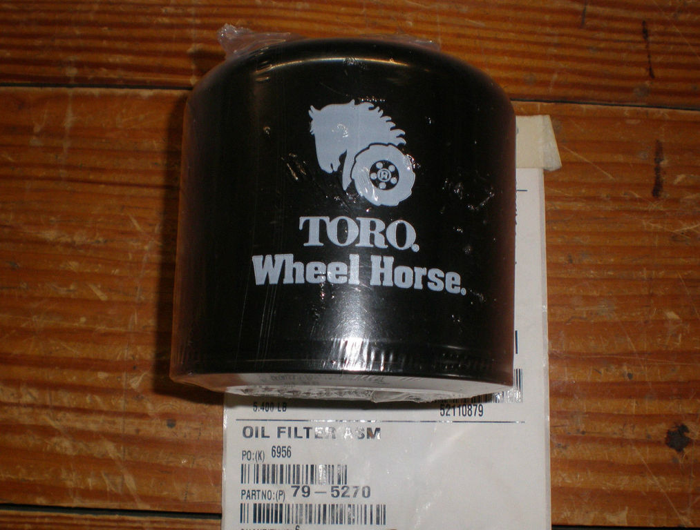

daveoman1966 3,884 #18 Posted May 15, 2017 why buy anything OTHER than an OEM filter.... here it is. available on ebay lots of places... 79-5270 is the toro filter....for hydros. 3 Share this post Link to post Share on other sites
skippy1969 135 #19 Posted May 15, 2017 2 hours ago, daveoman1966 said: why buy anything OTHER than an OEM filter.... here it is. available on ebay lots of places... 79-5270 is the toro filter....for hydros. Why buy anything but a WH filter. Hmmmm let's see. $18.99 compared to $3.99. For one. And I live 3 minutes from the store I bought the Purolator at. And I needed it now not a week from now,LOL! Share this post Link to post Share on other sites
pfrederi 21,095 #20 Posted May 15, 2017 You have to wonder about the quality of a $3.99 filter. Purolator has 4 different numbers for "replacements" for 5990 (so you have to wonder other than size, gasket diameter, and thread size what they look at for "replaceability"). All have anti-drain back valves...which is irrelevant in a hydro system with the filter on the return line. They also have bypass valves. Not what you want in a hydro. if the filter is getting clogged you don't want it to open up and allow more crud to circulate better you system lose power and thus warn you of a problem. 3 Share this post Link to post Share on other sites
clueless 3,437 #21 Posted May 15, 2017 48 minutes ago, pfrederi said: You have to wonder about the quality of a $3.99 filter. Purolator has 4 different numbers for "replacements" for 5990 (so you have to wonder other than size, gasket diameter, and thread size what they look at for "replaceability"). All have anti-drain back valves...which is irrelevant in a hydro system with the filter on the return line. They also have bypass valves. Not what you want in a hydro. if the filter is getting clogged you don't want it to open up and allow more crud to circulate better you system lose power and thus warn you of a problem. Once the push valve is working and it seems to help, you need to change the fluid again, needs to be close to what ever color fluid your using. Then sometime down the road buy the Toro OEM filter (save up). You said the filter that came on it looks like the original, that's 40+ years of uses and neglect, try that with your $4.00 purolator. 1 Share this post Link to post Share on other sites
