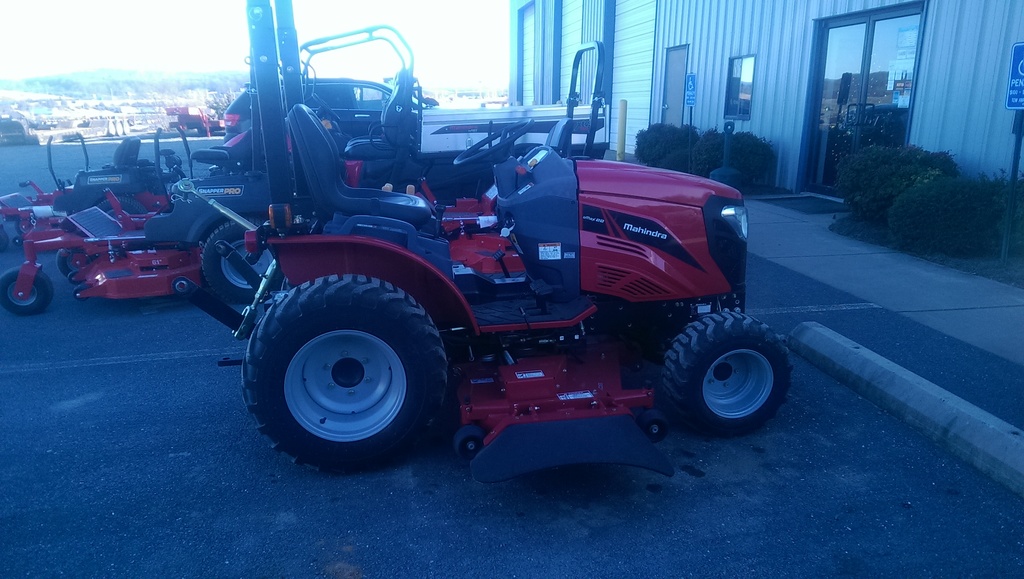

WVHillbilly520H 10,378 #27 Posted May 12, 2017 4 hours ago, Sarge said: On the slopes pictured previously , that would take some serious wheel weights to prevent wheel slip and a good open mole hole could also tip over a tractor easily - you need the lowest center of gravity possible for stuff like that , up and down or across the slope . Even the smaller SCUT tractors will still have a fairly high center - that could result in a bad day . Sarge I have 5 gals +/- fluid plus 75# weights on AG tires with the Onan powered520H, as for my eMax is actually quite wide and low one of the biggest reasons I bought it here's a shot comparing it to an xi series with the 60" cut deck , Jeff. 2 Share this post Link to post Share on other sites

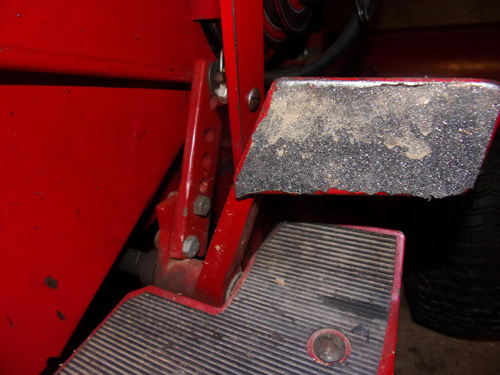

Jim Turner 47 #28 Posted January 28, 2021 On 5/7/2017 at 10:37 PM, roadapples said: All good advice...I too am partial to the C160... If one of these don`t work out I`m sure you can make a good deal at the Big Show next month, and plenty of good people to help with questions and suggestions...hope to see you there.. Please show me your foot motion control. Share this post Link to post Share on other sites
roadapples 6,987 #29 Posted January 28, 2021 Sorry, not me. Try @Ed Kennell... Share this post Link to post Share on other sites

Ed Kennell 46,581 #31 Posted January 29, 2021 14 hours ago, Jim Turner said: Please show me your foot motion control. 3 Share this post Link to post Share on other sites
Jim Turner 47 #32 Posted February 1, 2021 On 1/29/2021 at 6:54 AM, Ed Kennell said: Very cool, thank you! I would like to figure out a way to do it like Bolens did on their machines. I might be wrong but I don't think they have to maintain pressure to keep it going in one direction or another. But I need to verify that. Share this post Link to post Share on other sites
