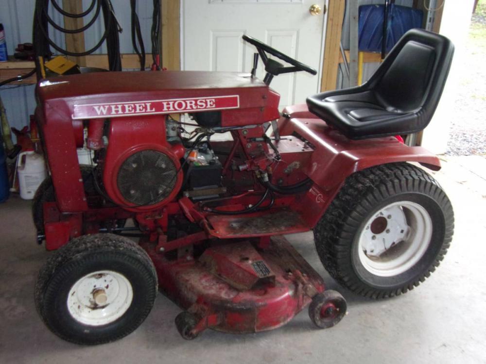

csvt99 173 #1 Posted May 7, 2017 Hello, I have an 877 hydro with the 8 hp Kohler and sun strand hydro with a 32" deck. I love this thing with the exception of the smokey motor, but I'm hoping a future rebuild will fix that. I am currently mowing with a spare family kubota diesel 4x4, but would like to switch back to a wheel horse. I would like more power to handle my slopes and a larger deck (42-48"). My family used to have a 1277 hydro but they seem to be difficult to find. Any suggestions on which models I should be looking for? I would like to use this to mow my lawn on a regular basis.Thank you! 2 Share this post Link to post Share on other sites

csvt99 173 #17 Posted May 10, 2017 Here are some photos of the c160 that I found for sale. 5 Share this post Link to post Share on other sites

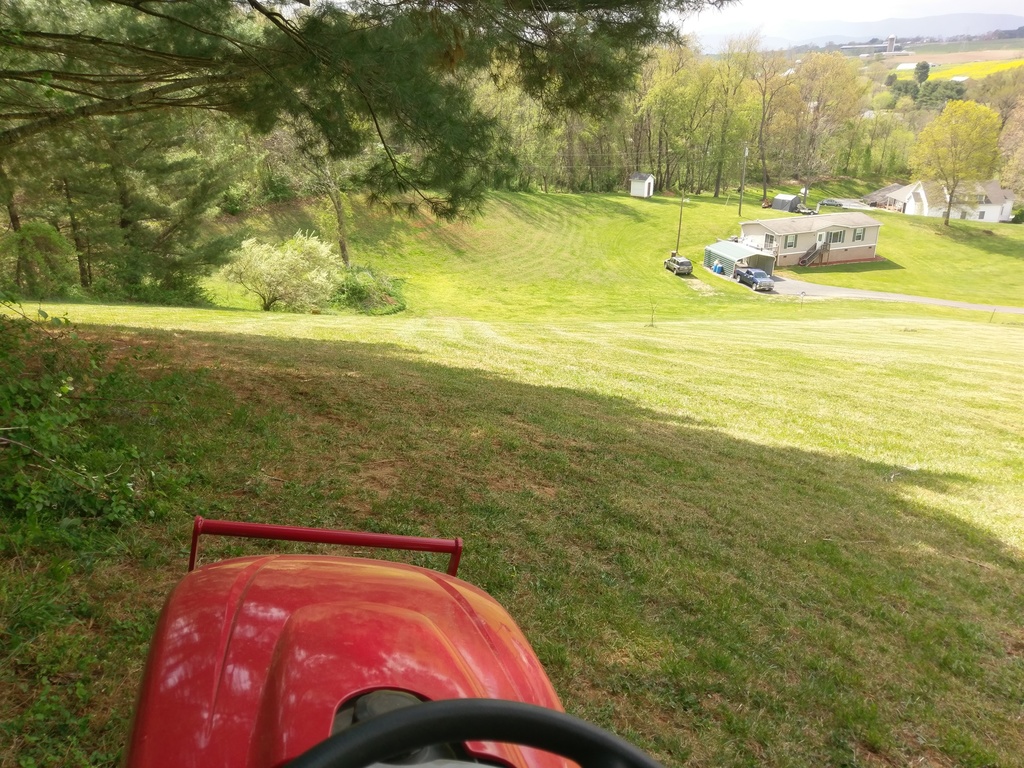

roadapples 6,987 #24 Posted May 12, 2017 1 hour ago, WVHillbilly520H said: First off I love my 520H I bought new, and with fluild filled AG tires and weighted wheels it does a good job on the slopes but I recently acquired myself a new red tractor a Mahindra SCUT eMax 22G with 60" deck but with 4x4 and gear drive it flat out does better sideways up and down steep slopes than my beloved 520, it holds back without sliding come down said slope (4wd engaged of course) which has happened to myself on a 520 like @ericj said above , not the most pleasant ride, but I'm thoroughly impressed with the safety agility of this little SCUT, so how come you find your to have better traction that the Kubota? turf tires? 4x4 not engaged? Just wondering?, Jeff. Picture of said slopes from the drivers seat of the eMax and the 520H (don't use those suitcase weights while mowing just blade and blower work) To each his own, but with that much land that hill would become wildlife habitat... 3 Share this post Link to post Share on other sites
WVHillbilly520H 10,379 #25 Posted May 12, 2017 9 hours ago, roadapples said: To each his own, but with that much land that hill would become wildlife habitat... Really it is, deer and turkey especially, rabbits and ground hogs all roam the hills and of course the dang moles ... Then there's the 10+ acres of wooded land back in WV that I'll inherit, Jeff. 3 Share this post Link to post Share on other sites
