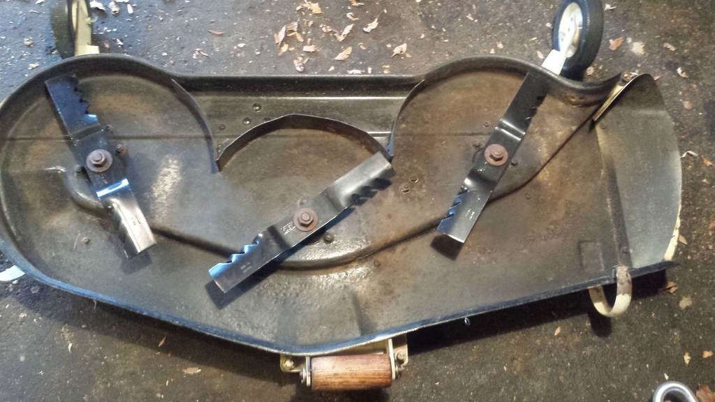

userj8670 68 #1 Posted May 2, 2017 What does every one put on the underside of decks to prevent them from rusting through? I was thinking POR15?? Thoughts? Share this post Link to post Share on other sites

userj8670 68 #11 Posted May 3, 2017 That AgriGard looks promising. Is the underside of this desk clean enough to apply? Or do I need to rough it up? I assume I should take the spindles out Share this post Link to post Share on other sites

ohiofarmer 3,470 #14 Posted May 19, 2017 (edited) On 5/3/2017 at 10:00 AM, userj8670 said: That AgriGard looks promising. Is the underside of this desk clean enough to apply? Or do I need to rough it up? I assume I should take the spindles out Use both the wheel that fits a mini grinder and a brush [80 grit] for the close in work. Wash the deck with detergent and rinse and dry in the sun. Get a cheap chip brush because the brush cannot be cleaned. Really do the best you can on the cleaning to tight rust and wash off the dust Rough or smooth does not matter, but clean is more important than getting to bare metal. If you get it on your hands it will take many days until it wears off, so use gloves. Here are the cleaning wheels that I recommend. The grit wheels[#60571] are faster, but the spoked brush wheel [#60325] will not go to pieces if it hits a bolt or an edge.https://www.harborfreight.com/catalogsearch/result/index/?dir=asc&order=EAScore%2Cf%2CEAFeatured+Weight%2Cf%2CSale+Rank%2Cf&q=abrasive+brush Painting Agriguard on on high humidity can make small air bubbles, so try for a dry day with temps in the 70's if possible. The appearance of your deck looks similar to the one i did right before sealing it. Edited May 19, 2017 by ohiofarmer Share this post Link to post Share on other sites
