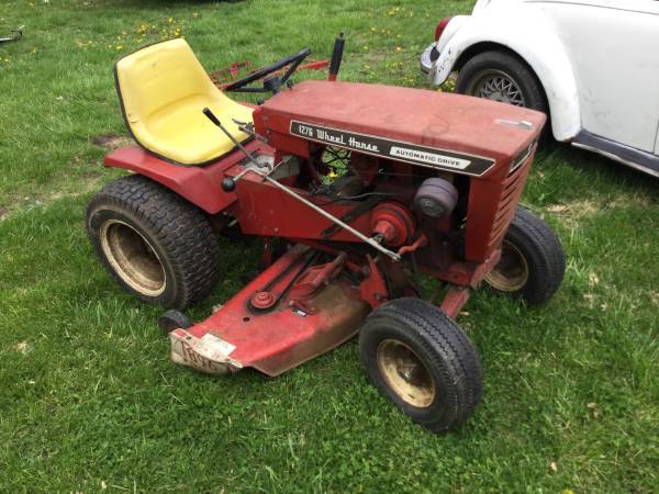

4stringdude 14 #1 Posted May 1, 2017 (edited) Hi all! I am new to this forum. In fact I do not own a Wheel Horse... yet. I am making arrangements to look over a Wheel Horse 1276 some day this week. I am asking for things I should pay particular attention to as I examine the tractor. I am attaching a picture, in case that helps. I have recently purchased a plot of land. I need to mow and work about 5 acres (more like 1.5-2). I would love to use my tractor for working a small food plot for deer. Do you think I'm going the right direction with this sort of tractor. Thanks in advance, Tim Edited May 1, 2017 by 4stringdude 4 Share this post Link to post Share on other sites
Mike'sHorseBarn 3,562 #2 Posted May 1, 2017 I have the sister to this tractor! A 1076 that even came with the same color seat lol I don't know what your mechanical ability is that will determine a lot as far as what can be wrong with the tractor and not deter you from buying it. Some typical thing to look for are in the engine such as does it smoke, knock, miss, etc. Cosmetically it doesn't look too bad and the 1276 is a good tractor. Make sure the hydrostatic transmission works and works well. Repair of those transmissions can be very costly for sure. I know that there are some who will be along to give you more specific lookouts than me and you will learn a lot here! Would I use it to mow 5 acres, No. I would find a different horse for that, but that is just my 2 cents for what it is worth. Good luck! Mike 1 Share this post Link to post Share on other sites

ClassicTractorProfessor 5,455 #5 Posted May 1, 2017 Nice looking unit you found. I have a 1277 (same tractor just one year newer) that was my dedicated mowing tractor up until a rod came through the block last summer, still haven't gotten that back together. As Mike stated above, be sure and check the hydro out good, another way you can check is to chain it to a tree or solid object, and see if the tires dig in when you engage the transmission. The hydro can't be beat for mowing, and maybe even plowing snow. But, my opinion, if you are going to be doing any serious amount of ground engaging work, then a gear drive transmission may be a better option. I love my hydro for mowing but the big jobs get saved for my C-125 8-speed. Oh and forgive my manners 1 Share this post Link to post Share on other sites
WHX?? 56,851 #6 Posted May 1, 2017 Tim That tractor is certainly capable to mow the 1-2 acres you might have but professor is right about the ground attachments for working that deer plot. A gear drive would be better suited. 46 minutes ago, 4stringdude said: that is not in need of constant repair Expect to do some repair on a 50 yo tractor like that. Usually fixing jury rigs a PO might have done to it & catching up on maintenance items it may have never got. Is that a old license plate over the mower discharge? I wouldn't be afraid to add it to my herd, my 1257 is the nicest running Kohler I have. 2 Share this post Link to post Share on other sites

WHX?? 56,851 #8 Posted May 1, 2017 Does sound like a good buy then... wheel weights alone go for 150 and they don't wear out! Any chance it comes with a black seat tho?!?! 2 Share this post Link to post Share on other sites
stevasaurus 23,712 #9 Posted May 1, 2017 Welcome to Red Square. That horse appears to be in great shape, and should clean up easily. I have an 876 automatic, and I love the hydro. My horse has the same transmission as the one you are looking at. My frame is a touch shorter and the engine is an 8hp. Your 12 hp and that deck will handle your mowing needs and will be a pleasure to use. If you have to push the tractor, to load it, make sure you lift the seat and open the tow valve on the left side of the trans. Mine uses a 1/2" open end wrench. Check your manual to see where it is. You only need about 1/2 turn to open the valve. Let us know. If that horse runs as good as it looks...$600 is a steal for all that goes with it. 1 Share this post Link to post Share on other sites

Sarge 3,471 #16 Posted May 9, 2017 Personally , I'd ****** it up even if the trans is weak - use that as a bargaining chip . The later model piston units will bolt into that tractor with very little effort and with it being a late 60's model is about as simple as they come , especially for using attachments due to not having full floor foot rests . I've had a 1277 for a very long time and despite the things I've broken on it not one regret , other than the abuse I've given it over the years . That one is getting the rebuild it deserves this year and some well earned upgrades as well . It is one of the best horses made in my opinion , very simple to work on and pretty much bulletproof . Not to mention the farm tractor look...lol. Sarge 1 Share this post Link to post Share on other sites
