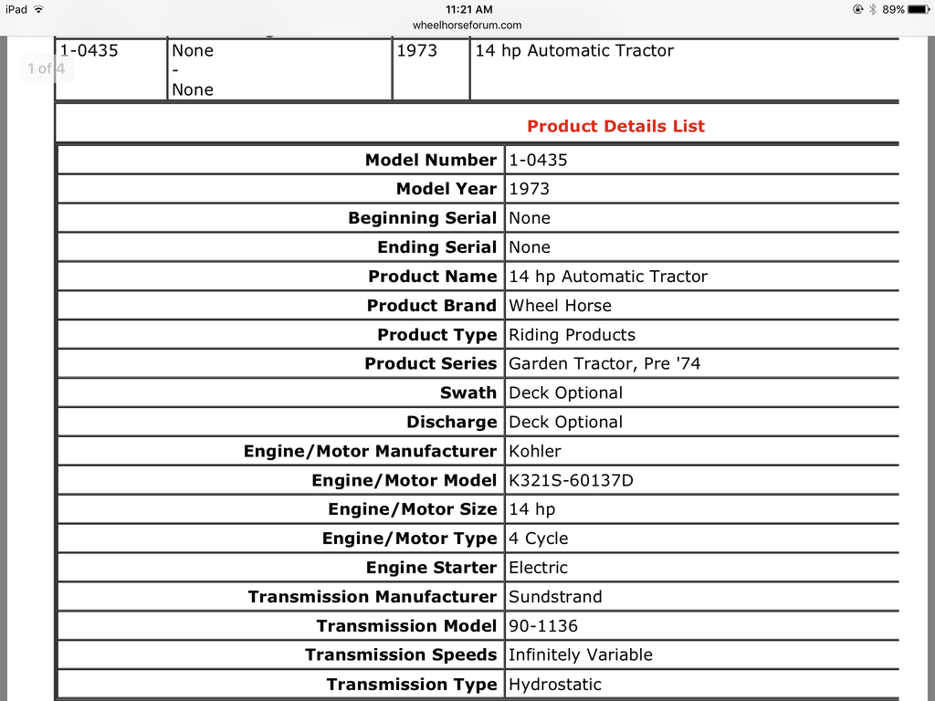

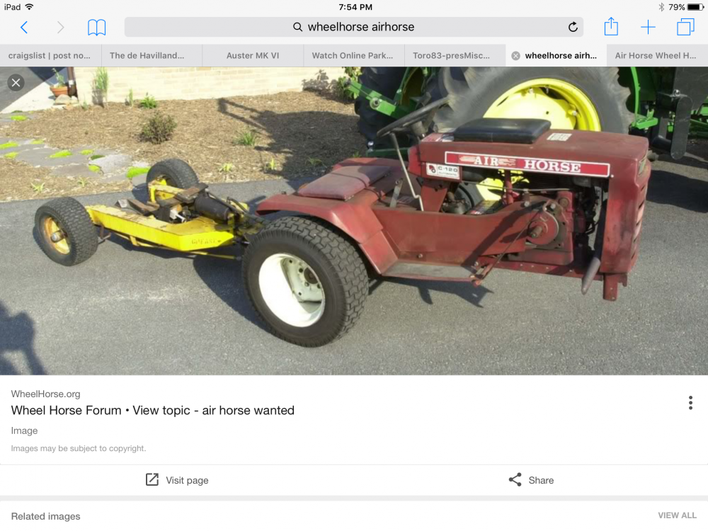

Recently purchased a 1973 14hp Automatic airhorse like the one in the pic here.   Model is 1-0435. Need it as tug for my airplane.
It won't go in reverse or forward anymore.  Everything looks fine.   The local Toro shop says the transmission has gone and no parts available anymore.   I see it uses a Sundstrand 90-1136.
Any ideas on repairs.   I am not in a position to repair myself.  Just. Looking to get replacement or substitute parts/sub assemblies for the local toro shop to effect a repair.

953 nut

Thanks very much for this list.   I see the model number for my horse shows it uses a Sundstrand 90-2046.   However my research from toro or even this site I think in the pic below shows a 90-1136.   Is there any differences.  Which should I believe.  I unfortunately cannot find the model number tag on my actual unit.  It has probably been removed because the whole unit has been painted green to look like a John Deere machine.

I doubt that there is a significant difference, it could be as simple as a smaller drive pulley or a two groove pulley. I see the same model and year using the 90-1136 and 90-2046. I have used components from an Electro on the hydro of my GT-14 and it works great. If you can find a good operable unit from a similar year :wh: there should be no issues replacing yours.

I was blown away that this exists.  i was admiring the TUGS a few weeks ago at the airport.  What wheels are turned by the steering wheel?
Paul1650
The small rear wheels turn and also two rams move the articulated rear yellow frame.  One s its on the hood of the engine facing backwards and reverse steals it while backing up to the aircraft nose wheel.   There are some videos on-line showing at work.

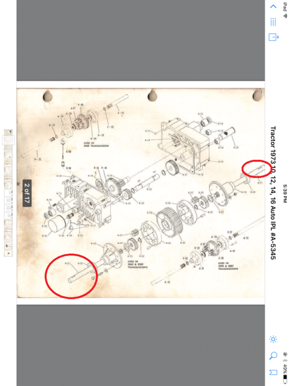

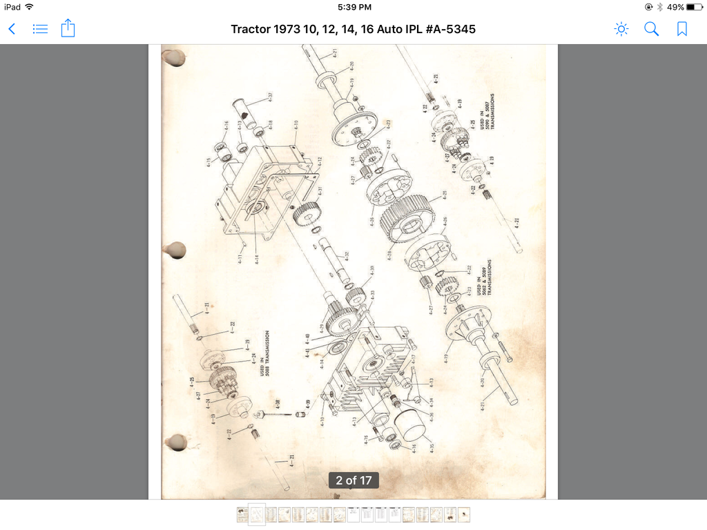

Thanks for this Richard.  I will ask the local shop to look into this particular item first.  Is this the woodruff type key I saw on the parts schematic on the axles?  Which part number on the attached picture will the key be on?
Blasterdad
Slot in the end of the axle 4-21
  • Like 1
You will find it shown on page 13 with the rear hub. Have them start it and put it in forward  and look at each axle, the axle will be turning inside the hub on one side. The woodruff key is Wheel Horse part number 937022 and is a common hardware item; just your basic # 15 key. Presuming it is the woodruff key (pretty sure at this point that that is all you need) you can tell the "Professionals" at the Toro shop that we don't charge any consultation fees! Next time they are stumped just have them log onto the RedSquare site.    :hilarious:
Chances are you will need a new hub also.
