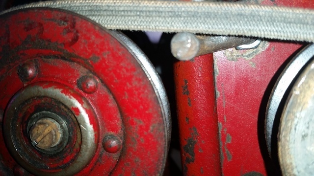

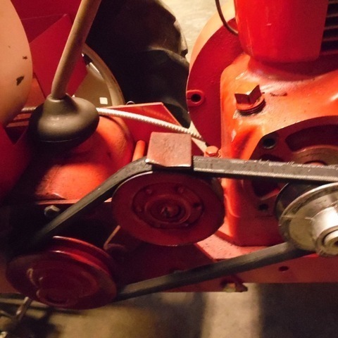

WHX?? 51,695 #7 Posted April 25, 2017 This is what it should look like if you have the engine mounted snubber. It should ride on top of the belt tho I was just desperate to try anything to get it to work. I had to make one that looks like the idler mounted one in the 2nd pic to solve my problem. Otherwise anything like Steve showed will work too. BTW I had thought we run a 29" belt on these??? Have to ask @Racinbob about that. 3 Share this post Link to post Share on other sites
stevasaurus 23,274 #8 Posted April 25, 2017 The ones in the pictures were just made by @walfish at the big show. He had some pieces of rod with him and a couple of pairs of pliers. The rod appears to be either 3/16" or 1/4" and just bend them to fit what you have there. That piece of metal over Jim's picture of the idler pulley is a must also. The guard is a plus and a safety thing in this case. If you bend and place those pieces, you will be able to shift you tractor. 1 Share this post Link to post Share on other sites
