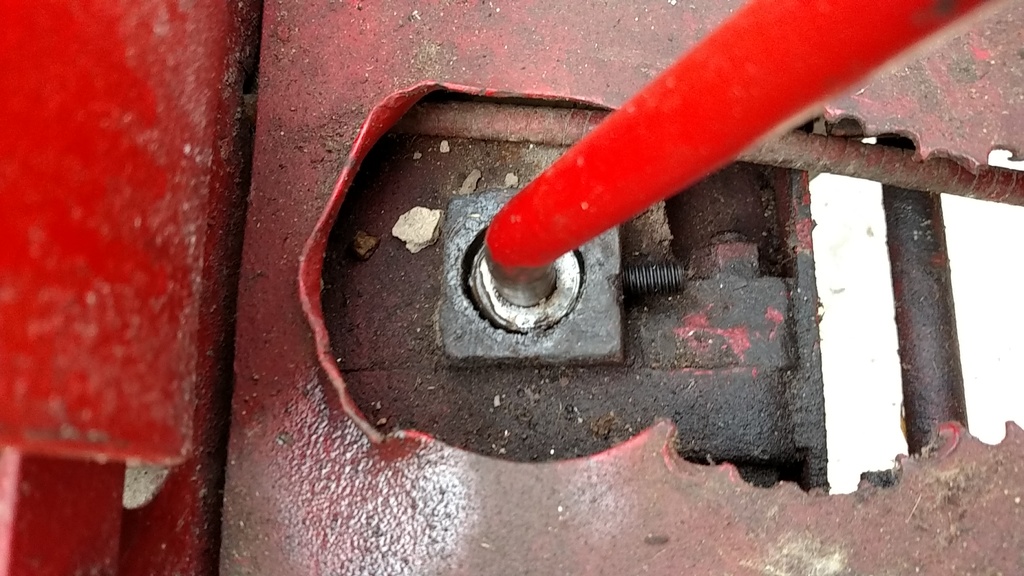

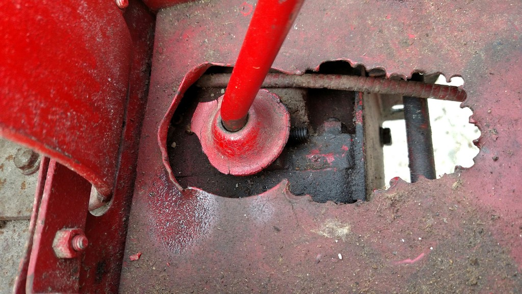

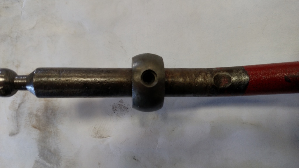

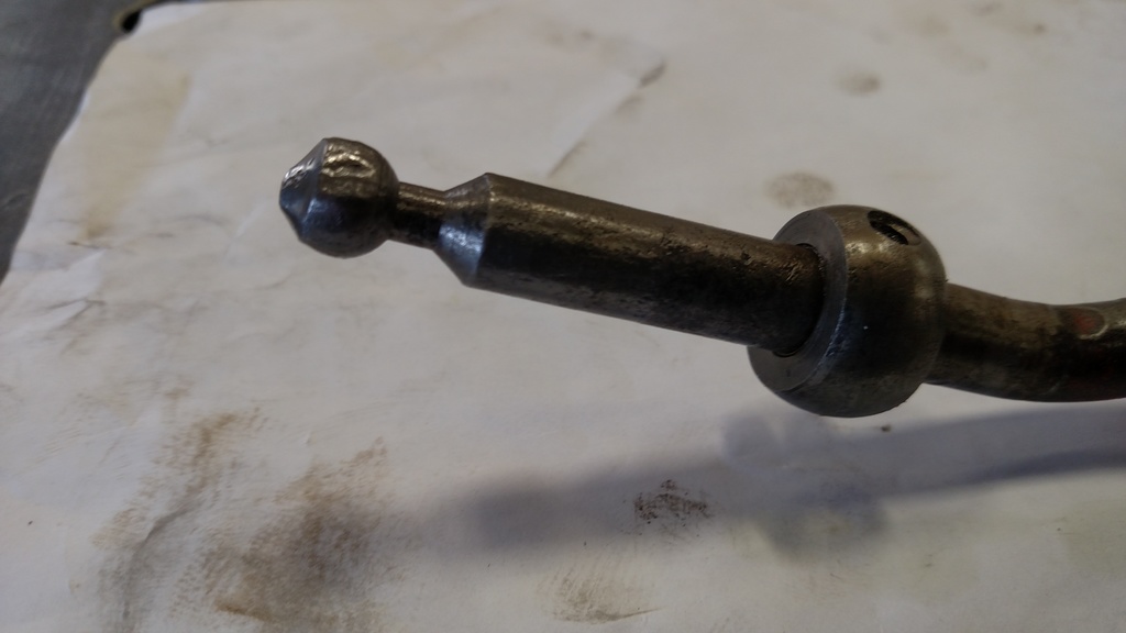

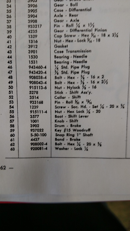

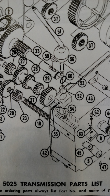

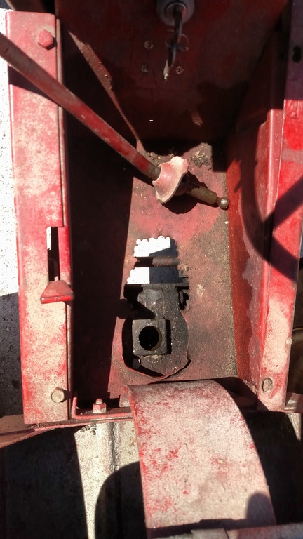

TIGman 2,006 #1 Posted April 24, 2017 (edited) On the 753 I just picked up was trying to figure out what I might be missing in the transmission area after the chop job someone did.... Looks like all I am missing is the 1/4-20 x 3/4" socket head set screw for holding the shift lever in the correct position. Was wondering what gear lube they used in that transmission? Looks like the end of the shift lever on the ball end could use some TLC also. Hope I can find some one who welds..... Edited April 24, 2017 by TIGman 2 Share this post Link to post Share on other sites

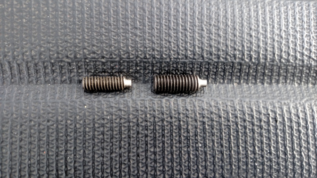

gwest_ca-(File Mod) 12,387 #3 Posted April 24, 2017 The set screw is a dog-point type. Garry 2 Share this post Link to post Share on other sites
TIGman 2,006 #4 Posted April 24, 2017 Thanks!! 953 and Garry that answers my questions. I wondered if the end of the set screw was some special shape. 1 Share this post Link to post Share on other sites
953 nut 67,654 #5 Posted April 24, 2017 Dog point screw 1 Share this post Link to post Share on other sites
TIGman 2,006 #6 Posted April 24, 2017 Yes Sir we have dog point set screws in the parts crib, but I think 1/2"-13 threads are a little big. lol I made up one. 3 Share this post Link to post Share on other sites
WHX?? 57,493 #7 Posted April 24, 2017 Yah there're easy to make in a pinch. you gonna open that tranny up Tigs?? who know what other monkey business was going on there. Why on earth somebody would booger up a tunnel like that!! 3 Share this post Link to post Share on other sites

TIGman 2,006 #9 Posted April 24, 2017 Going to claim a small Victory on the tranny tonight. Made up a 1/4-20 dog point set screw before leaving work. Of course when I get home I noticed some one opened it up to 5/16-18. Made up another set screw, installed it and shift lever and the tractor shifts into all the gears. YAY !!! Still have to do something with the giant hole they chopped in..... 2 Share this post Link to post Share on other sites
stevasaurus 23,763 #10 Posted April 24, 2017 You want to gently tighten that set screw and then back off no more then 1/4 turn...then snug with a lock nut. Nice looking set screw. Don't ya just wonder what somebody was thinking to drill all those holes like that? If the guy that did that went into that trans, I would open it and take a look. Actually, it would have been easier to drop the trans and go after that set screw instead of what he did there. 3 Share this post Link to post Share on other sites
JPWH 6,544 #11 Posted April 24, 2017 It would probably be easier to make a new pan than repair that damage. Jay 3 Share this post Link to post Share on other sites
WHX?? 57,493 #13 Posted April 25, 2017 That's a common thing to find Tigger ...changed to 5/16. I got an RJ like that. Well that explains the butchered up tunnel anyway. From the looks of that shifter ball maybe he had the dog point under the shift pivot. Check under neath it to see if it chewed up there. Just to relate on this new to me 1055 with the froze tranny the set screw was twisted off. After I pulled the tranny the busted off piece backed right out with two fingers!... Lucky..... Good thing you sent me two @Racinbob Maybe I should have just hacked on the tunnel so you could make me a new one. Looks like yer gonna need practice! 3 Share this post Link to post Share on other sites
TIGman 2,006 #14 Posted April 25, 2017 I sure wish the 753 could talk..... Would probably tell me some horror stories. lol I think possibly they stripped out the 1/4" and opened it up to the next size. Will have to check out everything really close on tractor for sure. 4 Share this post Link to post Share on other sites
