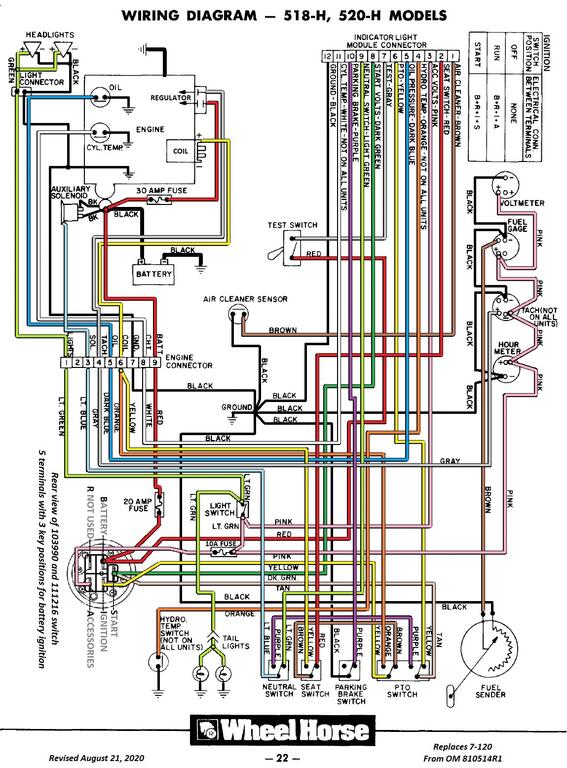

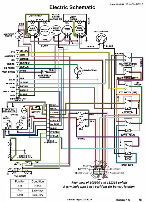

gwest_ca-(File Mod) 12,489 #20 Posted October 18, 2020 Yes but include a heavy duty 30 amp fuse holder and fuse in the wire. The original 30 amp fuse can be eliminated. 1st one 1988-89 520-H wiring 2nd one is 1994 Garry Share this post Link to post Share on other sites

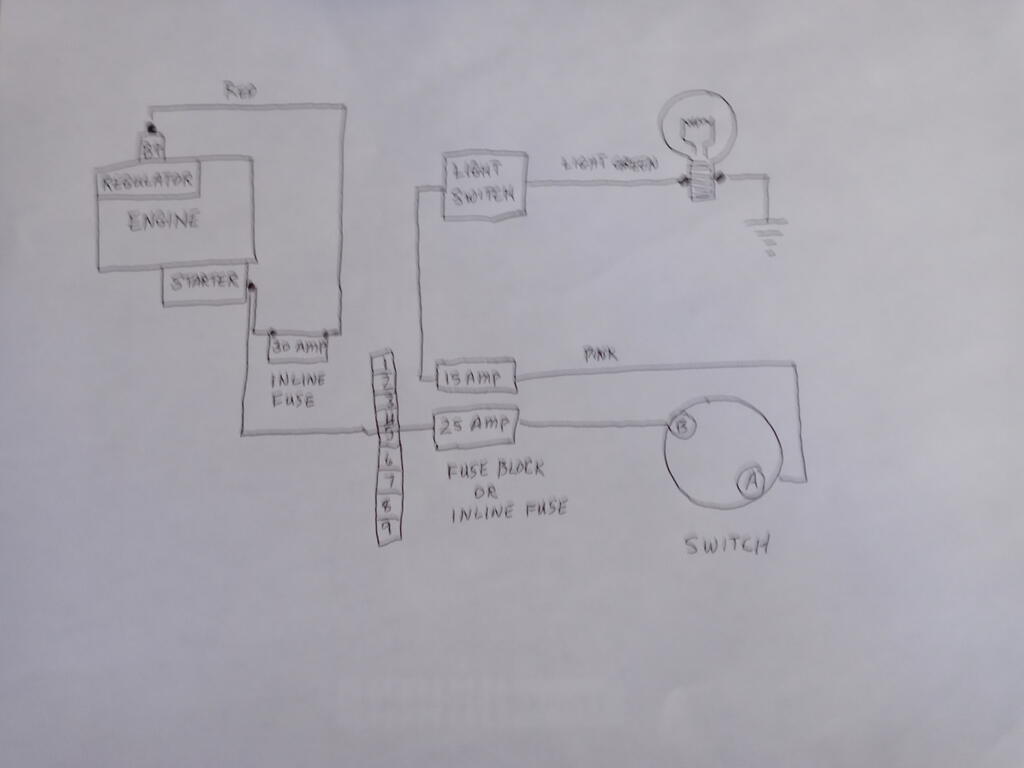

Horse Newbie 7,405 #21 Posted October 18, 2020 9 hours ago, gwest_ca said: Yes but include a heavy duty 30 amp fuse holder and fuse in the wire. The original 30 amp fuse can be eliminated. 1st one 1988-89 520-H wiring 2nd one is 1994 Garry So this is it ? ...It helps me grasp it to draw it, and if you say this is it (see pic), then I am sure I know what to do now. Thank you Garry for taking the time to help us out ! Share this post Link to post Share on other sites
Horse Newbie 7,405 #22 Posted October 18, 2020 (edited) I may not run either the 30 amp charge wire or the 25 amp ignition circuit through the 9 pin connector. Sorry if I done wrong by jumping in on this thread...didn't mean to highjack. Thanks again for you alls help ! Tim Edited October 23, 2020 by Horse Newbie Share this post Link to post Share on other sites
gwest_ca-(File Mod) 12,489 #23 Posted October 18, 2020 Your diagram is correct. Removing those two from the connector is not a bad idea. May save some grief later. Garry 1 Share this post Link to post Share on other sites

Horse Newbie 7,405 #25 Posted October 20, 2020 (edited) 47 minutes ago, rick said: Just a quick question here- is this problem only with 520 tractors? I have a 416 tractor with no discoloration of the nine pin connector, yet. I did have some yucky fuses that I replaced and cleaned up the block. PO never blew the tractor or engine off after use, I think. It seems to be a problem with the 9 pin connector and I don't know if 520h' s is the only tractors that had the 9 pin connectors. I plan on altering my 1994 slightly by running a 12 gauge wire from the B+ on the regulator straight to the starter post where the battery cable hooks up, protected by a 30 amp fuse in a weather tight inline fuse. I also am going to run the 25 amp wire from the same post up through a 25 weather tight inline fuse to B on the ignition switch.Thus eliminating both the 30 and 25 amp circuits from my 9 pin connector. The only fuse I would have in the fuse block would be the 15 amp, but actually I'll probably put it in a weather proof inline fuse holder too eliminating the fuse block all together. Edited October 20, 2020 by Horse Newbie Share this post Link to post Share on other sites
