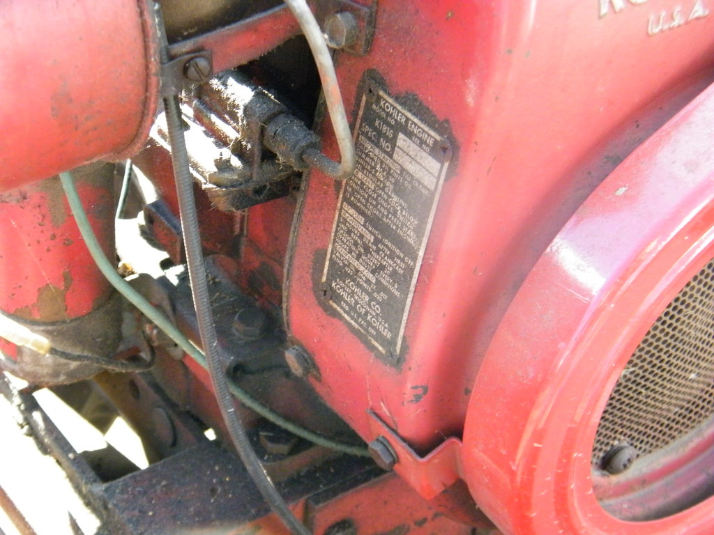

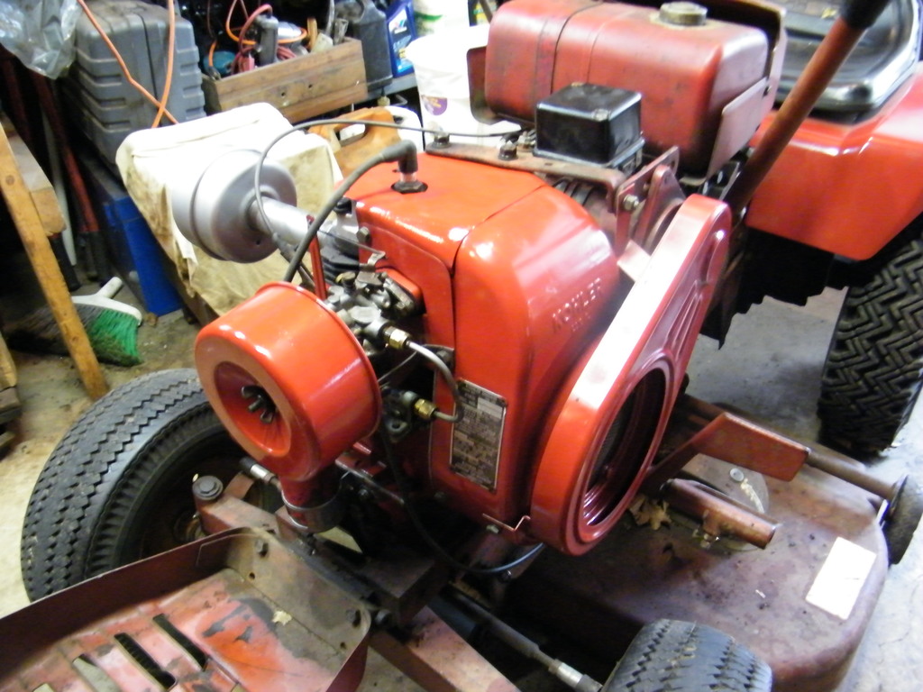

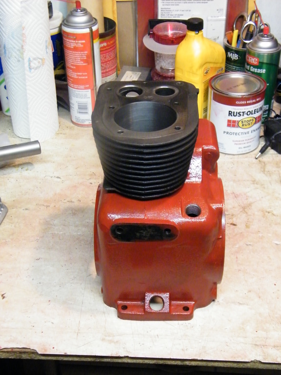

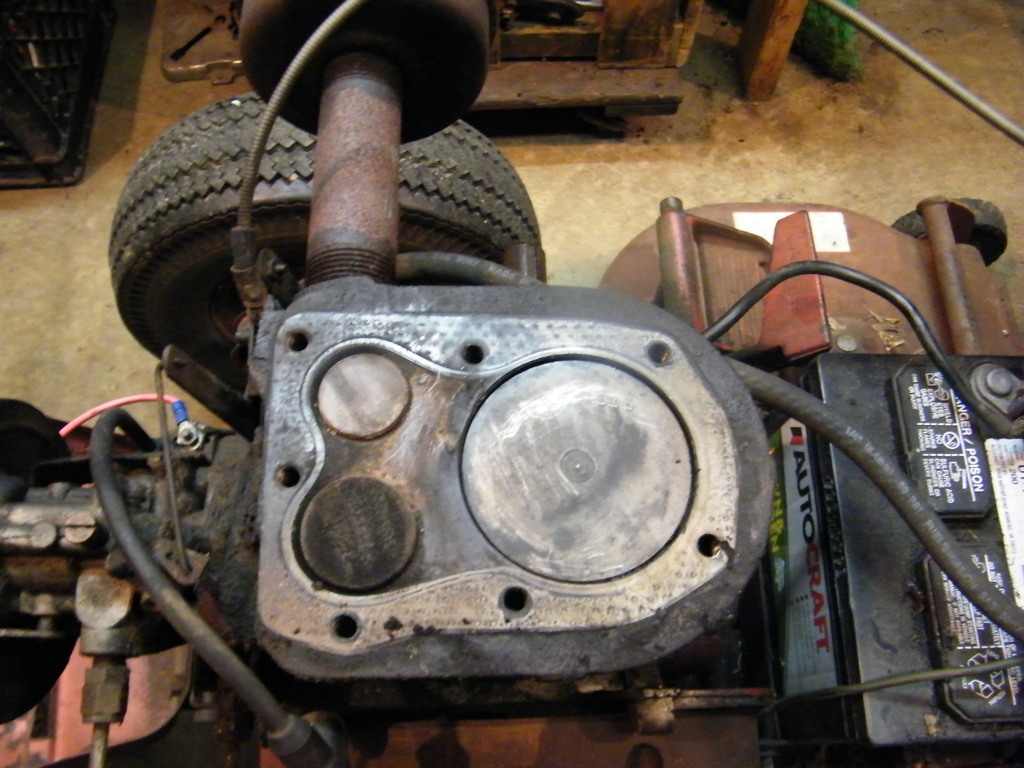

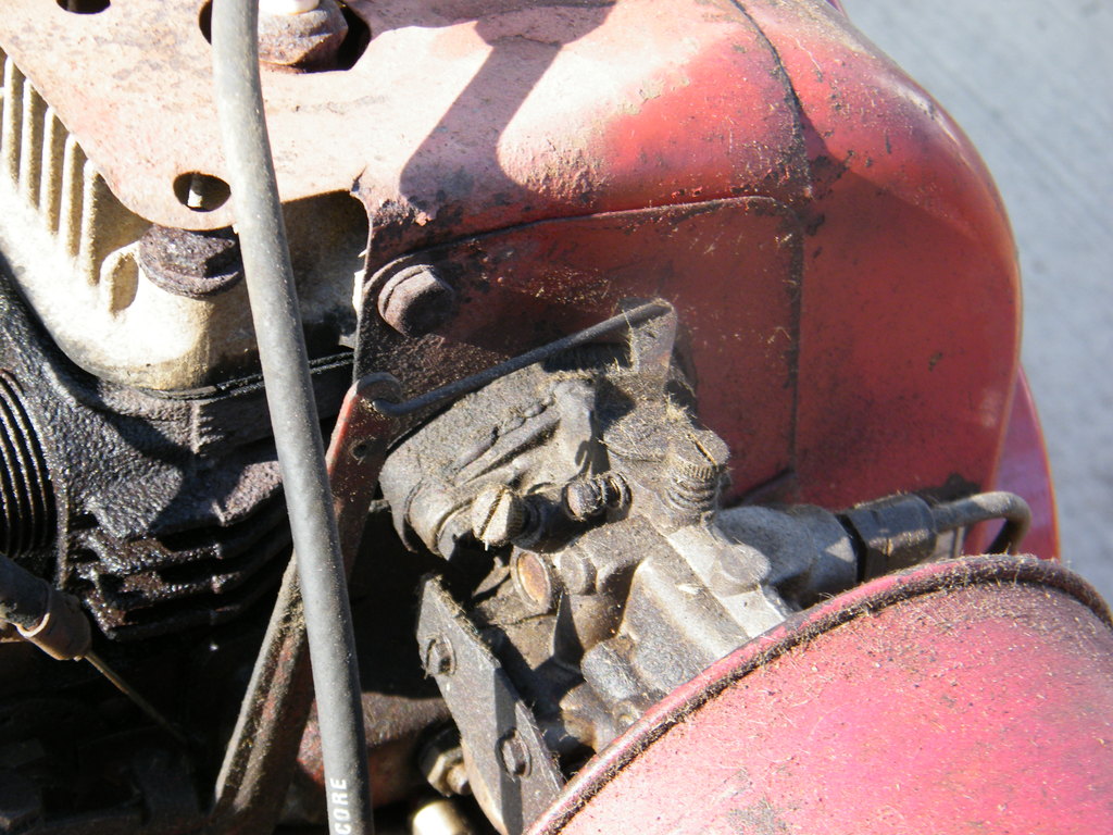

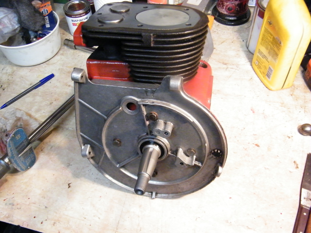

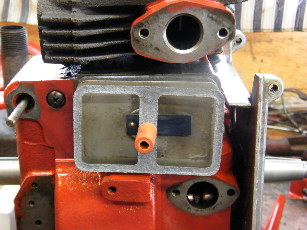

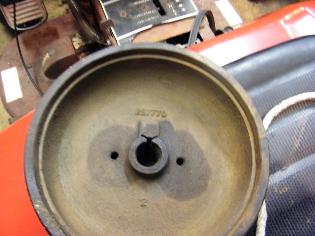

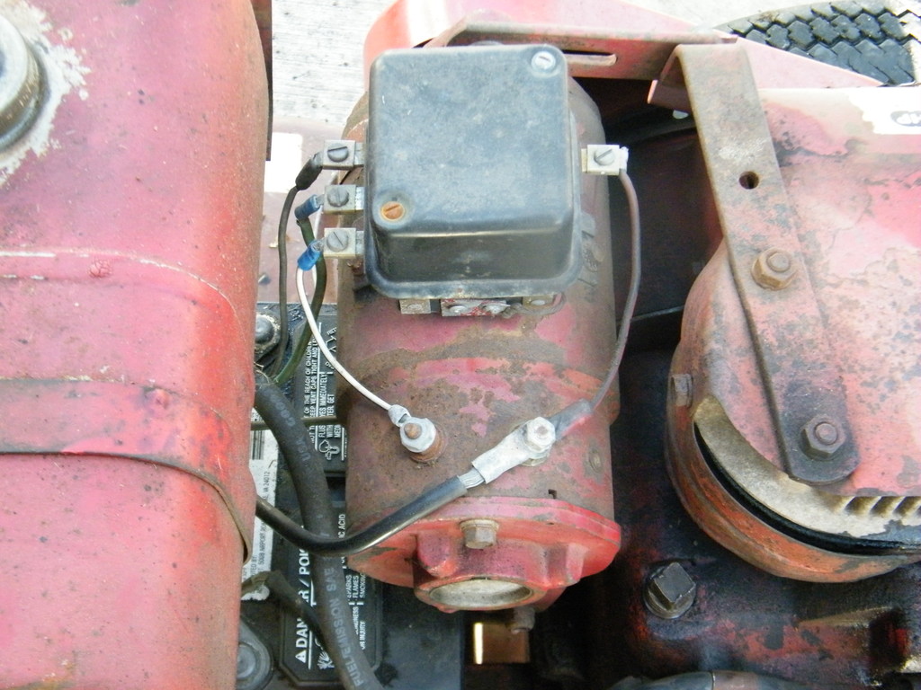

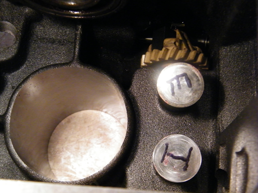

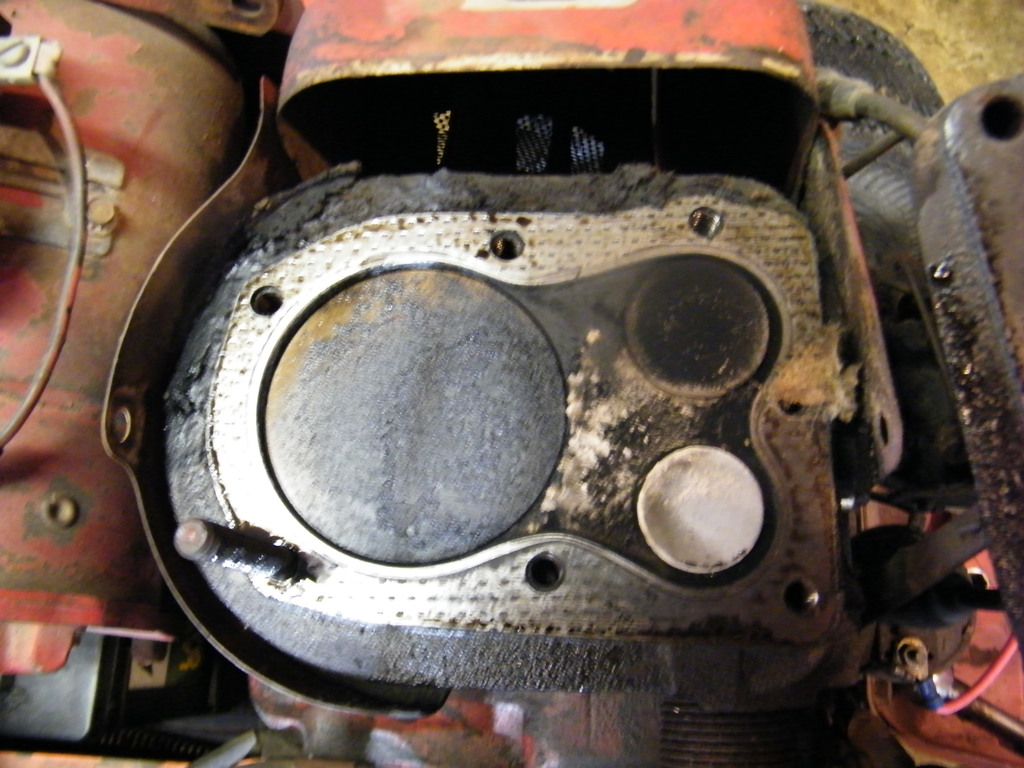

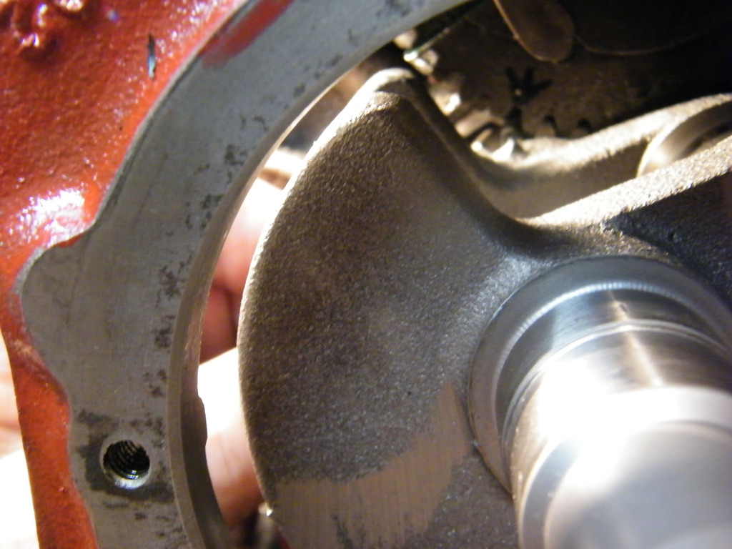

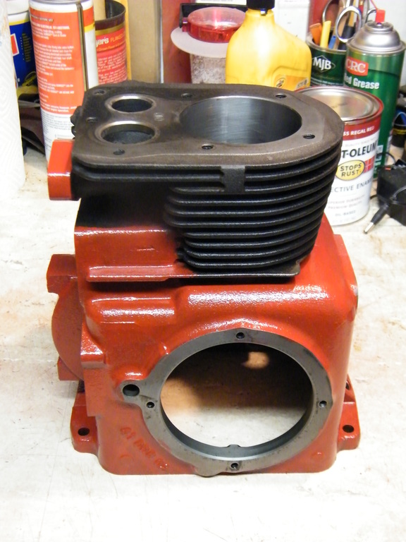

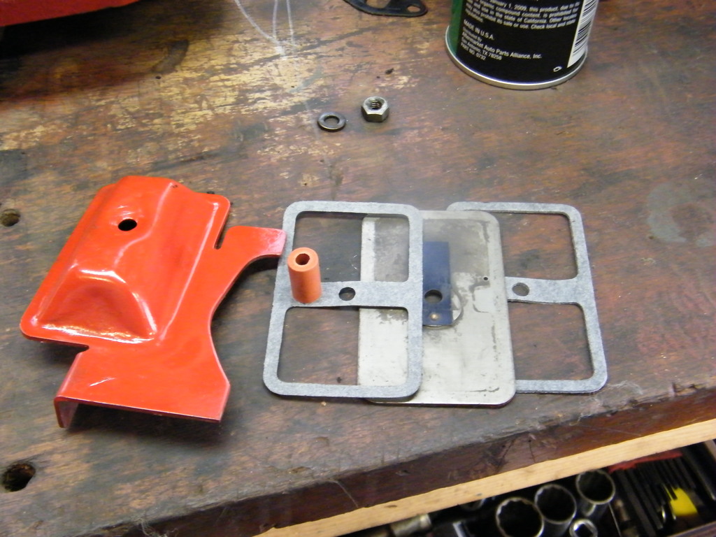

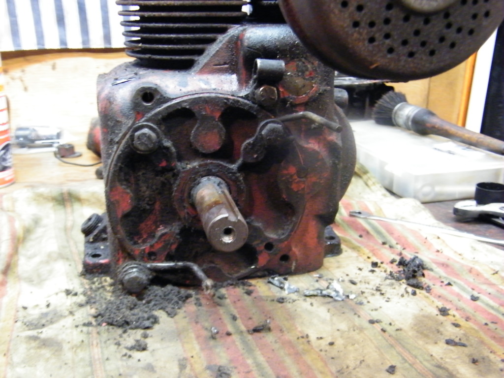

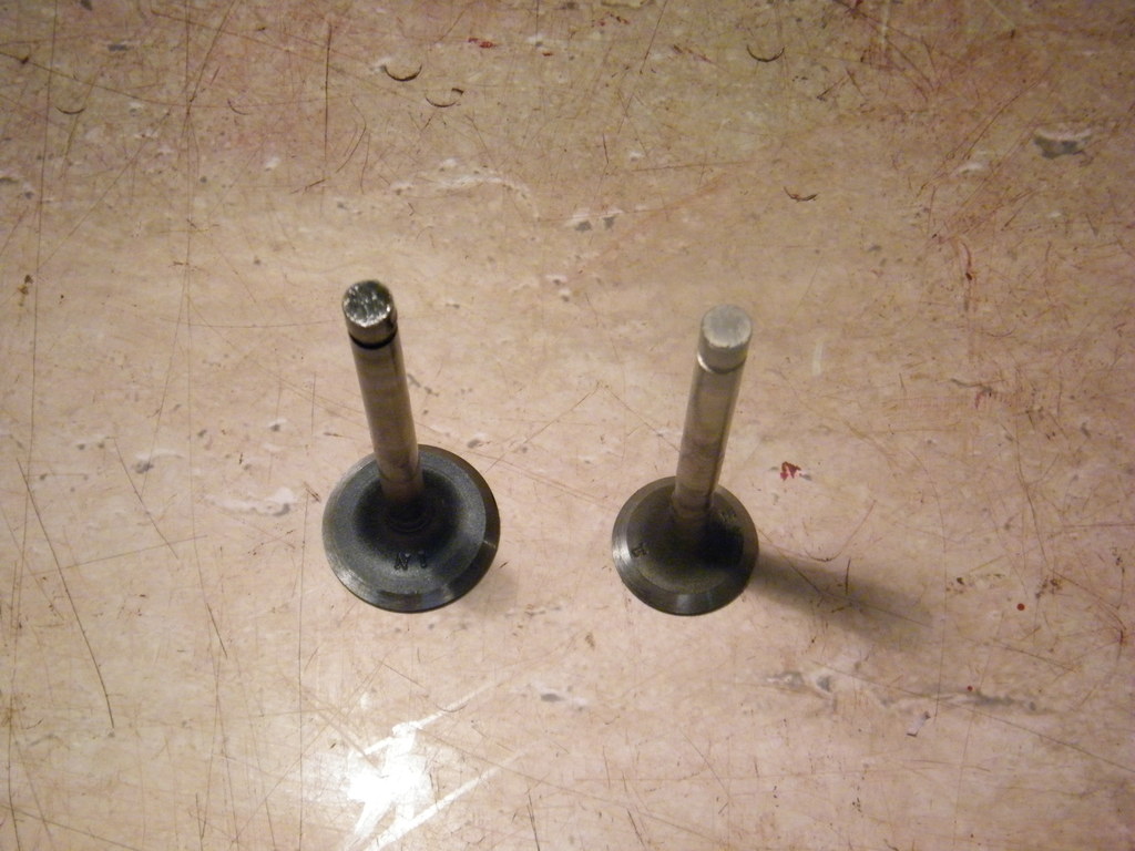

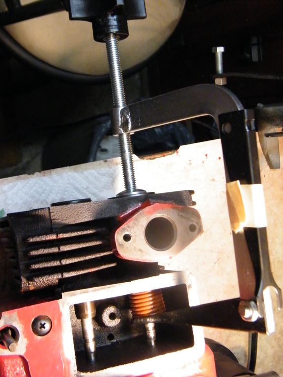

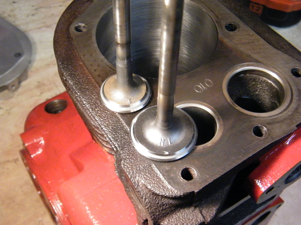

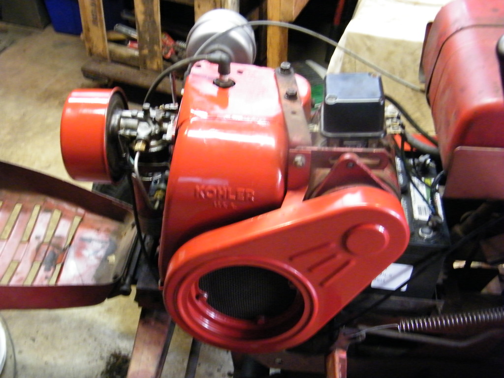

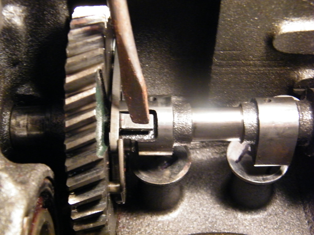

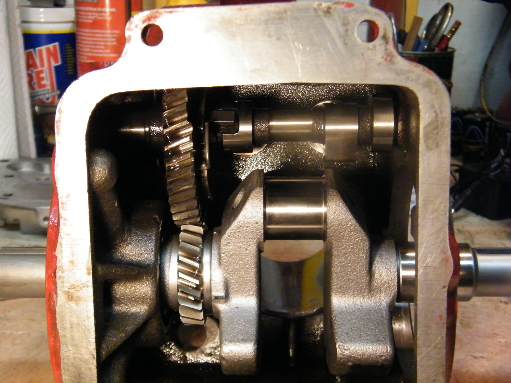

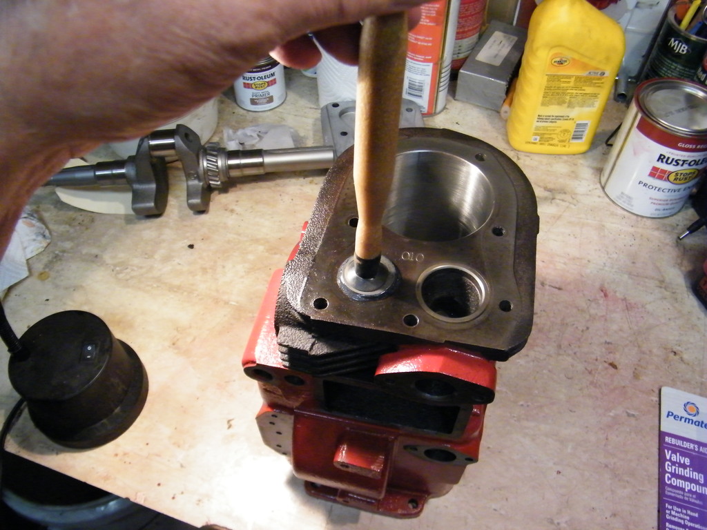

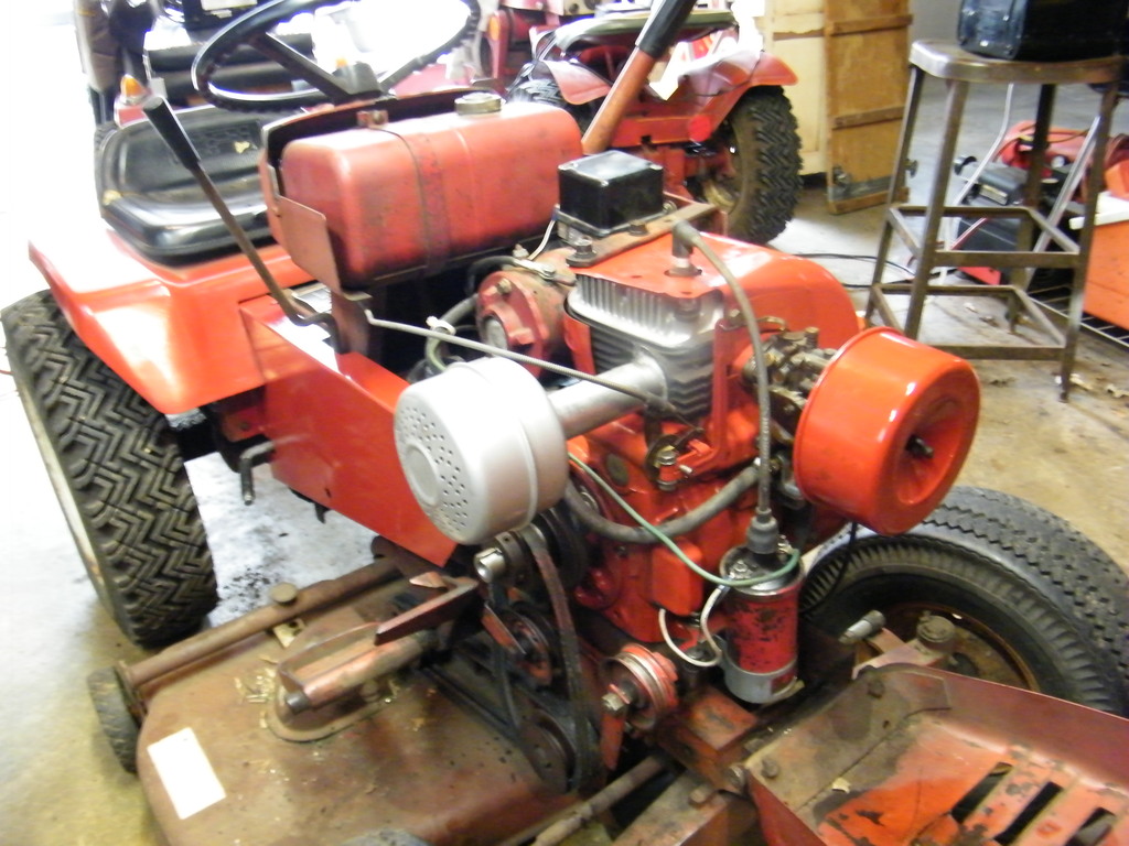

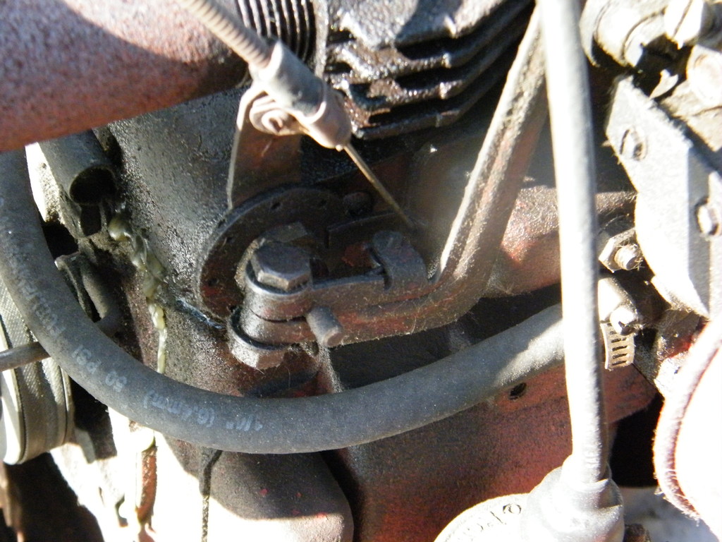

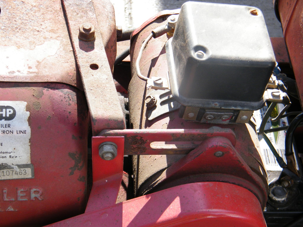

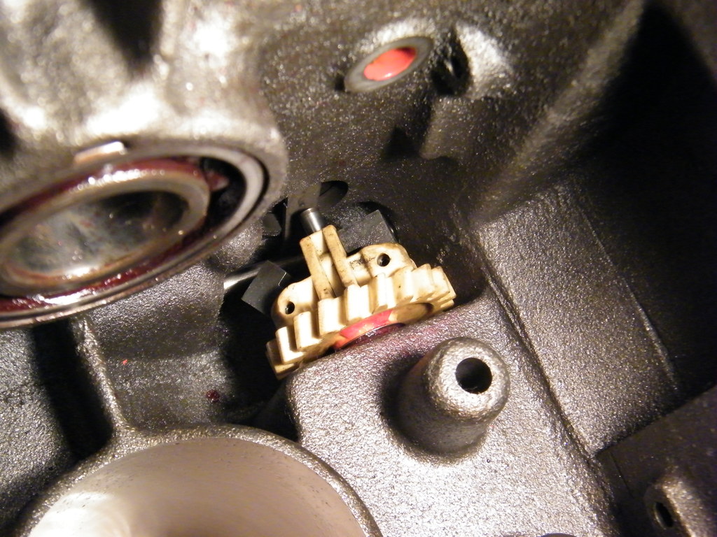

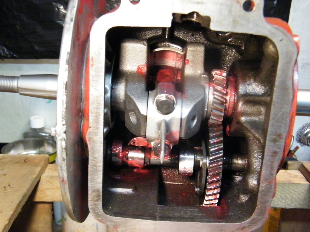

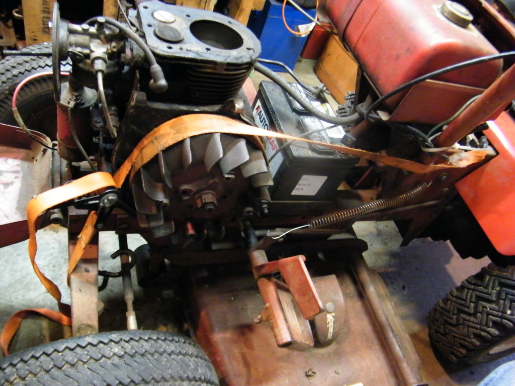

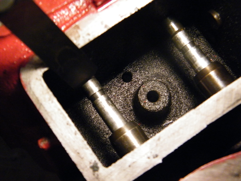

stevasaurus 23,712 #1 Posted April 21, 2017 This is the 2nd Kohler 8hp engine that I rebuilt. Thanks for looking. 1. 2. 3. 4. 5. 6. 7. 8. 9. 10. 11. 12. 13. 14. 15. 16. 17. 18. 19. 20. 21. 22. 23. 24. 25. 26. 27. 28. 29. 30. 31. 32. 33. 34. 35. 36. 37. 38. 39. 40. 41. 42. 43. 44. 45. 46. 47. 48. 49. 50. and finally the video "Dueling Short Frame Square Hoods" click on link under here. 51. https://www.youtube.com/watch?v=BqB3molMjzI 12 Share this post Link to post Share on other sites

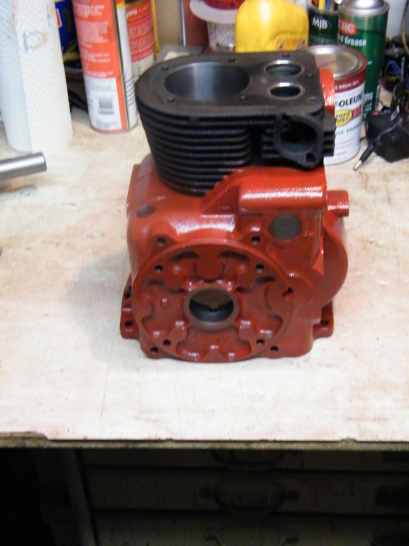

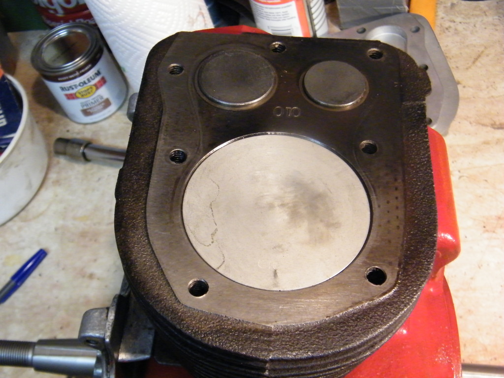

Texas Todd 1,026 #3 Posted April 21, 2017 Nice job Steve! I didn't notice any markings on the piston. Didn't have to bore that one? That makes it a lot more fun (and not as spendy!) Is there anything that Steve can't do? 1 Share this post Link to post Share on other sites
stevasaurus 23,712 #4 Posted April 21, 2017 The Kohler on this 876 had the STD piston. I had to have the cylinder bored to .010. I had to use the crankshaft from my K181 spare and have that turned to .010 under. Cost was about the same as the 857...about $200 for parts and labor. 1 Share this post Link to post Share on other sites

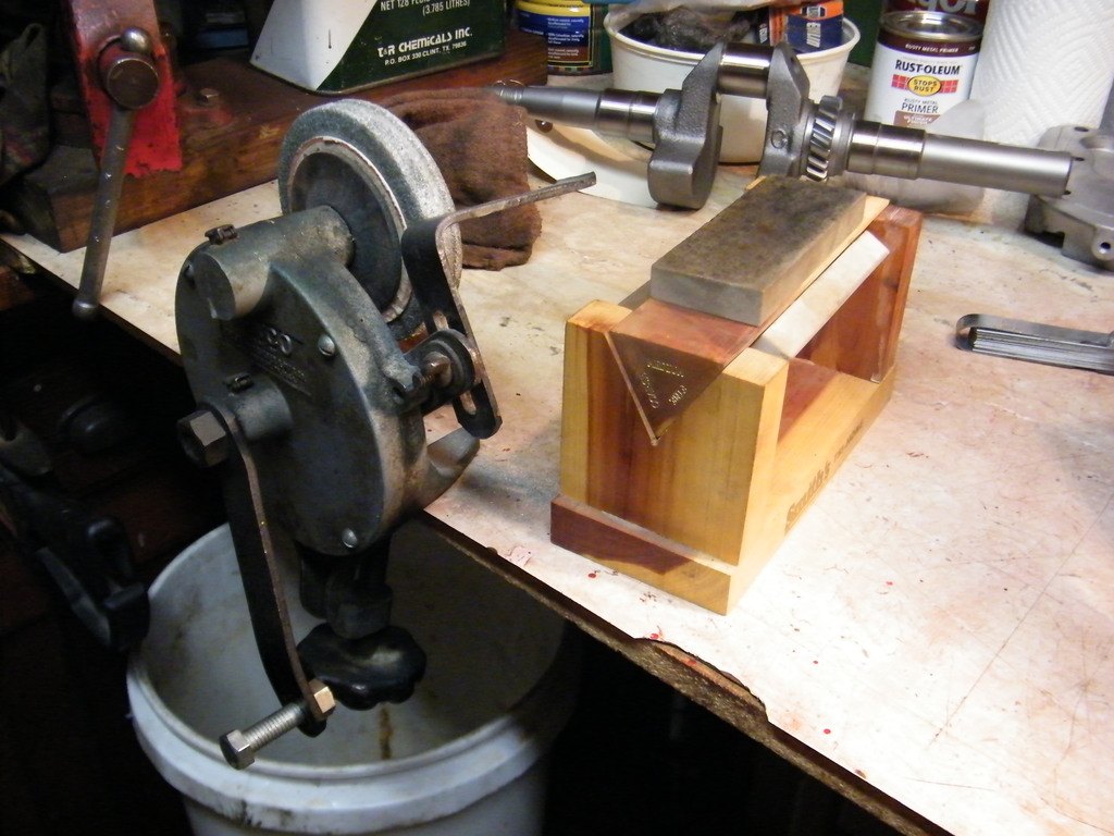

elcamino/wheelhorse 9,363 #5 Posted April 21, 2017 Really a nice job on the rebuilt. You did great work. I thought I was the only Ole F- - T that has a hand powered grinder . 2 Share this post Link to post Share on other sites
squonk 46,886 #6 Posted April 21, 2017 38 minutes ago, elcamino/wheelhorse said: Really a nice job on the rebuilt. You did great work. I thought I was the only Ole F- - T that has a hand powered grinder . How else does one do their nails? 4 Share this post Link to post Share on other sites
