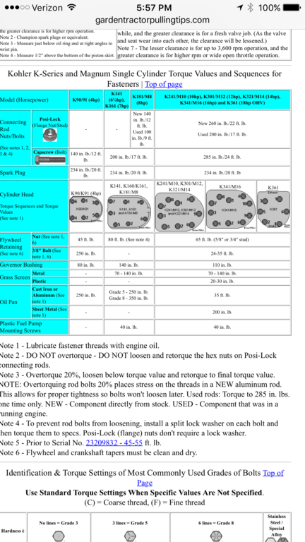

953 nut 70,293 #2 Posted April 19, 2017 Check this out. Kohler Single Cylinder Engine Specs _ Torque Values and Sequences for Fasteners _ Identification & Torque Settings of Most Commonly Used Grades of Bolts (1).html 2 Share this post Link to post Share on other sites
Aldon 4,834 #3 Posted April 19, 2017 If you click the link on Torque on the page @953 nut provided it takes you to a page that shows the top of the head and bolt patterns. 2 Share this post Link to post Share on other sites
