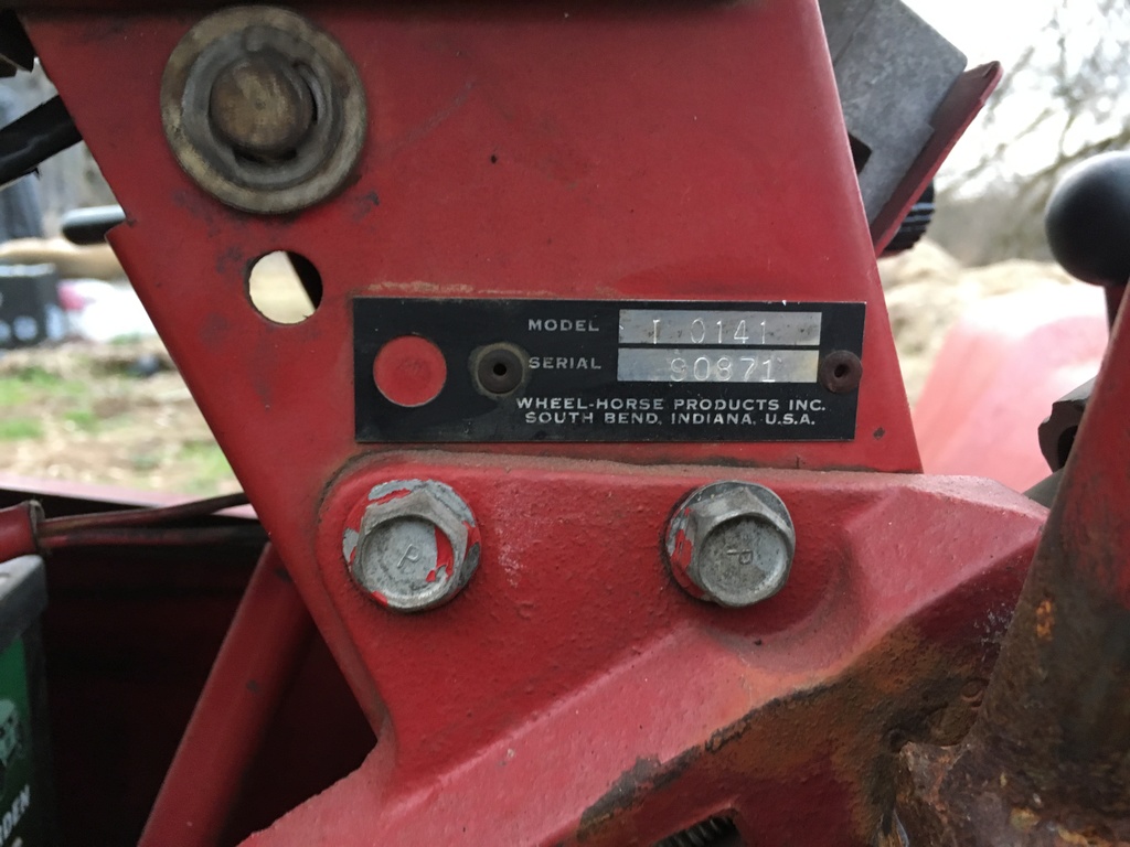

Deadguy 864 #1 Posted April 15, 2017 Just how far could you factory custom order a Wheel Horse back in the day? I have a B80 whose ID plate states it is a 1975 model year 4 speed, but it has an 8 speed, and it uses an 85" drive belt, not the 82" 7473 that the manual calls for. Any thoughts? 3 Share this post Link to post Share on other sites

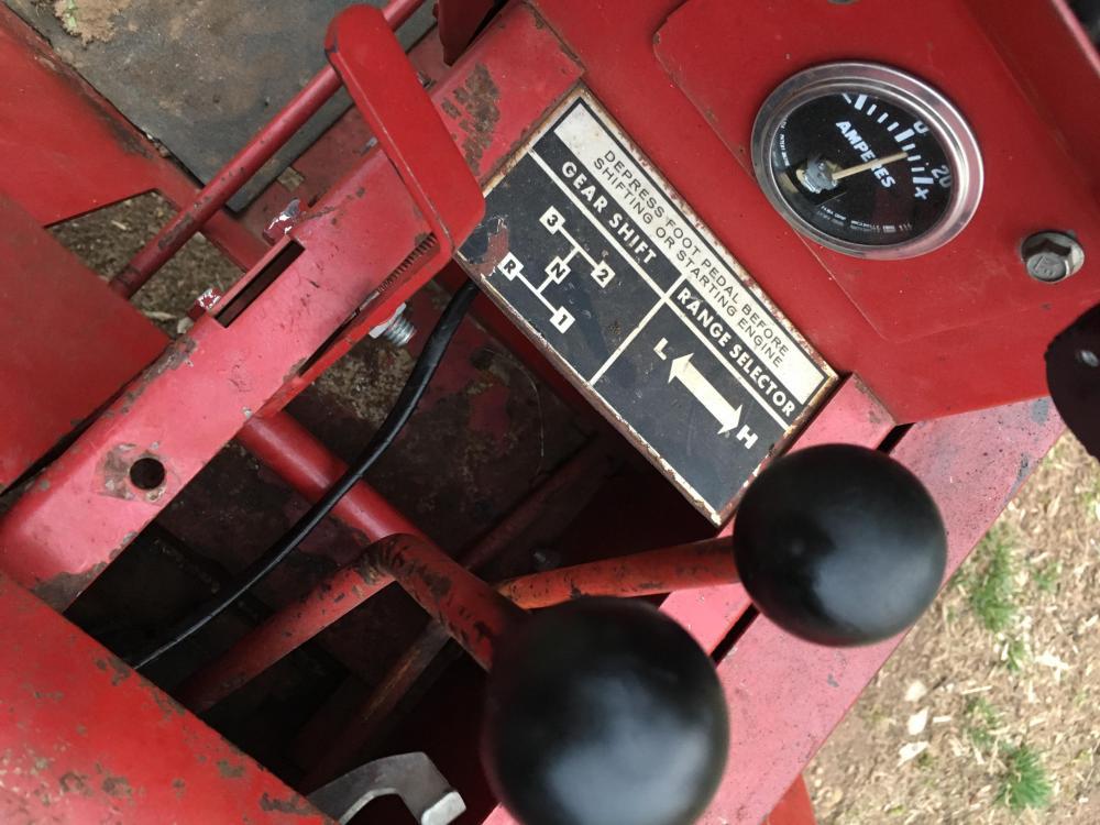

Deadguy 864 #4 Posted April 15, 2017 What about the factory 8 speed operation decal on the frame, that appears to have a patina matching the rest of the tractor? 2 Share this post Link to post Share on other sites

Deadguy 864 #6 Posted April 15, 2017 Ok. All the paint fading matches exactly. If this was changed to an 8 speed, it was done shortly after it left the factory. I wonder if the dealer did it for a customer who wanted it that way? 1 Share this post Link to post Share on other sites
rmaynard 17,579 #7 Posted April 15, 2017 No matter the case, I really like the layout of the shifter area. I have always disliked the "H" pattern shift plate that gets bent and carves grooves into the shifter. 1 Share this post Link to post Share on other sites

rmaynard 17,579 #10 Posted April 15, 2017 I little more research reveals that the Raider 6/8-speeds had that shift decal. So because the ID tag indicates that the base tractor is a 1975 B-80 4-speed, and the wear marks on the hoodstand assembly show that speed nuts had once been attached to hold the "H" pattern plate, my conclusion is that a transmission and decal from a Raider was transplanted either at the dealer or by an owner. Just my 2 Share this post Link to post Share on other sites
