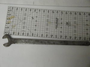

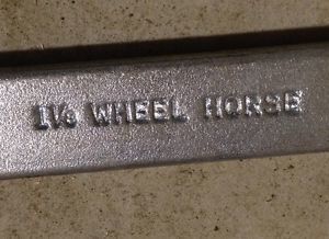

GlenPettit 1,719 #7 Posted April 12, 2017 (edited) Wheel Horse made a special wrench for those 11/8" nuts: I always use them, I have two, one for use behind the blade on the nut there to hold the spindle securely, and the other wrench on the outside bottom nut, they are 18" long for lots of leverage, and thin enough head to fit behind the blade. There are two different sellers with these wrenches available on eBay right now: Always use a thick grease on the threads so the nuts don't freeze up too tight during use ("grass juice" is like a corrosive glue). As the blade spins, it snugs up the nut tighter. These wrenches were given away free in the 80's with each tractor purchased. (A 6-point closed-end wrench on the outside would be a lot safer and more secure, with a long handle -- or just purchase a 11/8" socket if you have a 1/2" drive set). Edited April 12, 2017 by GlenPettit 3 Share this post Link to post Share on other sites

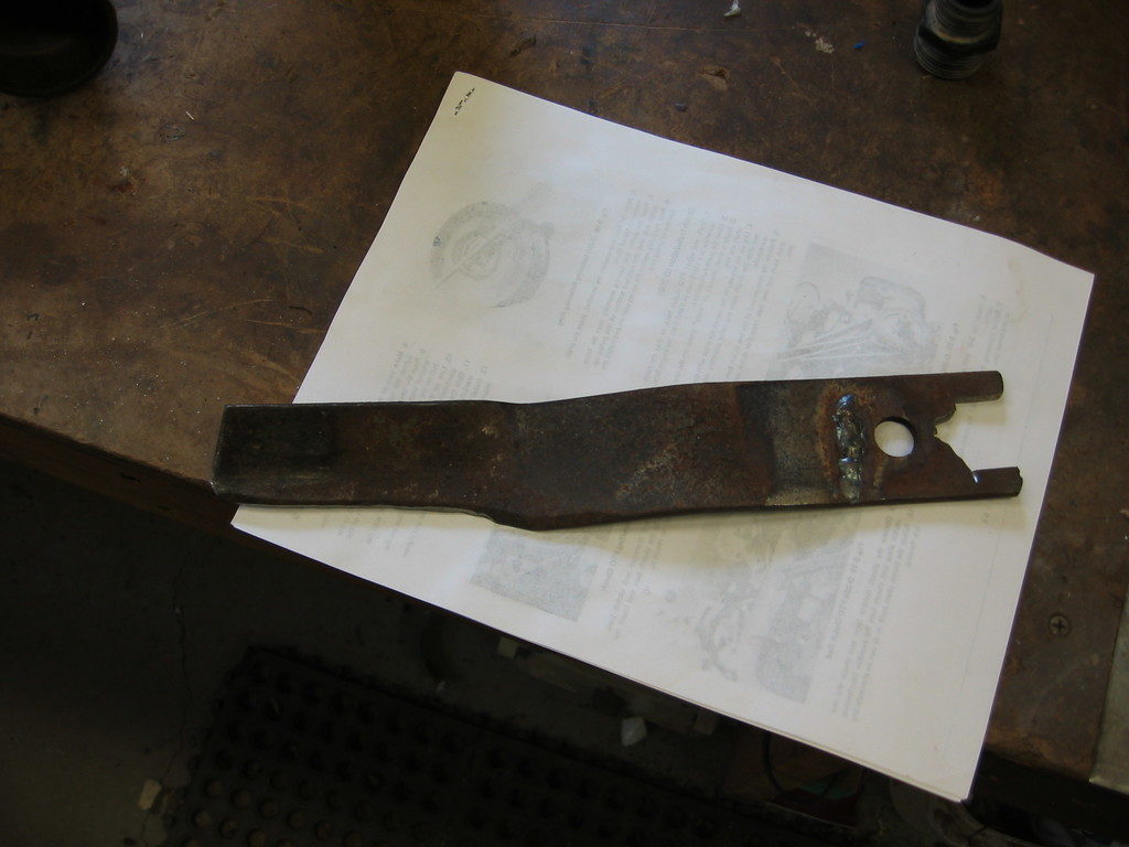

can whlvr 994 #13 Posted April 14, 2017 I too made a wrench for the back(spindle side)out of an old blade Share this post Link to post Share on other sites
