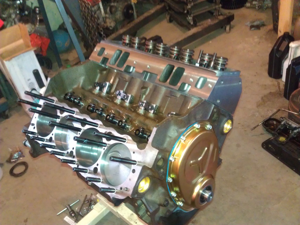

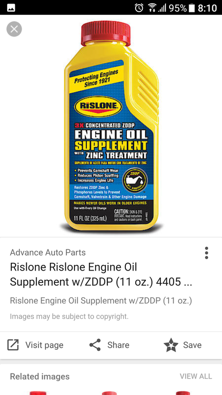

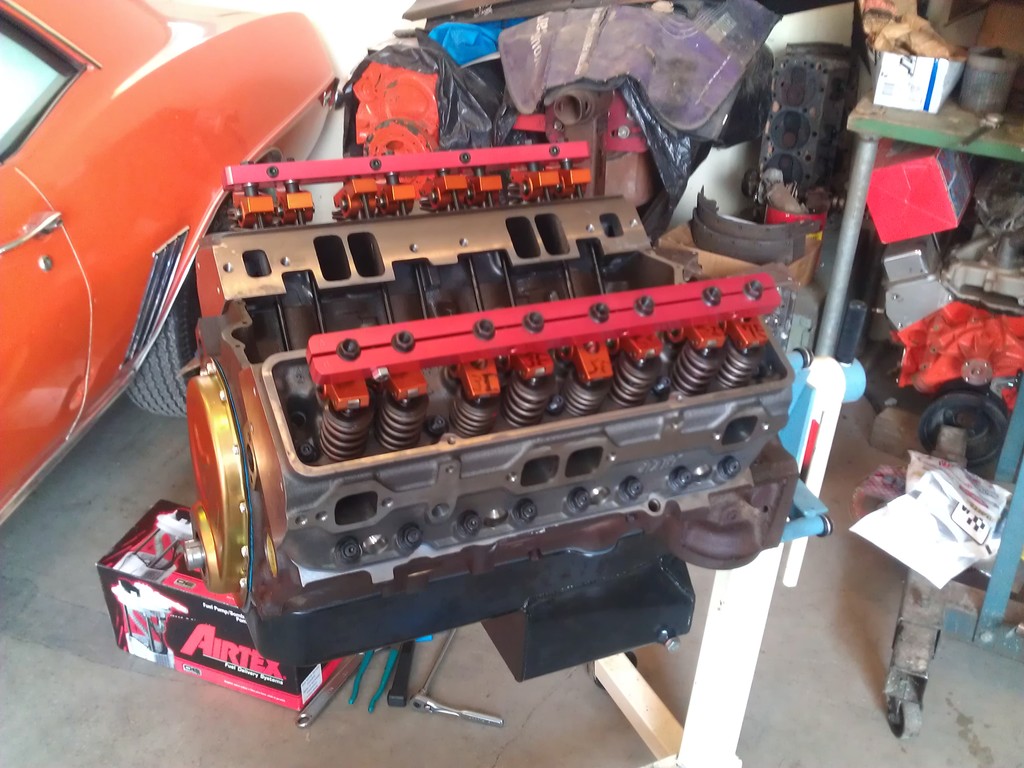

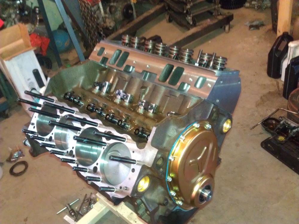

WVHillbilly520H 10,378 #30 Posted April 14, 2017 1 hour ago, 6bg6ga said: The lead went out of gas in the late 70's. It was available but at select stations at least in my neck of the woods. The lead served to lubricate the valve guides and to slow down combustion. Since the small engines are low compression ( most around 6:00-1 ) you don't need to worry about its effects on anti knock. I would also not worry about your valve seats either. Also, since these engines aren't turning 6000-6500 RPM lesser octane gas is all you need. With respect to the 15% alcohol that will effect the carbs as it will work on the alloy and start it flaking off and clogging jets. The other problem will be the gaskets that weren't designed for the alcohol. I'm going to pull the caution flag out for a little while here. Be sure you don't use any additives when you've just finished rebuilding /re-ringing an engine until the rings have seated. The result of using SOME of these additives is the rings either won't seat or it will take a very long time t seat. When I built the SBC in my Malibu the only additive I used was in the oil (Risolone) to help with cam lobe break-in, 93 octane mixed with 110 octane racing fuel but my engine is 10.3-1CR iron headed solid roller forged flat tops and 'moly rings with a top RPM of 8500 and geared to spin at 3-3500 at 55-60 mph, if one built this without the hardened valve seats then yes you would need the lead substitute, but our little single and twins at 6-8.1 CR I don't think it's as harsh, Jeff 3 Share this post Link to post Share on other sites
WHX?? 55,345 #31 Posted April 14, 2017 That mill looks like it = lots of $$ Jeffrey! 2 Share this post Link to post Share on other sites
ACman 7,703 #32 Posted April 14, 2017 11 hours ago, WHX11 said: One does have to wonder if this might contribute to valve issues in the Onan's?? I'm sure heat has more to do with this problem , as it is the valve seat that comes loose...if my thinking is correct ? @WVHillbilly520H adding that zinc or using a break in oil is the way to go to properly break in a engine ! I know this is a forum for wheel horse tractors but you should definitely do a thread on your Malibu . Are you also holding out on use...couldn't believe my eyes when I seen that Hugger Orange 69 Camaro sitting behind your beautiful engine . 1 Share this post Link to post Share on other sites

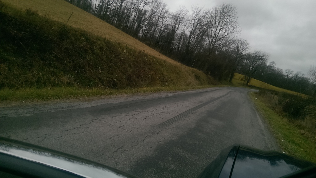

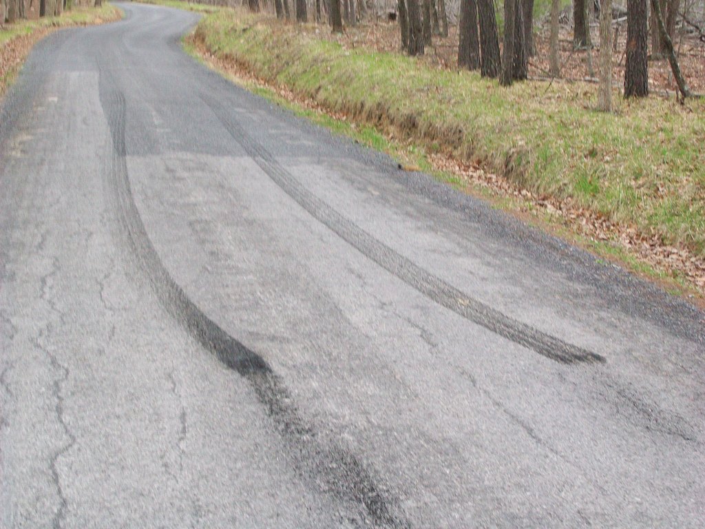

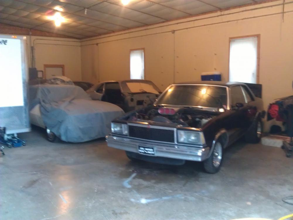

WVHillbilly520H 10,378 #33 Posted April 14, 2017 @WHX11, oh a lil bit north of $6k in parts and machining, all the hard labor done by me so if she blows it's all my fault I guess tackling an Onan after that would be a cake walk @ACman, believe it or not after 4 years I've only put 20-25 miles on that beast, between work, kids, elderly parents and life in general really haven't had the time to fully tune and finish it up, and the Camaro is my buddy's where I put the engine together, oh and I know we like the burnout emoji so how about a pic of testing then we shall get back on topic , Jeff. 2 Share this post Link to post Share on other sites
