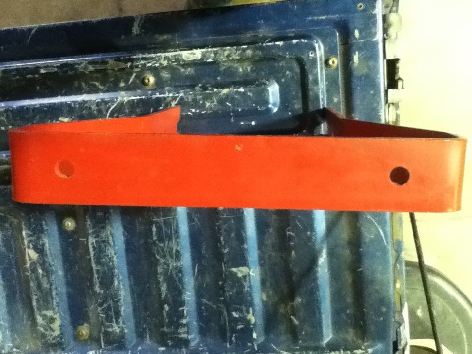

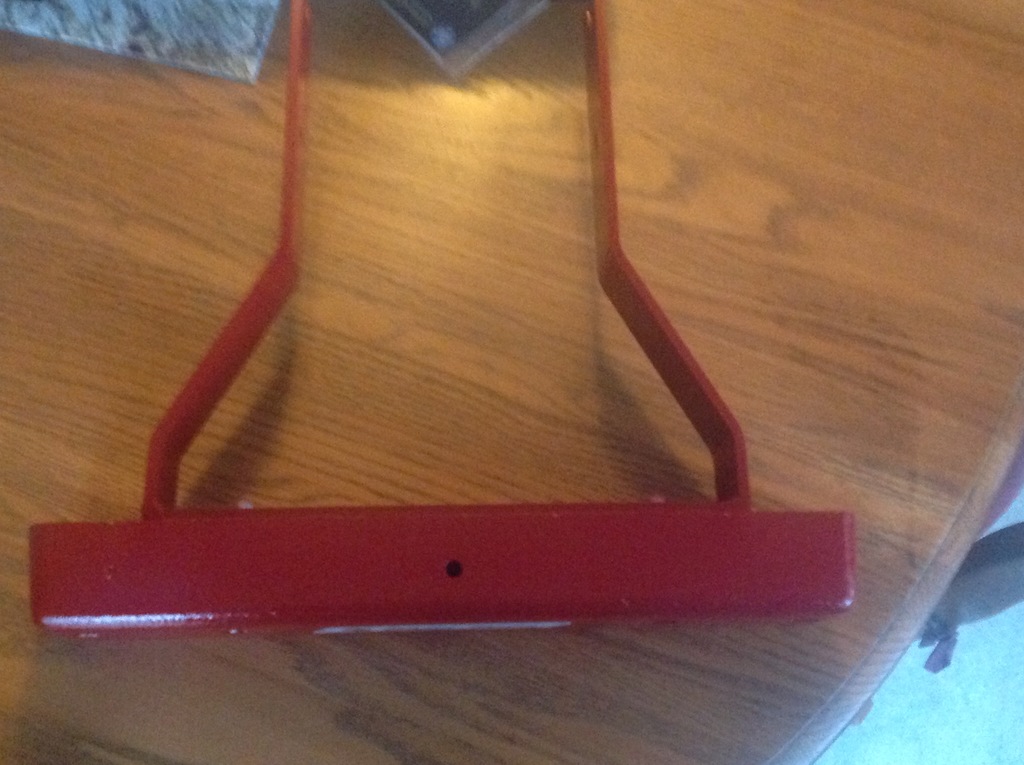

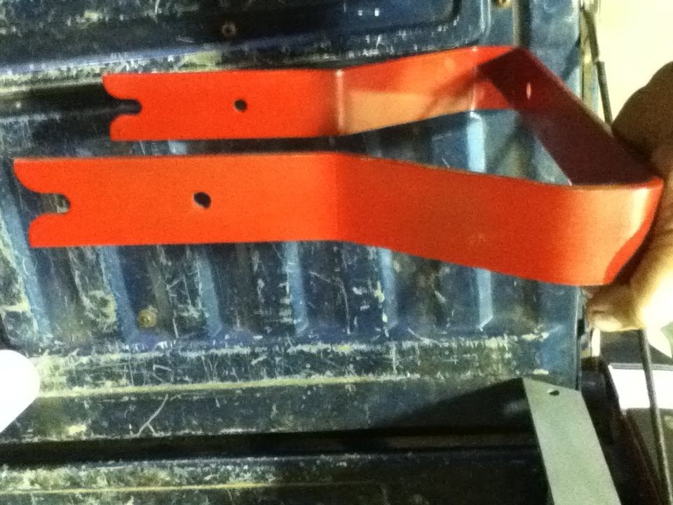

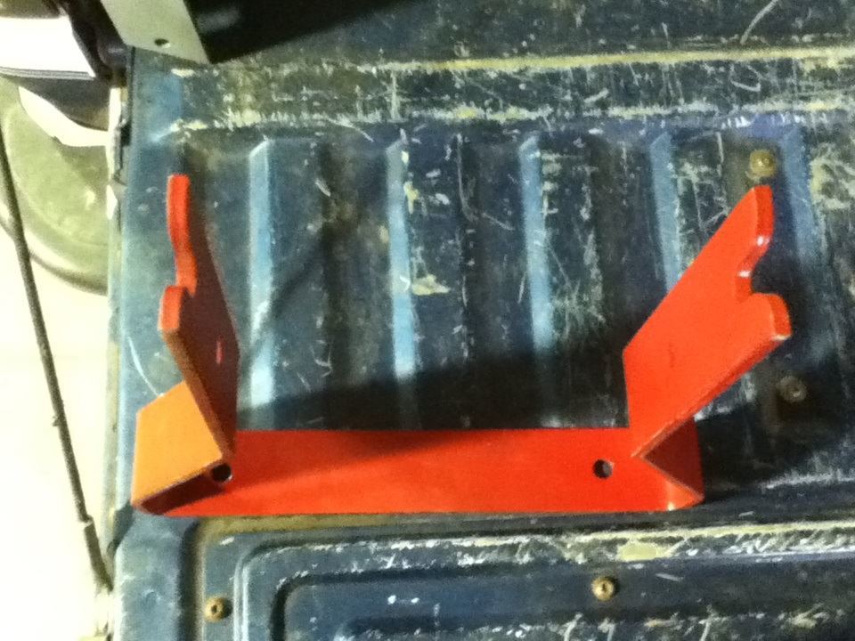

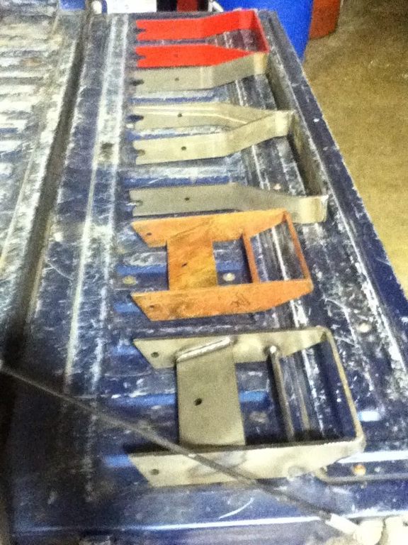

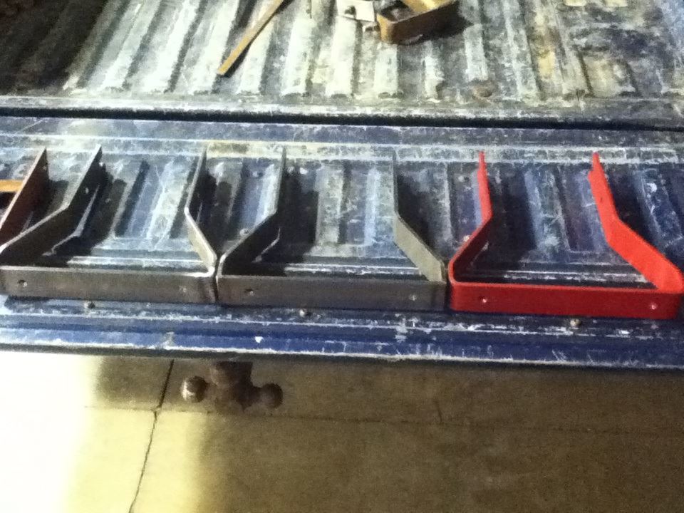

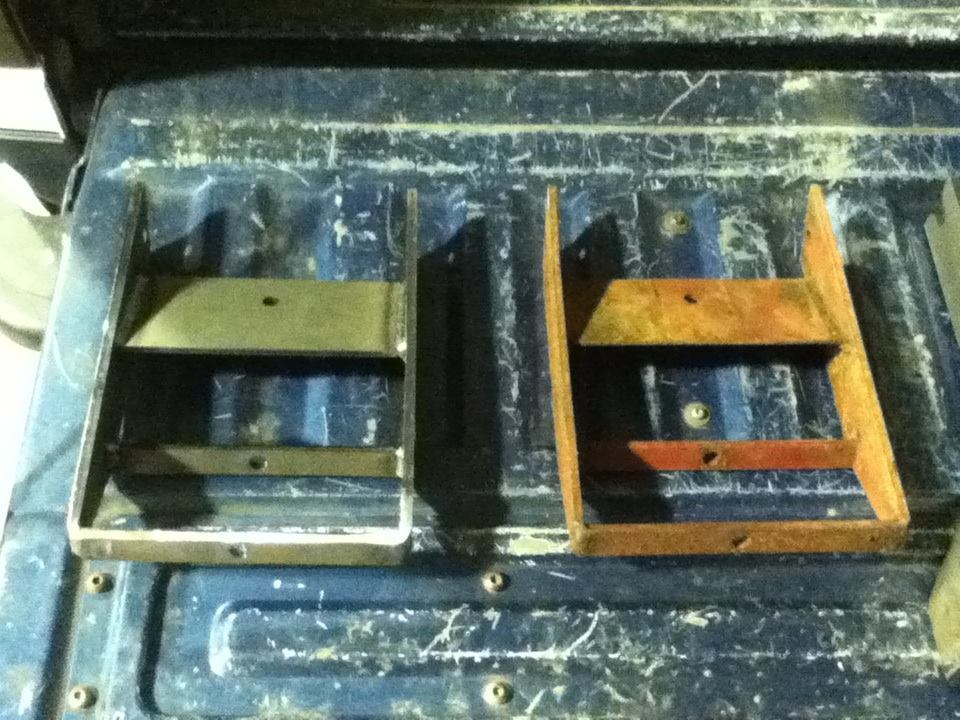

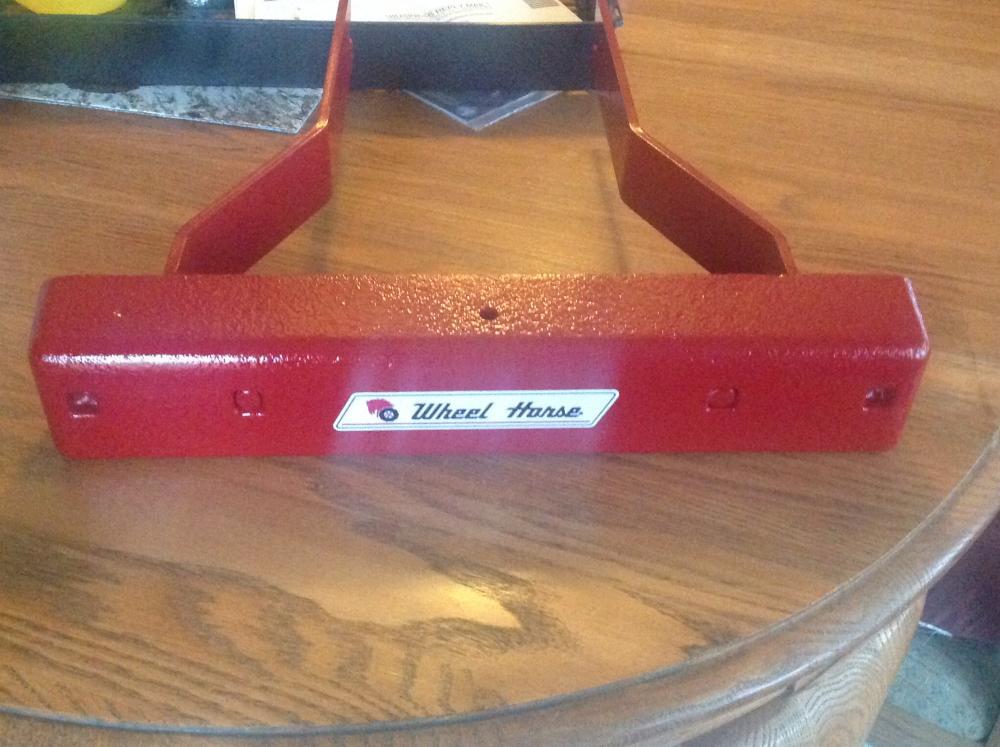

Adams94 1,066 #1 Posted April 11, 2017 Had some weight brackets made up, one is an RJ58 tombstone bracket and the others and a front weight kit bracket. Time for paint now, the front weight kit brackets will each be going on a c195 and the RJ bracket will be on dads RJ58 8 Share this post Link to post Share on other sites

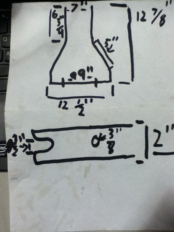

WVHillbilly520H 10,369 #2 Posted April 11, 2017 Cool deal, I have had a wanted ad in the classifieds for at the least the dimensions on the factory style front weight bracket like in your bottom picture for my 520s , any help would be appreciated here or PM, Thanks Jeff. 1 Share this post Link to post Share on other sites
Adams94 1,066 #3 Posted April 11, 2017 (edited) 2 hours ago, WVHillbilly520H said: Cool deal, I have had a wanted ad in the classifieds for at the least the dimensions on the factory style front weight bracket like in your bottom picture for my 520s , any help would be appreciated here or PM, Thanks Jeff. I have not got a bill for the ones I had made yet but when I do I can let you know, I have a call in about the price, may know by end of day. t Edited April 11, 2017 by Adams94 2 Share this post Link to post Share on other sites

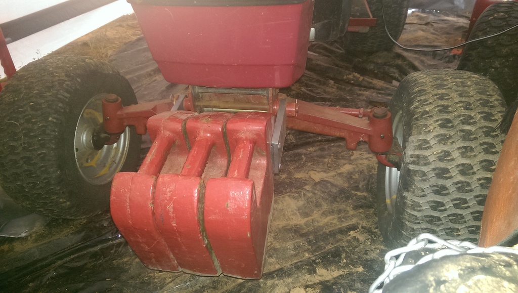

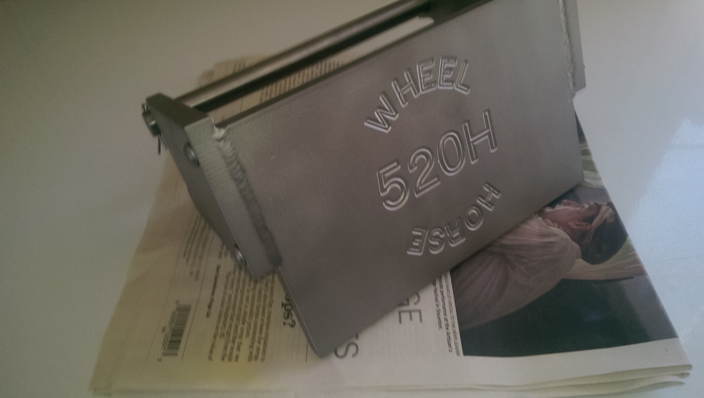

WVHillbilly520H 10,369 #4 Posted April 11, 2017 @Adams94, thanks all I needed were the dimensions as I can fab 1 up where I work, just didn't want to go into it too blindly, here's the ones I made for plowing ect to hang suitcase weights on, again thanks Jeff. 5 Share this post Link to post Share on other sites

elcamino/wheelhorse 9,148 #6 Posted April 11, 2017 @WVHillbilly520H Jeff how much weigh does your bracket hold? 2 Share this post Link to post Share on other sites
WVHillbilly520H 10,369 #7 Posted April 11, 2017 1 hour ago, elcamino/wheelhorse said: @WVHillbilly520H Jeff how much weigh does your bracket hold? 3 40+ pound weights 125ish total. Share this post Link to post Share on other sites
elcamino/wheelhorse 9,148 #8 Posted April 11, 2017 Thanks 1 Share this post Link to post Share on other sites

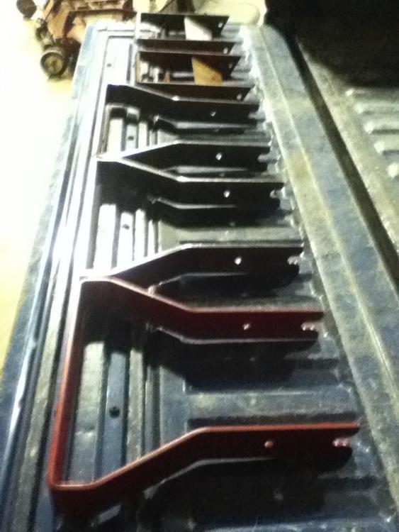

Adams94 1,066 #9 Posted May 2, 2017 Got the front weight painted and bolted to the bracket. Ready to mount on the c-195 1 Share this post Link to post Share on other sites
