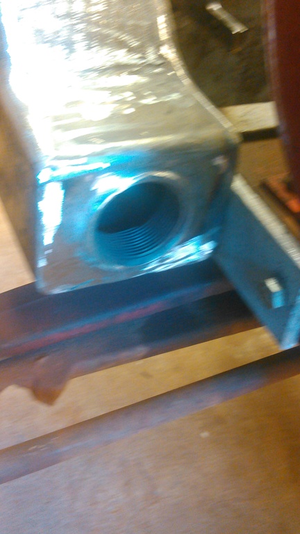

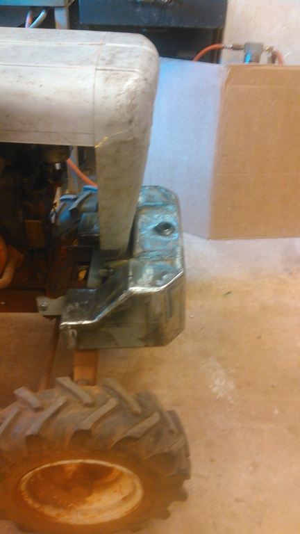

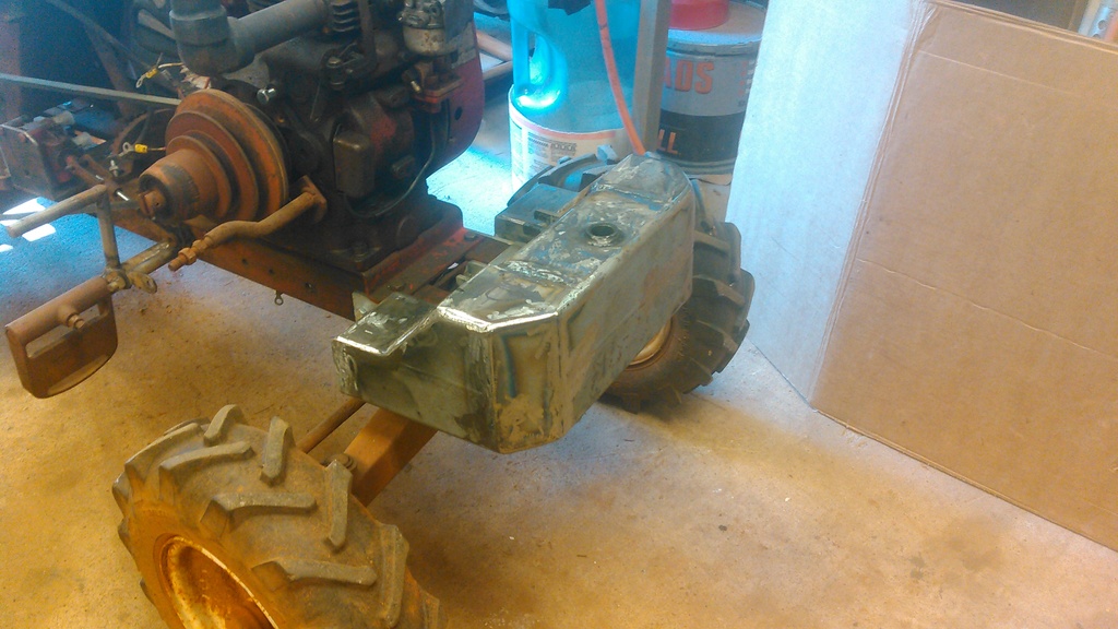

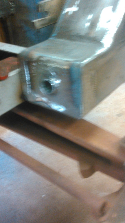

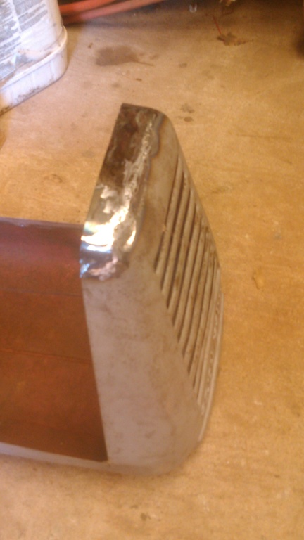

JPWH 6,544 #31 Posted May 14, 2017 I made a little progress this week. New piece welded on the hood. Got the tank welded up. I have to make another hood extension, came up 3/4" short. Had to cut off the pump bracket. What I get for not thinking ahead far enough. lol 4 Share this post Link to post Share on other sites

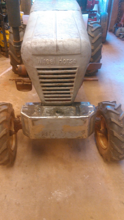

JPWH 6,544 #37 Posted May 15, 2017 The hood mounted to the bumper / tank. 5 1 Share this post Link to post Share on other sites

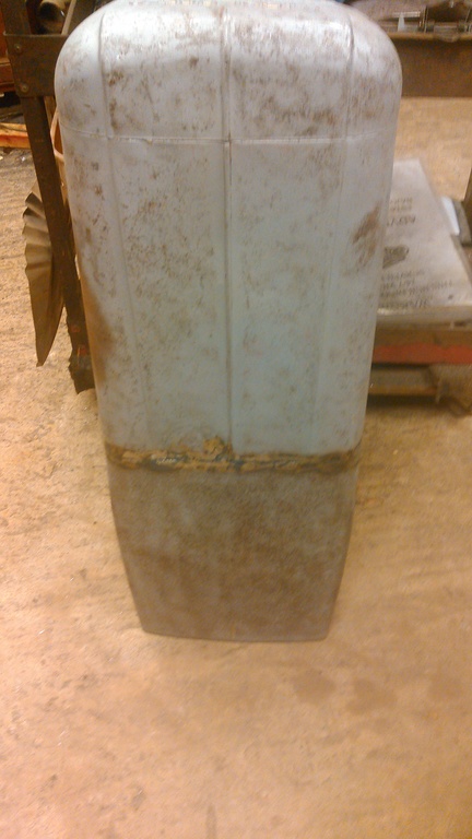

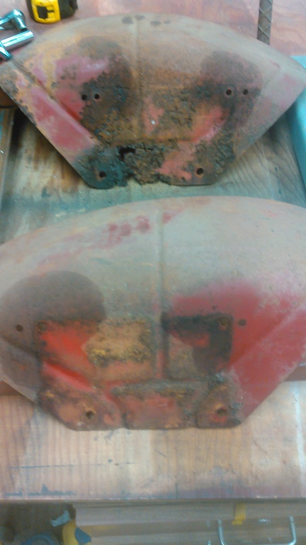

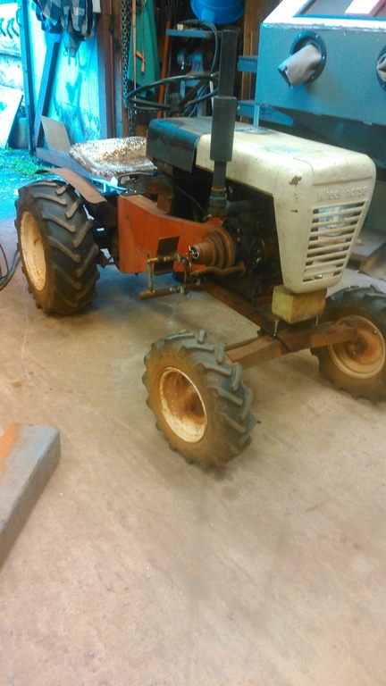

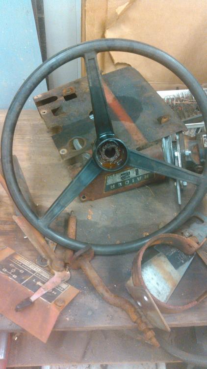

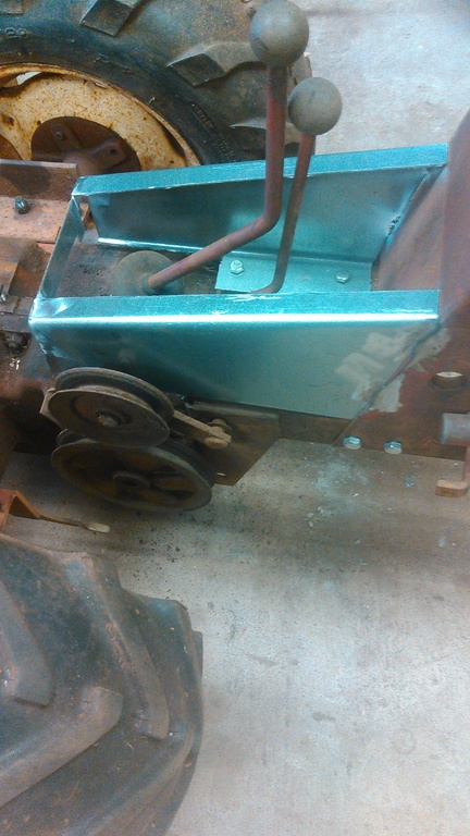

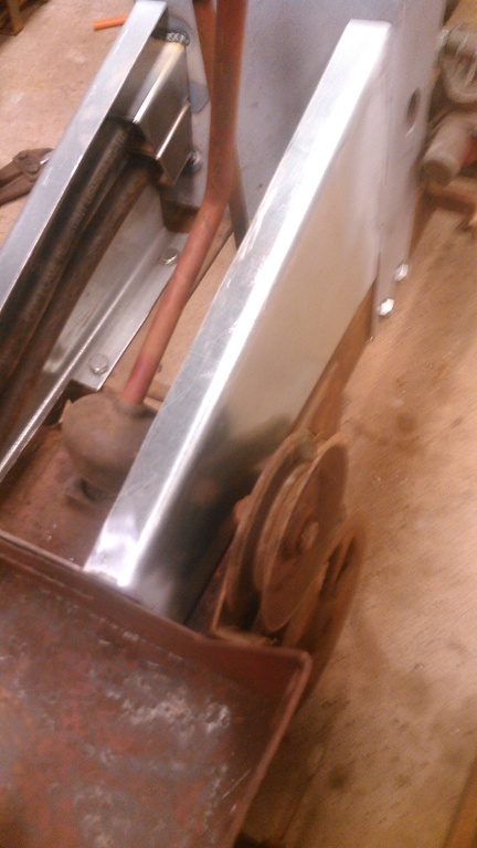

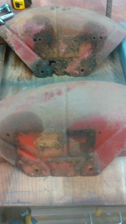

JPWH 6,544 #42 Posted May 21, 2017 I corrected my error on the hood length and got it welded together. Steering wheel and some other parts off. New panels made. I have my work cut out for me to use this set of fenders. But I think it is better than throwing them away. Found out why all the washers at the steering console. 4 Share this post Link to post Share on other sites

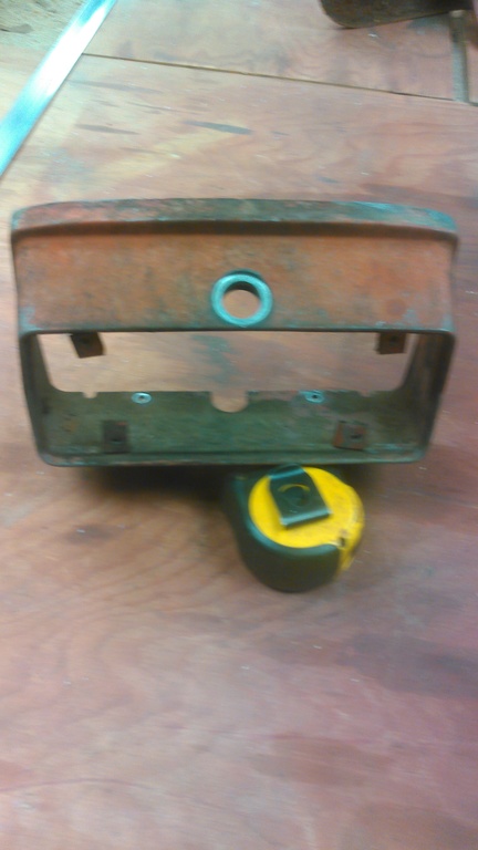

JPWH 6,544 #43 Posted May 21, 2017 (edited) I had to cut the steering shaft to remove the steering wheel, now i need to source a better dash console, build a new tool box that will be modified to house the cylinder hydraulic lines, and repair the fenders. My little homemade brake is not long enough to make the belt guard so I'll have to go visit my friend at the sheet metal shop. Edited May 21, 2017 by JPWH 2 Share this post Link to post Share on other sites

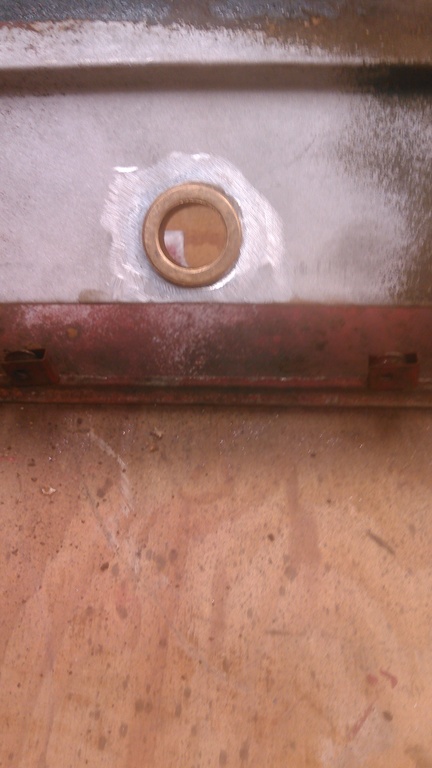

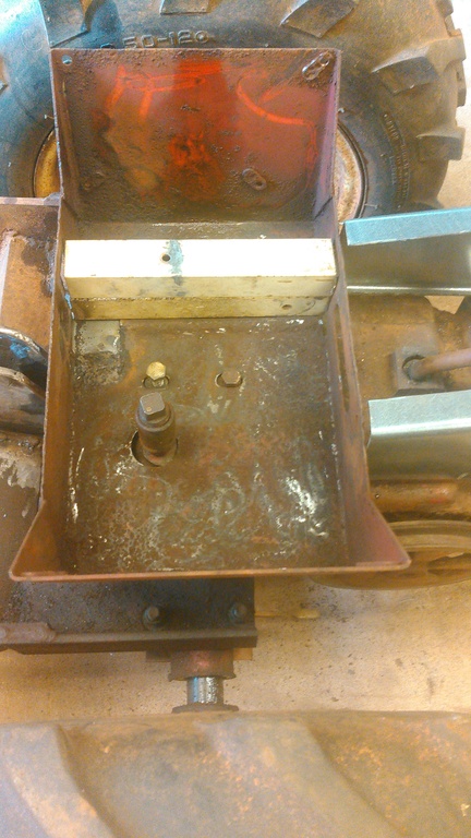

JPWH 6,544 #44 Posted May 21, 2017 I had some alumiweld I had bought to try. I was able to repair the dash console. The tool box was not as bad as I first thought. It is real rough but was able to modify it with a couple lengths of square tubing for the hydraulic hoses to pass through. 3 Share this post Link to post Share on other sites

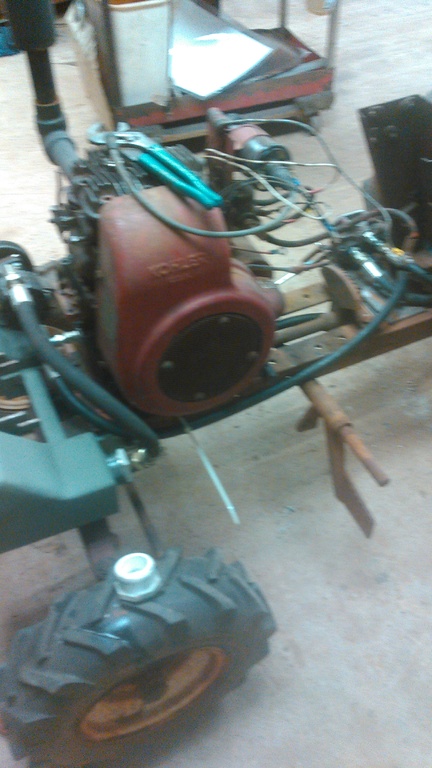

JPWH 6,544 #45 Posted May 27, 2017 A little welding and grinding. Then a check for hose routing to see what hoses and fittings are needed. I found a good fan gear but the shaft is two inches too short. May find the right one or the big show. 4 1 Share this post Link to post Share on other sites

JPWH 6,544 #47 Posted May 27, 2017 Thanks Aldon. The tank/bumper also serves as front weight @ 28 lbs. empty. 4x6x3/16 tube steel. 1 Share this post Link to post Share on other sites

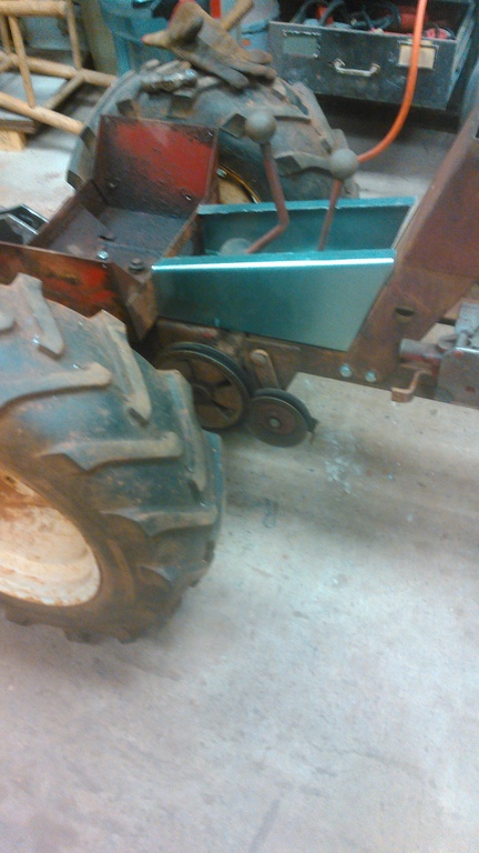

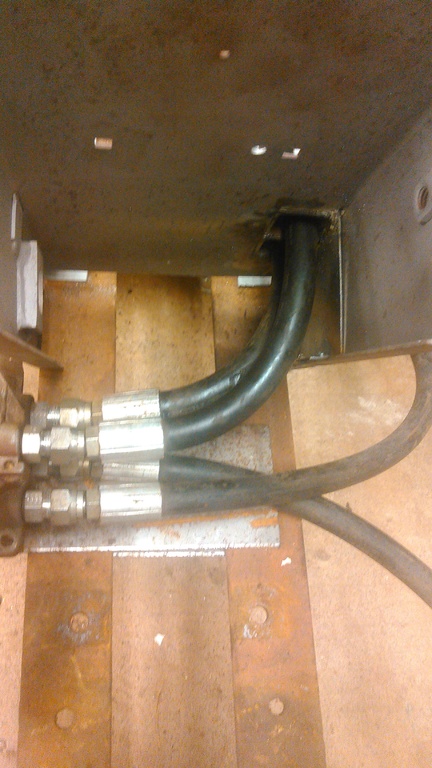

JPWH 6,544 #50 Posted May 28, 2017 I spent most of the day doing yard work but still had time to figure out the hose routing through the shifter tunnel. The connections are not the correct ports just worst case. 3 Share this post Link to post Share on other sites
