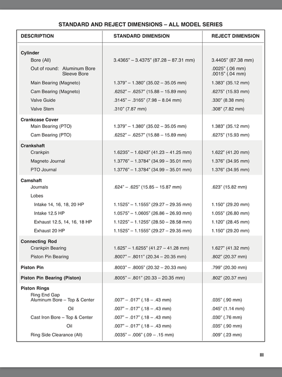

aHorseofCourse 261 #8 Posted March 31, 2017 Here's a decent looking one, small gouge where the oil seal rides on the long end tho. Might leak a bit. http://www.ebay.com/itm/Briggs-and-Stratton-18HP-Opposed-Twin-Cylinder-Engine-Crankshaft-690636-/192140923116?hash=item2cbc7dd0ec:g:3rkAAOSwdGFY2Hdw The verticle and horizontal cranks are the same. You have to ask him the model number and make sure it's a 42 cubic inch with ball bearing but it looks right. Does yours use a key or pin to line up the timing gear? Maybe he can mic the journals for you. Here are the specs. 1 Share this post Link to post Share on other sites

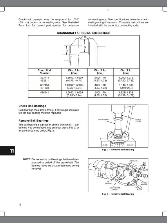

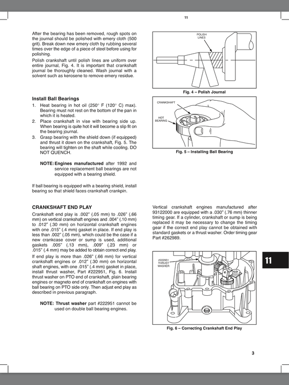

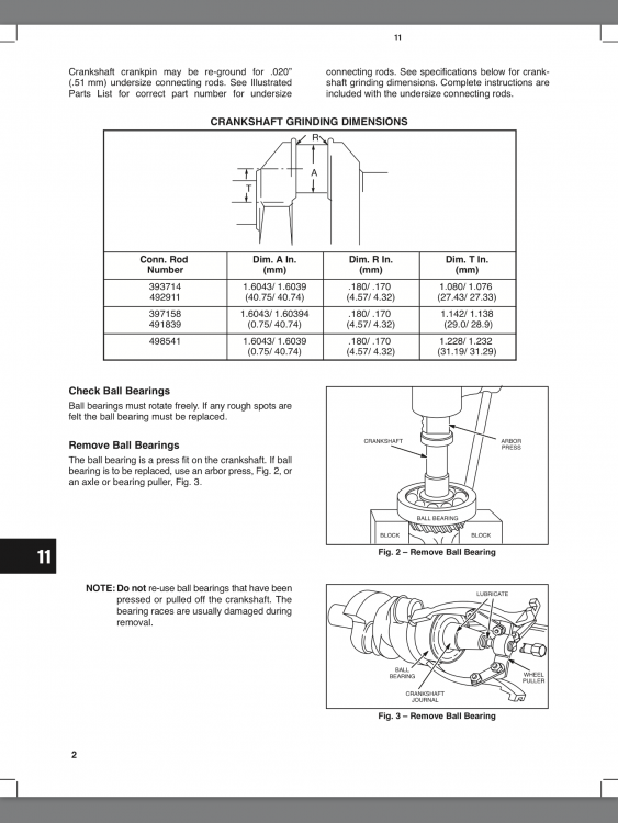

aHorseofCourse 261 #17 Posted April 1, 2017 I just looked up a bunch of other rare parts for these engines and according to their website they have them all. I gotta call Monday and see if this is really true. It's like striking gold! Here are some specs out of the service manual reguarding the crank. Make sure the end play is right, it's a cause of rod failure. 1 Share this post Link to post Share on other sites
