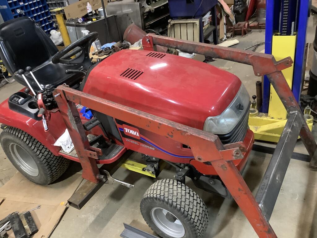

Pullstart 68,981 #151 Posted March 27, 2021 Looking at post 1 in this thread, I see that this loader came from a GT-14 originally. I could use that as an excuse to build that GT, or just keep going on the Xi. Xi it is! Here is a picture copied from Duke, post #1. 1 Share this post Link to post Share on other sites

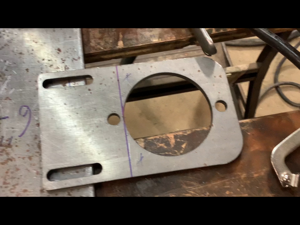

Pullstart 68,981 #155 Posted March 29, 2021 Found the jump drive! Looking through pictures, I realized quick that some of the gussets need to be added still to the bucket brackets. Share this post Link to post Share on other sites

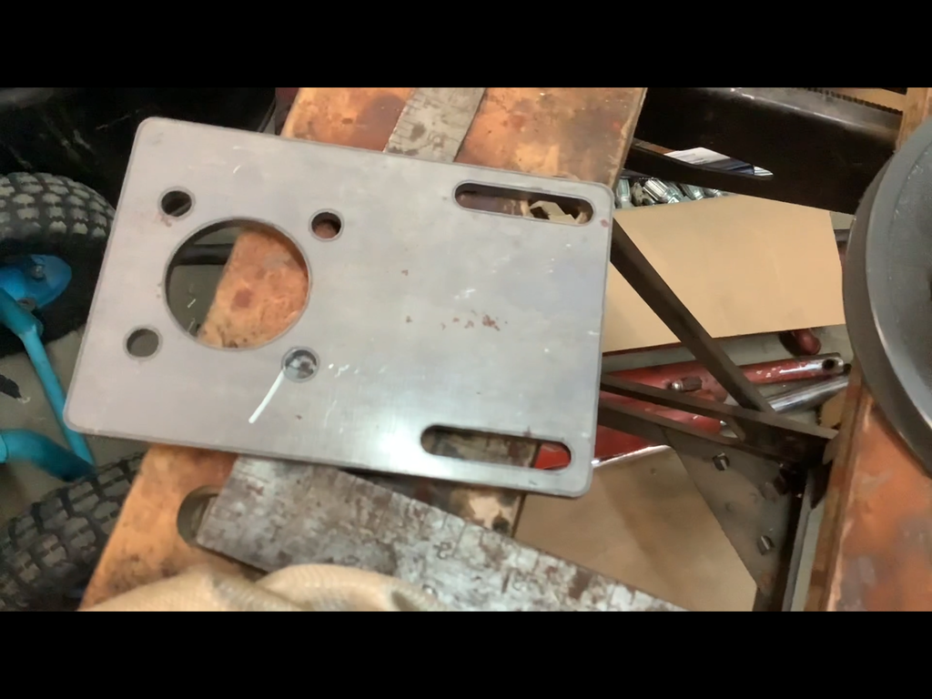

Pullstart 68,981 #156 Posted March 29, 2021 (edited) Before I cut the plates, I figured I’d ask. @JoeM @Shynon Does the plate with the large hole look like it could bolt up to the front of the engine? @HorseFixer Duke, if you see this... any insight on the big hole plate? Edited March 29, 2021 by pullstart Calling Duke Share this post Link to post Share on other sites
JoeM 9,650 #157 Posted March 29, 2021 Kevin I think it is for a different configured pump. Something older style with a larger mounting flange.?? This was the OE pump bracket I used. 1 1 1 Share this post Link to post Share on other sites
Pullstart 68,981 #158 Posted March 29, 2021 @JoeM thanks for the pics! In your build I see you mentioned that the engine is tilted back. I’ll be sure to measure that before I finish the brackets! 1 Share this post Link to post Share on other sites
Shynon 7,544 #159 Posted March 29, 2021 11 hours ago, JoeM said: Kevin I think it is for a different configured pump. Something older style with a larger mounting flange Share this post Link to post Share on other sites

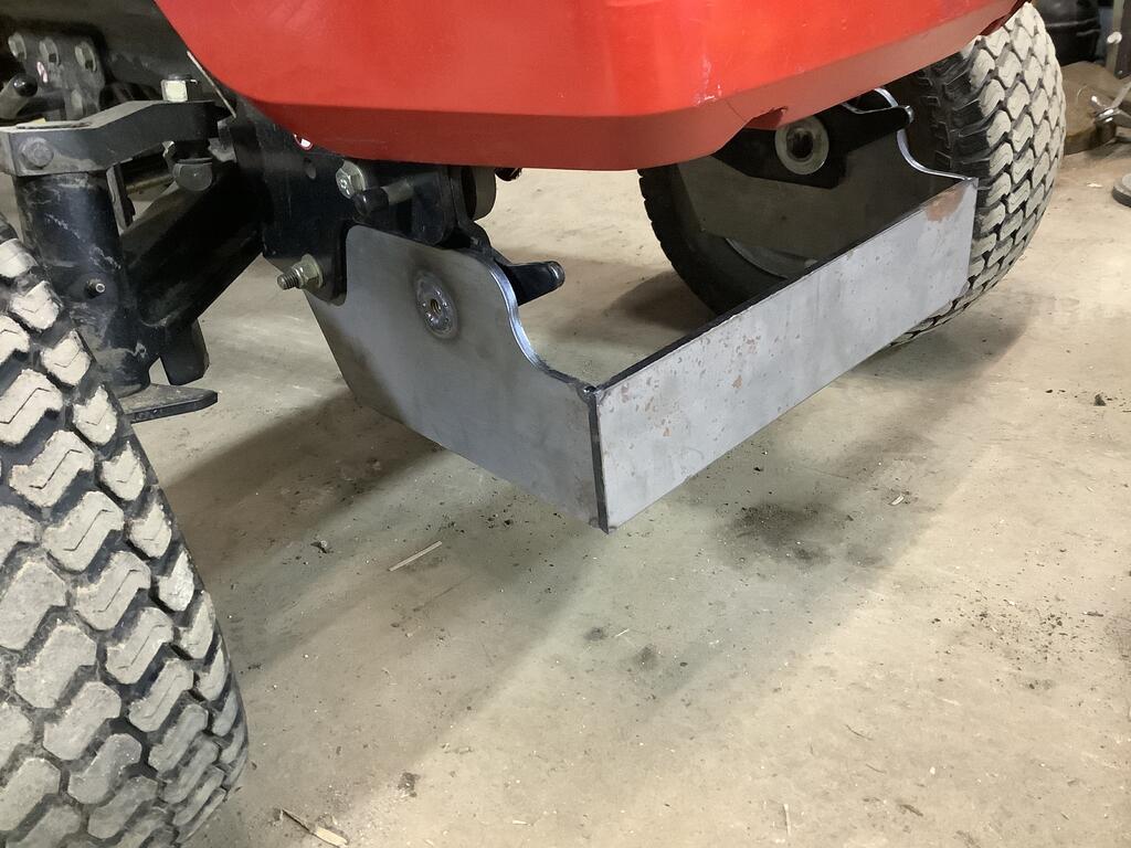

Pullstart 68,981 #160 Posted March 30, 2021 (edited) The mule/pump mount is finished welding! Time to deburr it, splash some paint and move on! Edited March 30, 2021 by pullstart Pictures 4 Share this post Link to post Share on other sites
Shynon 7,544 #161 Posted March 31, 2021 3 hours ago, pullstart said: The mule/pump mount is finished welding! Time to deburr it, splash some paint and move on! I could be wrong but I'm thinking your gonna have to remove material in front of that bracket for the pump pulley. Share this post Link to post Share on other sites
Pullstart 68,981 #162 Posted March 31, 2021 29 minutes ago, Shynon said: I could be wrong but I'm thinking your gonna have to remove material in front of that bracket for the pump pulley. I thought about that, but decided to leave it as a guard. I found a random belt that fits everything well, with room for adjustment. 2 Share this post Link to post Share on other sites

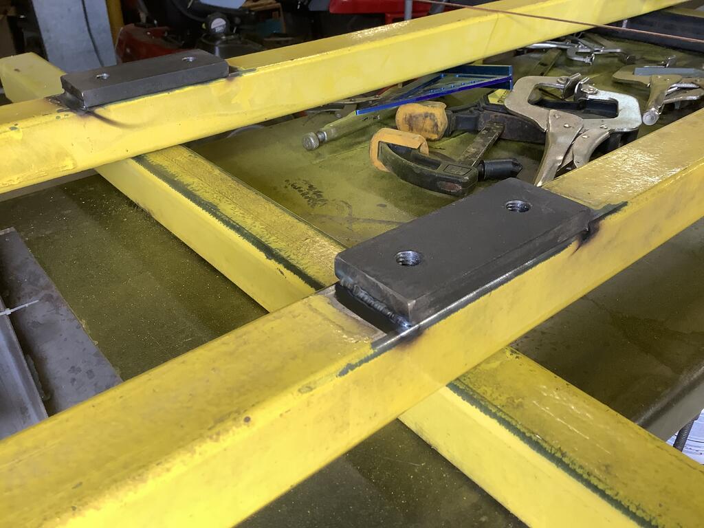

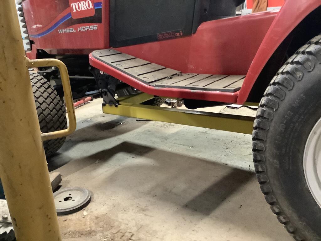

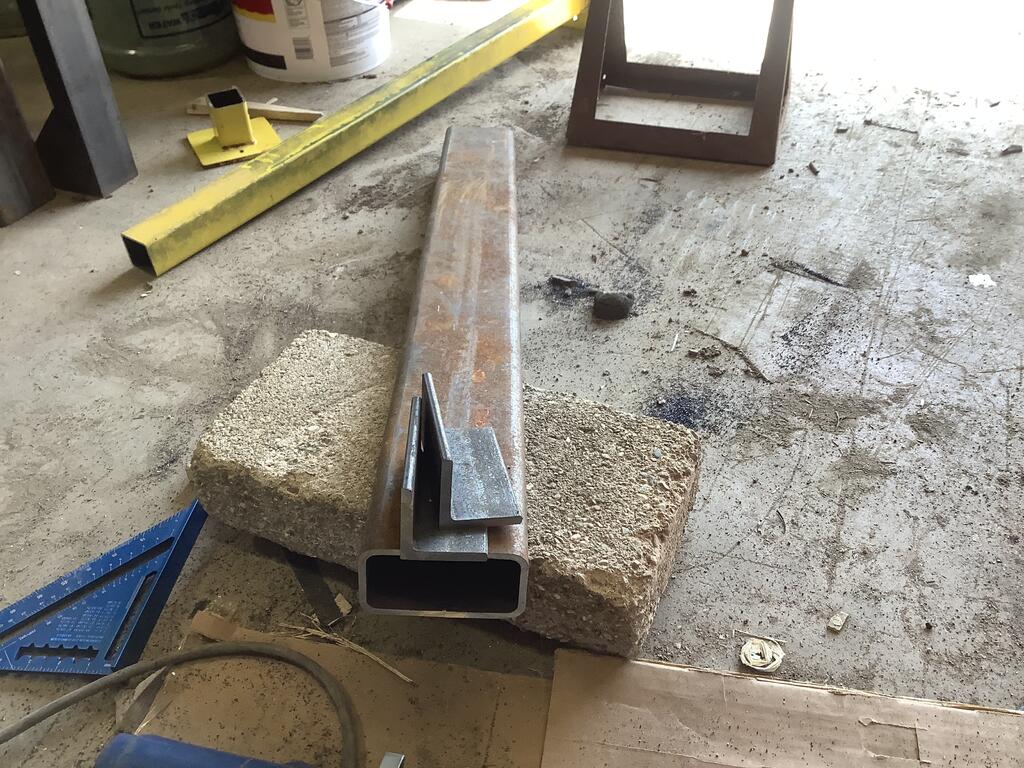

Pullstart 68,981 #164 Posted April 1, 2021 I found some tabs for the mid mount tach-a-matic and some repurpose materials to build the subframe... 1 Share this post Link to post Share on other sites

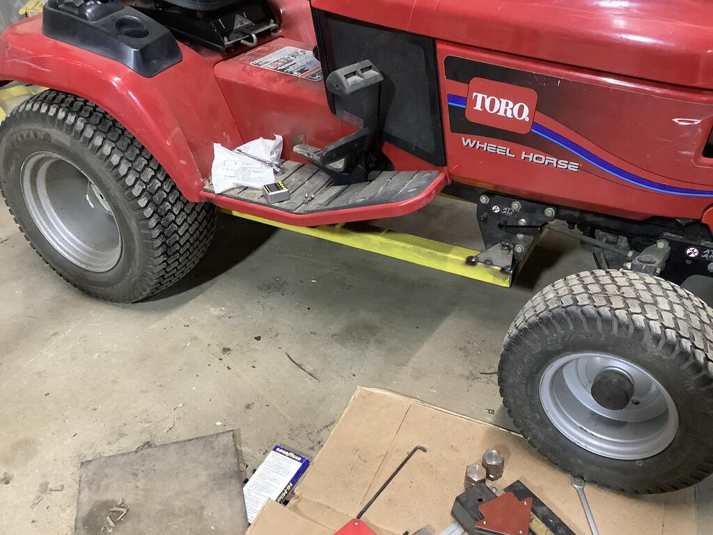

Pullstart 68,981 #165 Posted April 1, 2021 The front is tacked up. Now I’ll slide it under and see how it all looks. 3 Share this post Link to post Share on other sites
Pullstart 68,981 #166 Posted April 1, 2021 I like it! 6 Share this post Link to post Share on other sites

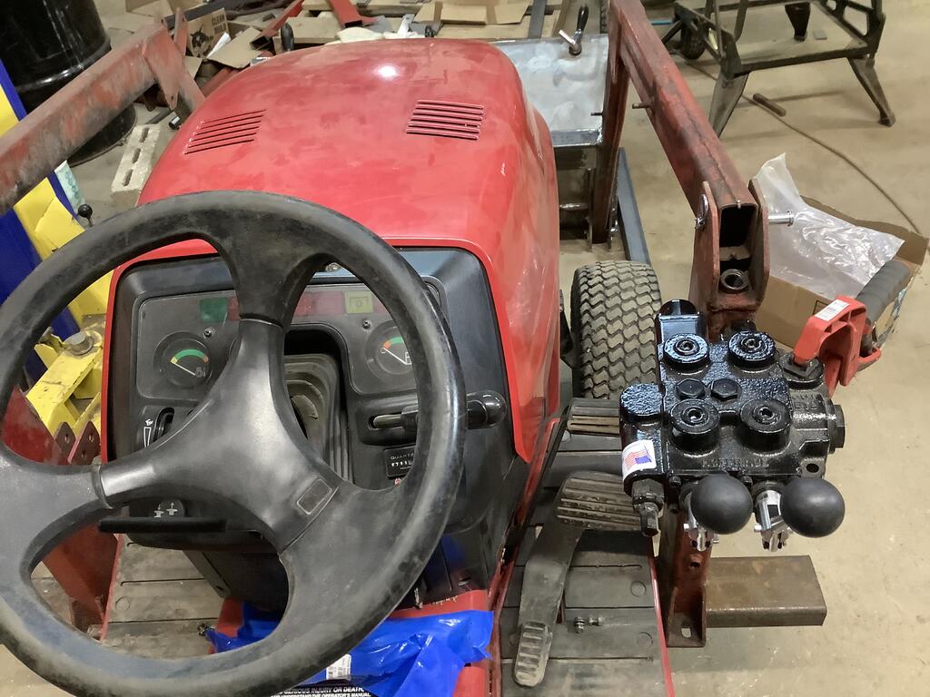

Pullstart 68,981 #167 Posted April 1, 2021 I think I have everything positioned to where I like. Overkill of a valve? Naw!!!! I’ll take a quick lunch break and see how much further I can get. 4 Share this post Link to post Share on other sites

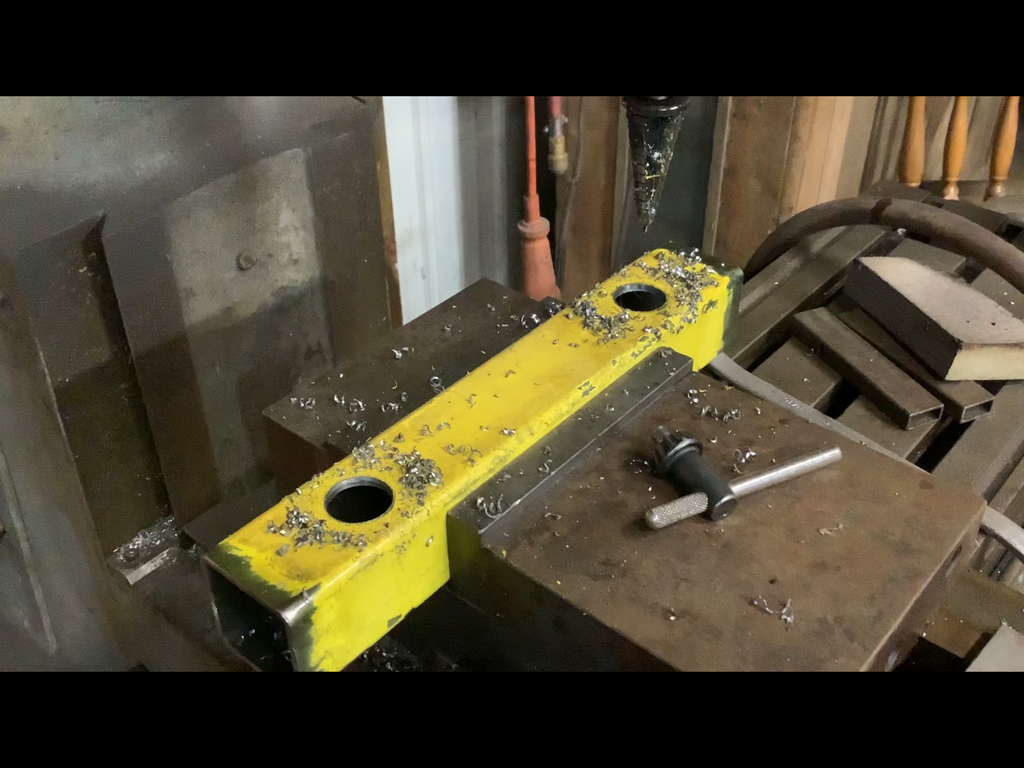

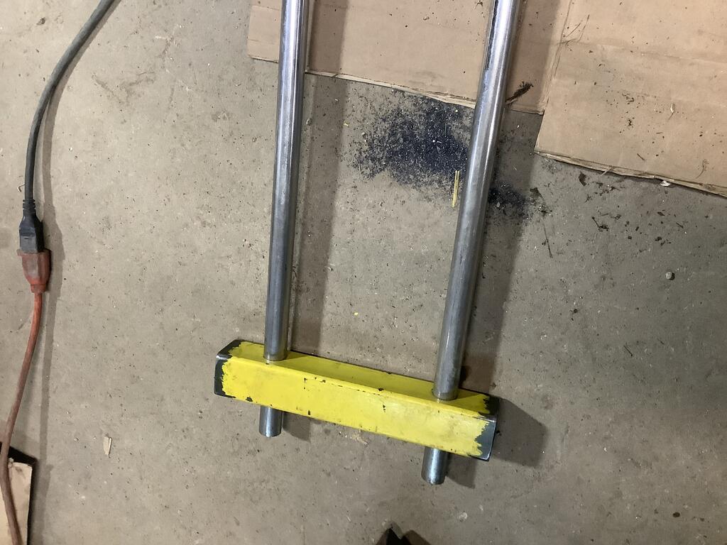

Pullstart 68,981 #168 Posted April 1, 2021 After measuring my upright location and width, it’s back on the bench. I cut and drilled some rear crossmembers. They will get this weight bench bar welded in for permanent weight holders. 1 2 Share this post Link to post Share on other sites

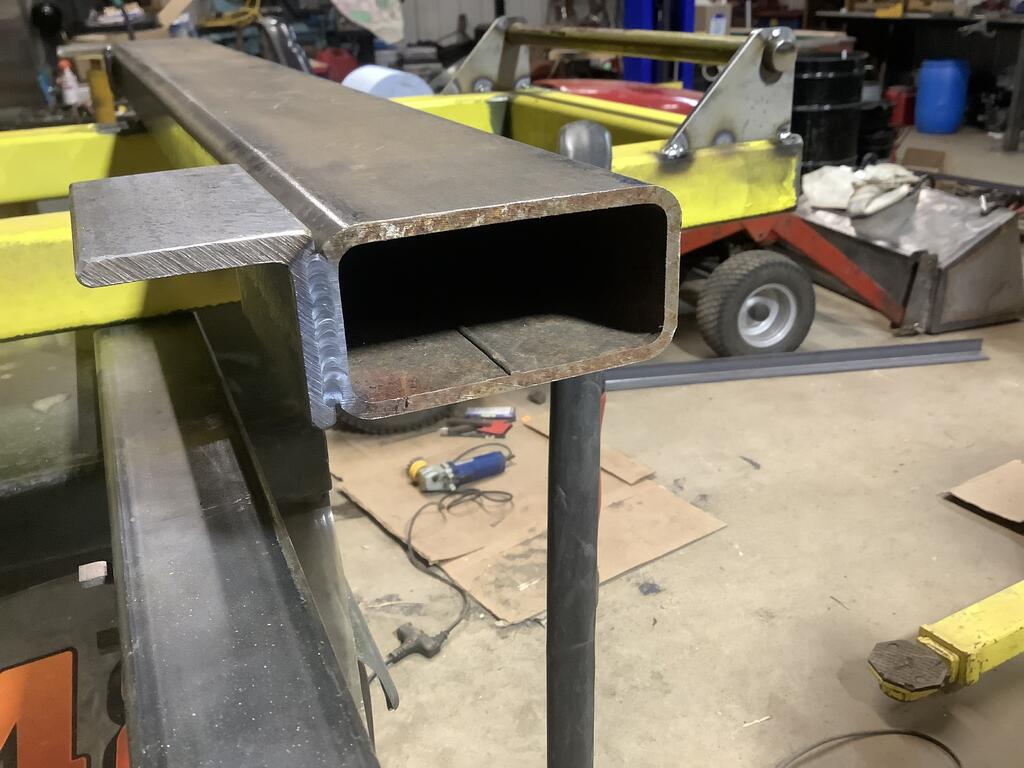

Pullstart 68,981 #169 Posted April 4, 2021 I have the second rear crossmember cut and drilled, the upright support cut to length and the angle iron tabs cut as well. Share this post Link to post Share on other sites

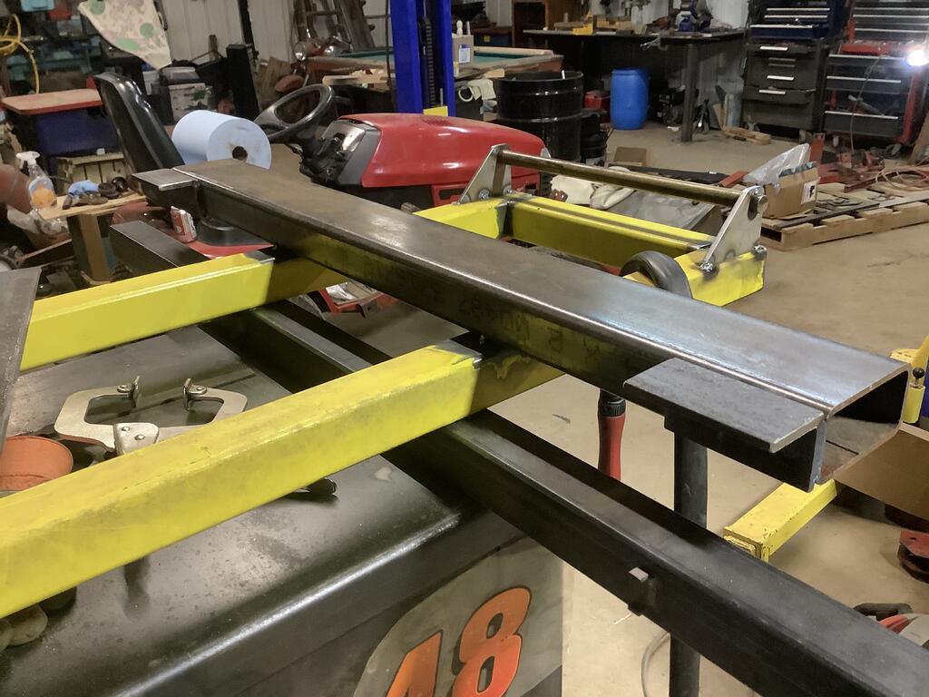

Pullstart 68,981 #170 Posted April 5, 2021 Rear crossmembers are tacked in. Time for the loader uprights support! 1 1 Share this post Link to post Share on other sites
Pullstart 68,981 #171 Posted April 5, 2021 The front crossmember is now in as well. 5 Share this post Link to post Share on other sites
