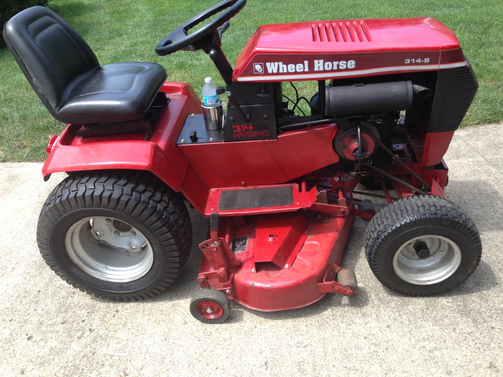

FatJackDurham 318 #1 Posted March 21, 2017 There is a Toro Wheel Horse 314 for sale in my area for $1500, including a mowing deck, rototiller and snow blower attachment. I was wondering if the Toro branded 314 is still a solid Wheel Horse or if that was already a corrupted model. The master model list shows a 314 from 1996-2001 I don't know what year this one is. I can't tell from the picture if it's a 314-8 or a 314-8. Thoughts? 2 Share this post Link to post Share on other sites
WHX?? 57,282 #2 Posted March 21, 2017 6 minutes ago, FatJackDurham said: the picture if it's a 314-8 or a 314-8. did you mean 314-H or 314-8?? A 314 is a fine tractor and will do most anything you ask of it. @PeacemakerJack has got a 314-8 set up for plowing and it's a beast. Get a picture up of it and we can PI (positively identify) it for you. Might not be the worst price pending condition it's in & hours. Serial # will nail down the year. 3 Share this post Link to post Share on other sites

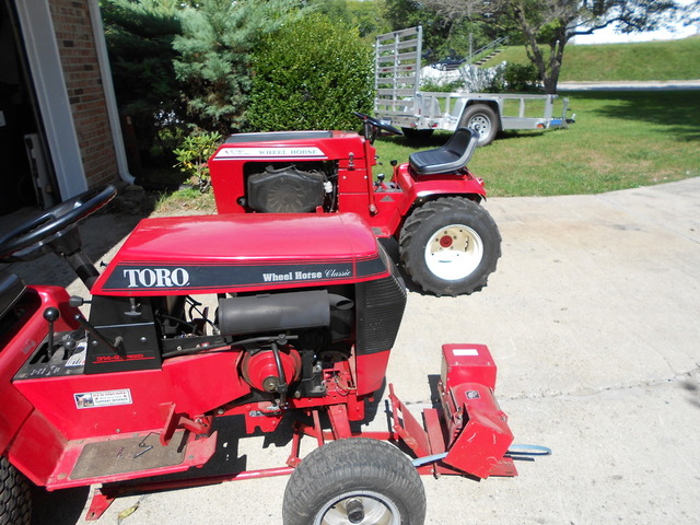

Lane Ranger 12,029 #3 Posted March 21, 2017 (edited) I like my 314 ! Great tractor! This is my brother's 314 Hydro with hydro lift . (hood was changed) Edited March 21, 2017 by Lane Ranger 9 Share this post Link to post Share on other sites

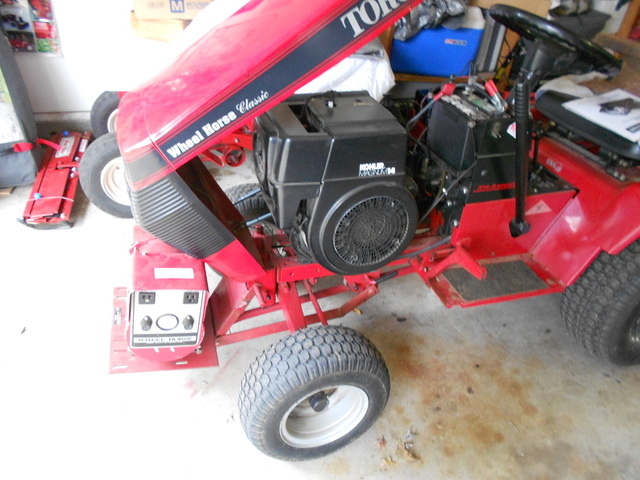

Ed Kennell 46,479 #5 Posted March 21, 2017 I believe the 314s were made in 1993 thru 2001. I have a 1995 312 Hydro and it is a great tractor. The only caution I would relate is , If it is a Hydro and does not have a hydraulic lift, it probably has the weaker Eaton 700. If it has the hyd. lift, it has the stronger Eaton 1100. Of course if it has the gear drive 8 speed, no problem. 2 Share this post Link to post Share on other sites
