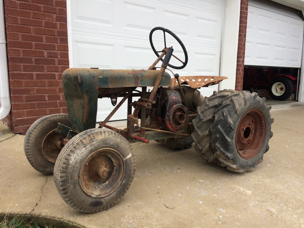

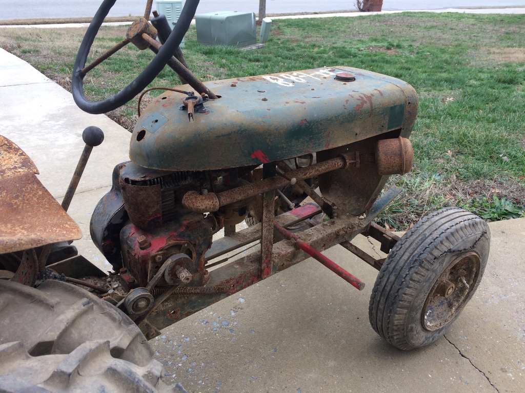

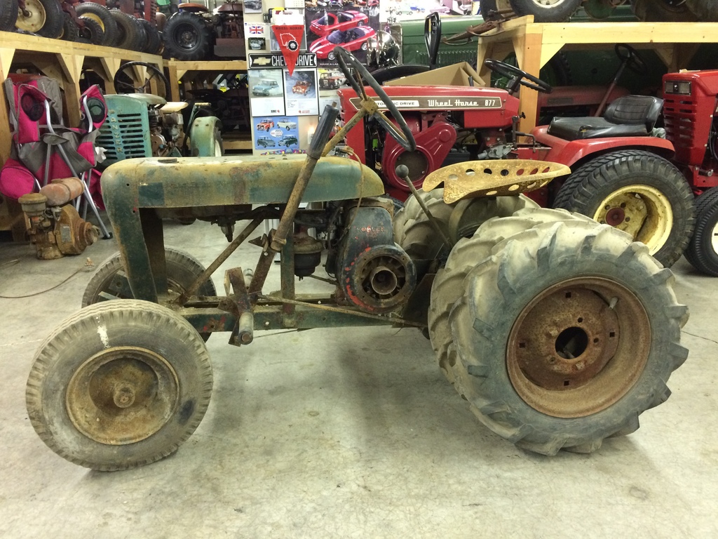

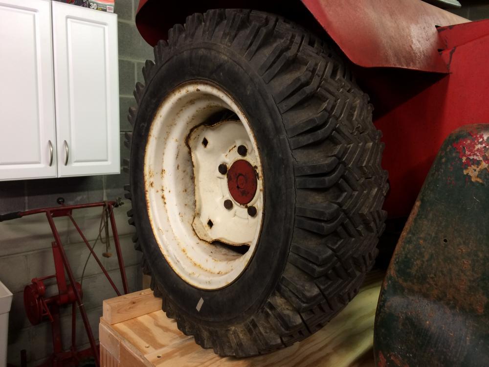

Gunny 257 #1 Posted March 19, 2017 All, Any idea what tractor these back wheels came on? I am thinking mid 60's, isn't that the timeframe WH went to the wider wheel?. Hood very close to an 857, has 3 speed tranny, and the wheels pictured below. The tractor is in pieces, no markings that we can find. Hopefully will be able to pull some numbers off the tranny this next week. A friend was given the tractor, in pieces. No Motor. This should prove to be entertaining, thought provoking, and of course......need more info. 1 Share this post Link to post Share on other sites
bmsgaffer 2,071 #4 Posted March 19, 2017 We will probably need pics of more parts than just the wheels... these guys are good, but theres only so much they can do... Share this post Link to post Share on other sites

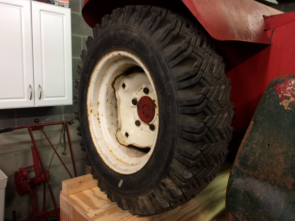

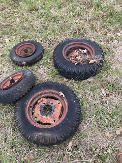

stevasaurus 23,884 #5 Posted March 19, 2017 Hi Gunny!! The bottom front tire is not Wheel Horse. The top front tire looks like it could be. The snow tires are round hood, not short frame square hood... You are correct that the wider tires are like 1965/1966/1967. I'm guessing the rear tires are 1962/1963/1964. The transmission will give you a casting number, but that is only worth something if the date is later then 1964. I'm thinking you have one of those Black Gold, Texas Tea, Ted Kruse horses. This wasn't featured in a George Bush painting, was it?? 1 Share this post Link to post Share on other sites

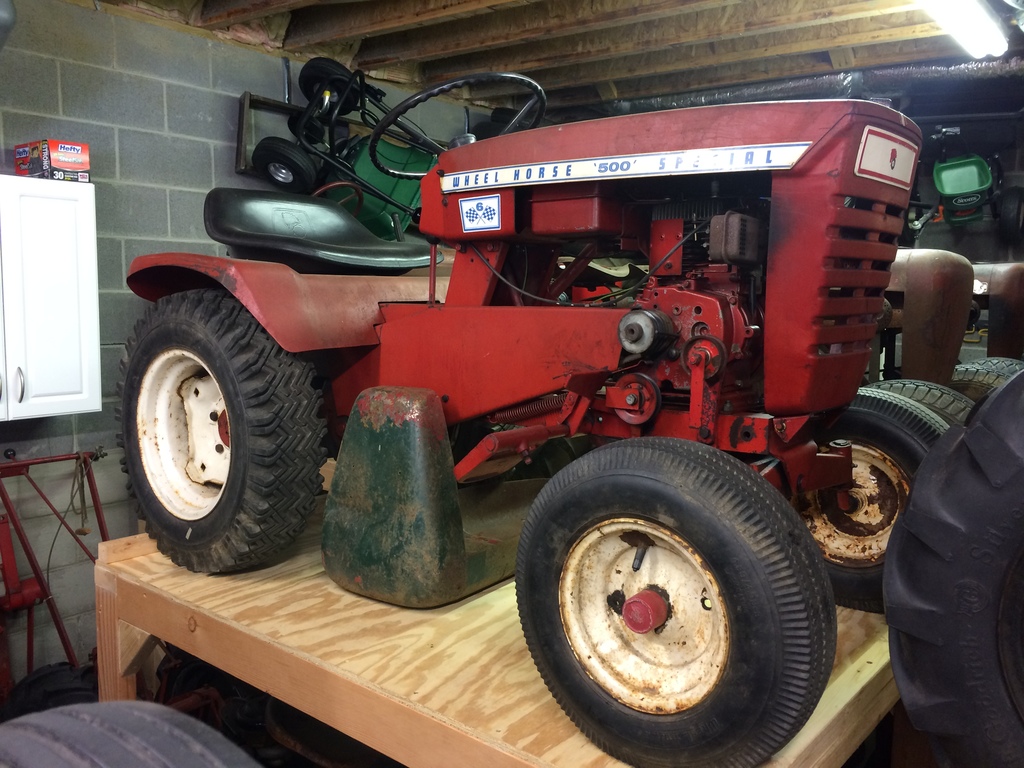

rj35hunter 309 #6 Posted March 19, 2017 It could even be a short frame square hood low HP engine tractor like a 656, 606, 657, 607, 1968 500 Special, Commando 6, etc etc, that came with the skinnier tires. This is my 500 Special that's all original and has the exact same back tires and probably fronts too..... 3 Share this post Link to post Share on other sites

Gunny 257 #10 Posted March 20, 2017 Thanks all. From what I can read from info I have, the Slim Rear wheels went out about the same time the "square" hood came in. Sorry for not having more info on here, will have some more info in April when I can actually have my buddy pull all the parts out in the daylight. I do know it is a short frame. He wants to bring it back to life, and I want some painting done. I agreed to help him with a K181 and extra parts I have, and he will paint my 857 and C120. He has a nice collection of big JD's, and does awesome work. Steve, Ted don't know horses, but next time I speak with G.W I will ask him, maybe he would include one! Share this post Link to post Share on other sites
