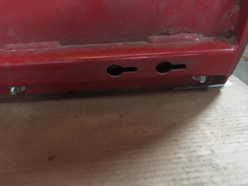

HamptonT 33 #1 Posted March 17, 2017 Correct me if I'm wrong, but I believe the holes in the lower outside corners of my snow blade are for skid shoes. Anyone know where I might find some shoes for it? Thanks 1 Share this post Link to post Share on other sites
pfrederi 21,056 #2 Posted March 17, 2017 part # 92-6840 still available and at Toro's price i doubt they ever sell out. Search here for snow skids lots of different homebrew ideas. 2 Share this post Link to post Share on other sites

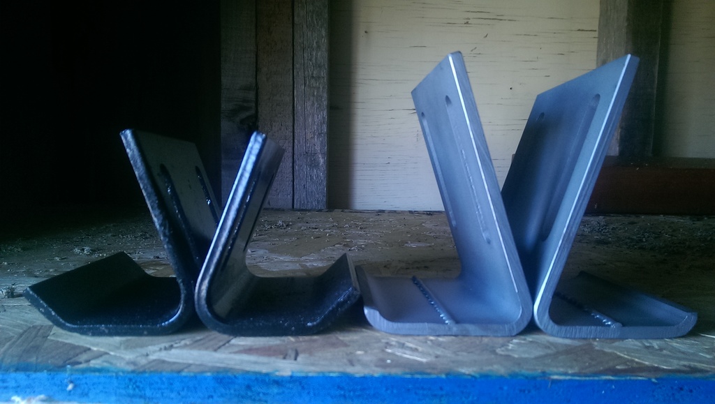

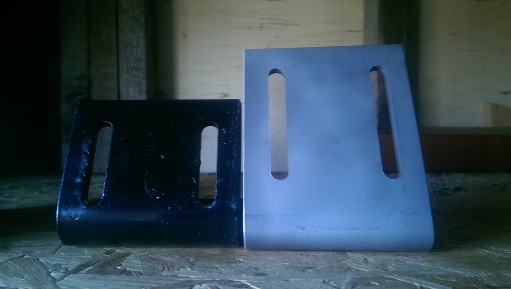

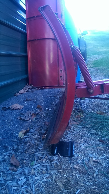

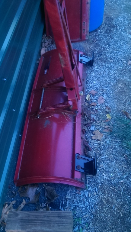

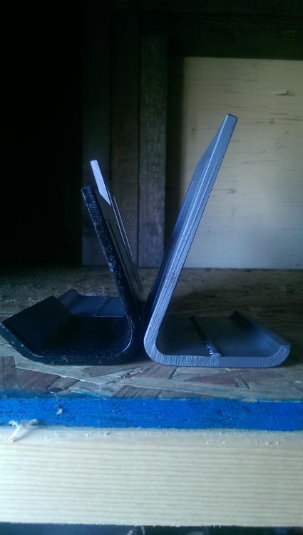

WVHillbilly520H 10,379 #5 Posted March 17, 2017 (edited) Here's the factory ones (black) and a set (raw steel) I made at work not to hard to do even without a machine shop full of mills and lathes , ones mounted on blade are painted one I made has extra "lift" for gravel work, Jeff. Edited March 17, 2017 by WVHillbilly520H 7 Share this post Link to post Share on other sites

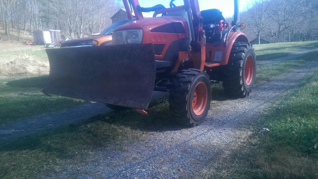

WVHillbilly520H 10,379 #8 Posted March 19, 2017 @Tankman, that's basically what is on my Economy blade I converted over for my Kioti, you can see them peeking out from under the cutting edge, Jeff. 1 Share this post Link to post Share on other sites
Tankman 3,528 #9 Posted March 19, 2017 Very nice setup! Nice tractor too! 1 Share this post Link to post Share on other sites
