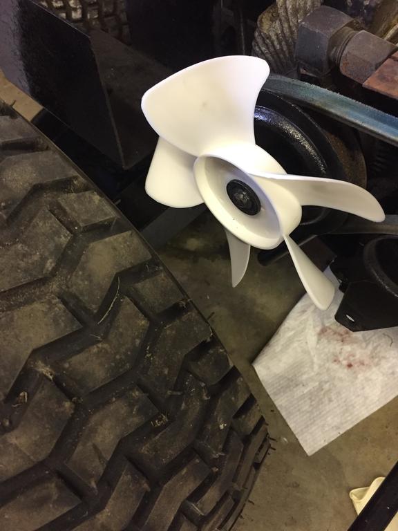

Red144runner 659 #53 Posted April 11, 2017 (edited) I just got the new cooling fan in today. Need new oil filter, oil, and the decals! There's a show in late may hopefully I'll have it ready. Of course we are getting into the busy season for me, grass is growing and spring sports are full steam at work. I also do 10 lawns on the side so spring cleanups then mulch for a few ohhh and we are moving at the start of may AND the alternator on my other '84 ( 3500 GMC) decided to quit after 33 years of service (pretty sure its original since it's a Delco-remy and made in USA). But I will get it done👍🇺🇸 Edited April 11, 2017 by Red144runner 1 Share this post Link to post Share on other sites

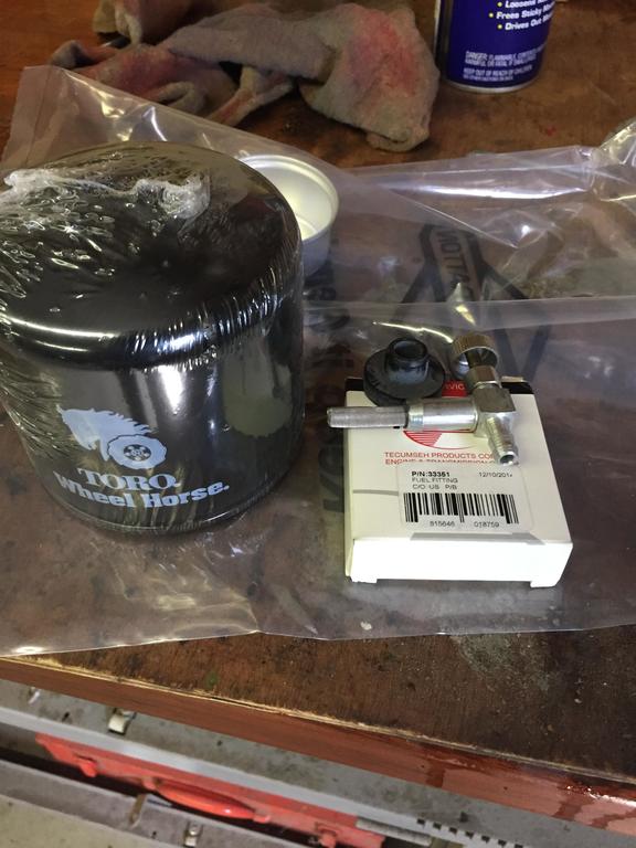

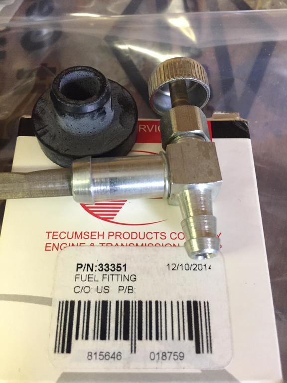

Red144runner 659 #54 Posted April 12, 2017 Few parts came in today. I picked up a new fan, fuel tank/valve grommet, and oil filter. I installed all the parts, planned on filling the oil then I realized it was a synthetic blend on the shelf. I don't know if that would cause problems or seal issues but I'll stick with what it calls for. I took a close up of the part number on the valve if anyone was curious 1 Share this post Link to post Share on other sites
bmsgaffer 2,071 #55 Posted April 12, 2017 12 hours ago, Red144runner said: Few parts came in today. I picked up a new fan, fuel tank/valve grommet, and oil filter. I installed all the parts, planned on filling the oil then I realized it was a synthetic blend on the shelf. I don't know if that would cause problems or seal issues but I'll stick with what it calls for. I took a close up of the part number on the valve if anyone was curious In engine or transmission? If hydro, many people here will swear by full synthetic in it just for your future use. Synth blend should be no problem in either. Fuel fitting also available from vendor here: http://www.rmaynard.com/fuel_shut_off_valves.html @rmaynard Share this post Link to post Share on other sites
bds1984 1,513 #56 Posted April 12, 2017 I wouldn't sweat about the oil you have. Think about it, that oil you have is probably SN rated and is in every way superior to what was originally specified and was most likely SF. Unless you'll be pulling heavy loads in dusty conditions, I really doubt it'll make a difference if you follow the proper service intervals. Share this post Link to post Share on other sites
Red144runner 659 #57 Posted April 12, 2017 Great info. I'll put the synth blend in then. This won't be pulling heavy loads. It will most likely be running the 44" blower. Share this post Link to post Share on other sites

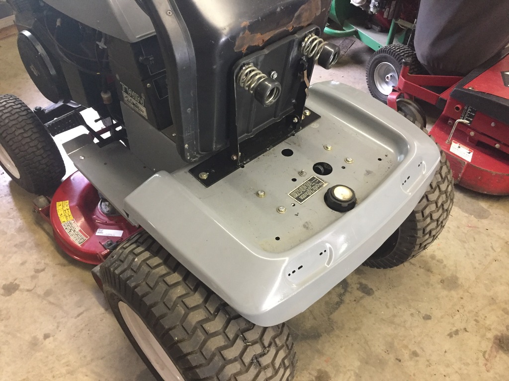

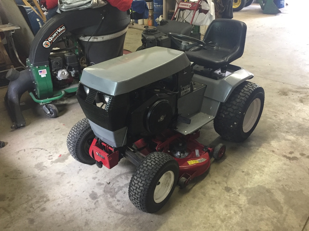

Red144runner 659 #59 Posted June 3, 2017 The tractor is just about done. It runs great and the eaton1100 is good and strong. Needs headlight bezels, decal set, custom seat mounts, headlight re wire and rear reflectors. We put a new stator on it since the old one wasn't charging. All new fasteners just about everywhere. I'll post some pictures up this week. Been busy since mid April between my 7 lawns and moving into a new house. I'll be using my 3/12 today to haul and grade 4500 lbs of 3/4" stone that's sitting in the back of my '84 1 ton Share this post Link to post Share on other sites

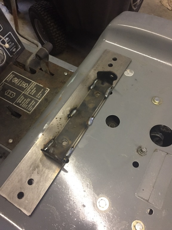

Red144runner 659 #61 Posted June 12, 2017 Tractor is up and running. Eaton 1100 pulls great. Does need tie rods as these are non adjustable and it is significantly out of alignment. I welded up a strip of 3"x3/16" to mount the craftsman seat and frame onto the much wider wh mount points. Should also help distribute the weight. This tractor did have a cracked seat support, but i repaired it. 2 Share this post Link to post Share on other sites

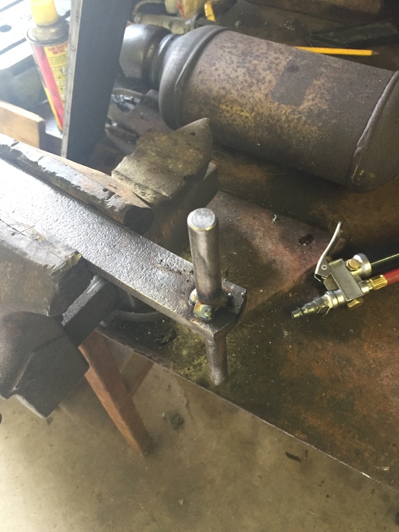

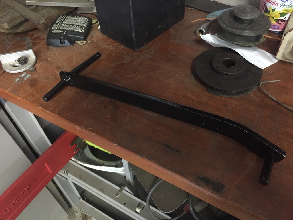

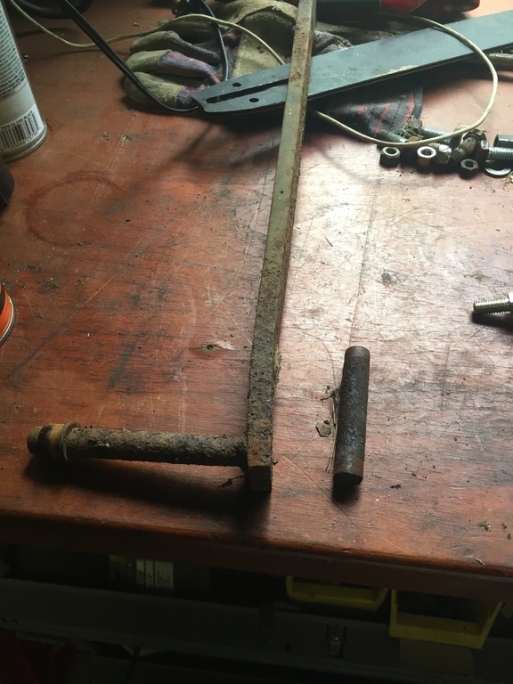

Red144runner 659 #62 Posted June 16, 2017 Seat is mounted, bracket is painted and I welded the springs to the seat base. Today as I was getting ready to hook up the mower I noticed the lift arm mounting axle was broken but still in the arm and frame. I took out the c clip and bushing and wire wheeled the whole thing and prepped it to be welded. Came out nice then sprayed it black. Put the deck under neath and the mule drive on. I'll finish it up Monday and test it out Share this post Link to post Share on other sites

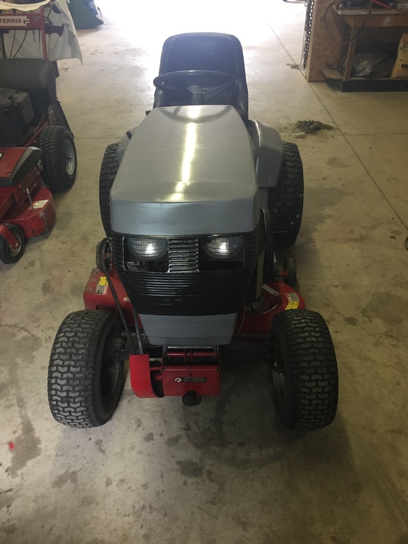

Texas Todd 1,026 #63 Posted June 16, 2017 Is it just the camera or is she a little pigeon-toed? Share this post Link to post Share on other sites
Red144runner 659 #64 Posted June 16, 2017 24 minutes ago, Texas Todd said: Is it just the camera or is she a little pigeon-toed? Oh yes. And that tie rods are not adjustable. Ordering new ones asap. Front tires are in good shape and it's so out of alignment driving it around fir any length of time will wear them fast Share this post Link to post Share on other sites
Texas Todd 1,026 #65 Posted June 16, 2017 Mine were like that one time after re-assembly. I had em on the wrong side.....Worth checking before ordering. 1 Share this post Link to post Share on other sites
Red144runner 659 #66 Posted June 16, 2017 34 minutes ago, Texas Todd said: Mine were like that one time after re-assembly. I had em on the wrong side.....Worth checking before ordering. I'll do that. Share this post Link to post Share on other sites
mike416 14 #67 Posted June 17, 2017 The lift arm did turn out nice, heck the whole tractor is turning out nice. Had to install a set of adjustable tie rods when I was working on my 416. Got it perfect! 1 Share this post Link to post Share on other sites
