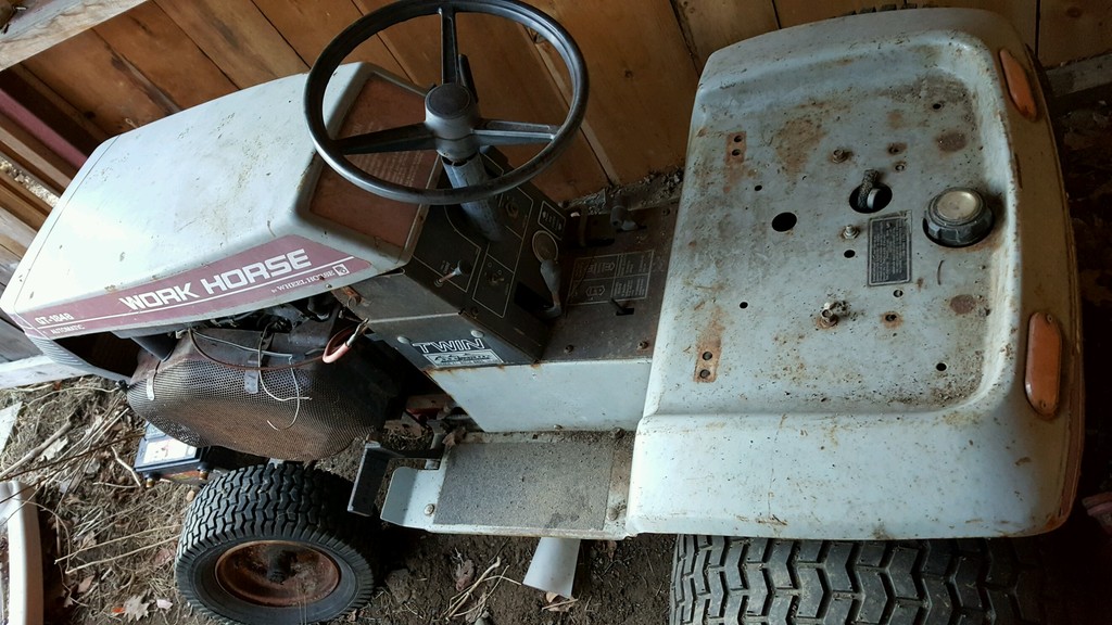

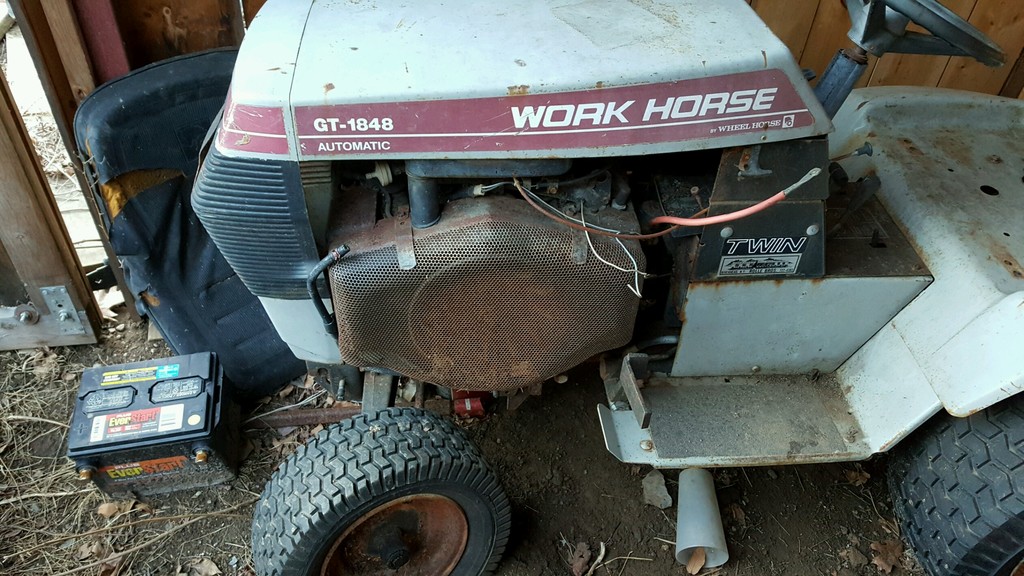

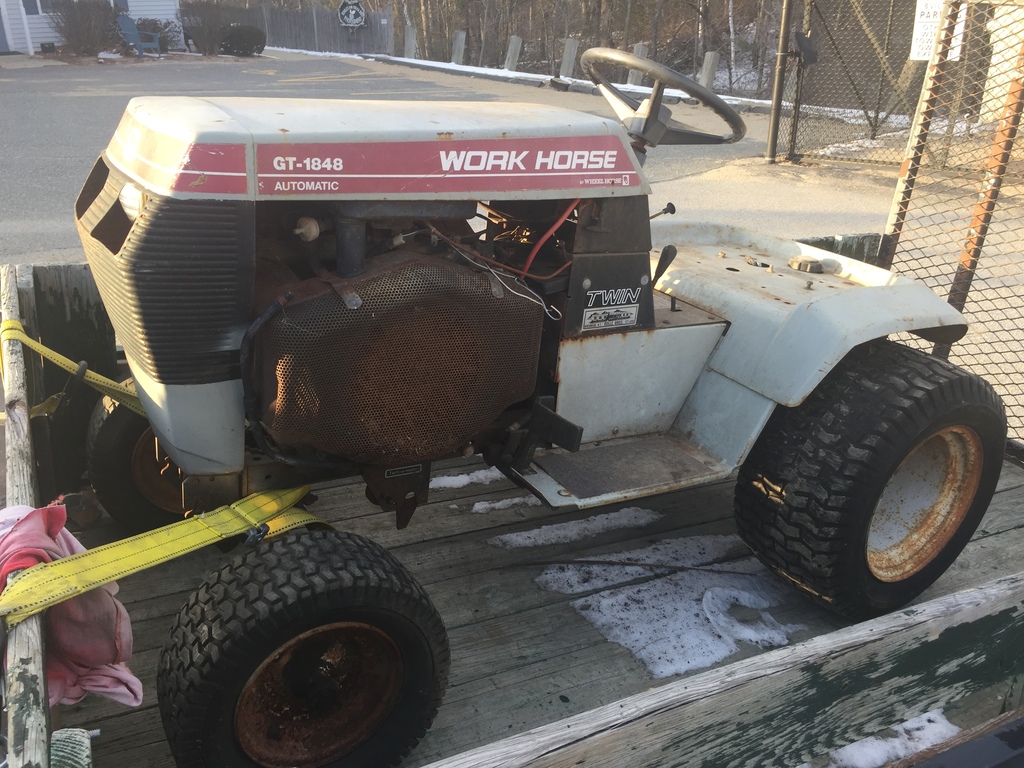

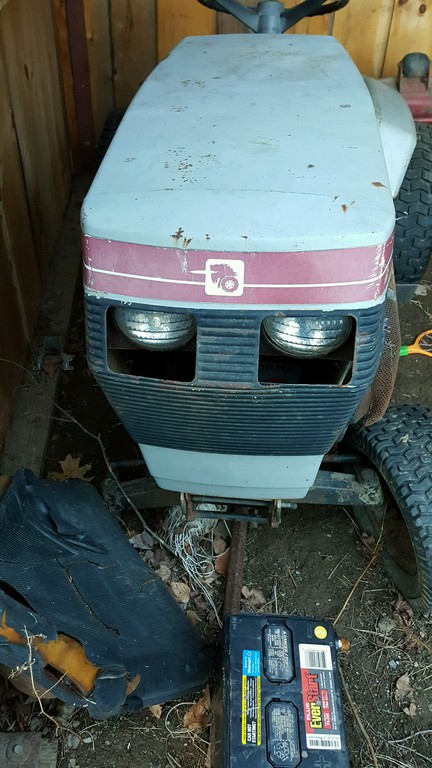

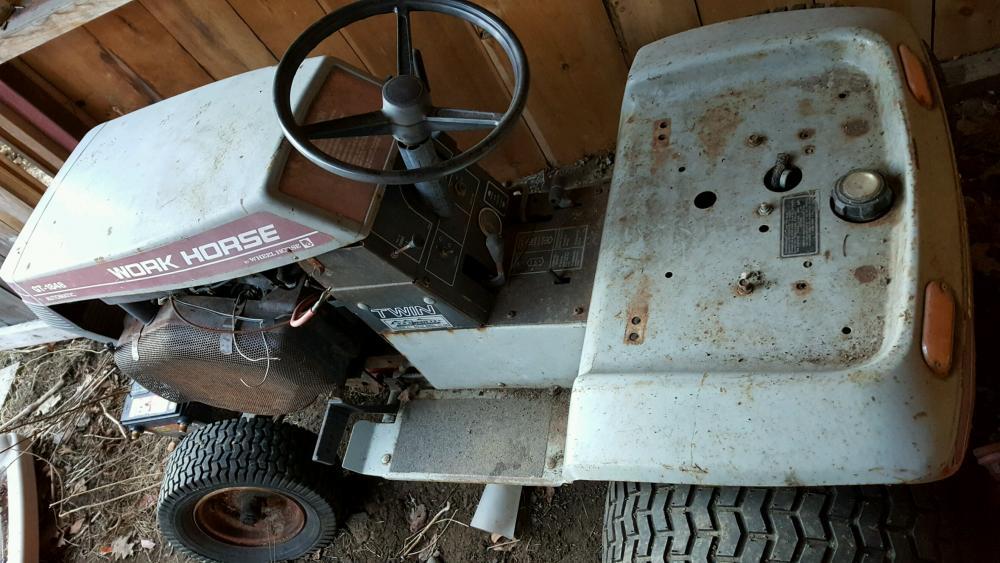

Red144runner 659 #1 Posted March 11, 2017 Picking one up Saturday. Bit rough, but mostly complete. Sound like tough tractors to me. Thoughts? Share this post Link to post Share on other sites
SylvanLakeWH 32,083 #3 Posted March 11, 2017 10 minutes ago, 953 nut said: 1 Share this post Link to post Share on other sites

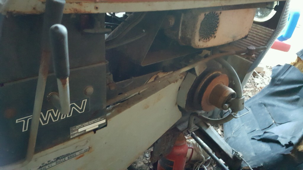

AMC RULES 37,259 #4 Posted March 11, 2017 Is this the one? Share this post Link to post Share on other sites
Red144runner 659 #5 Posted March 11, 2017 I didn't take these. I'll post more when I get it tomorrow 7 Share this post Link to post Share on other sites

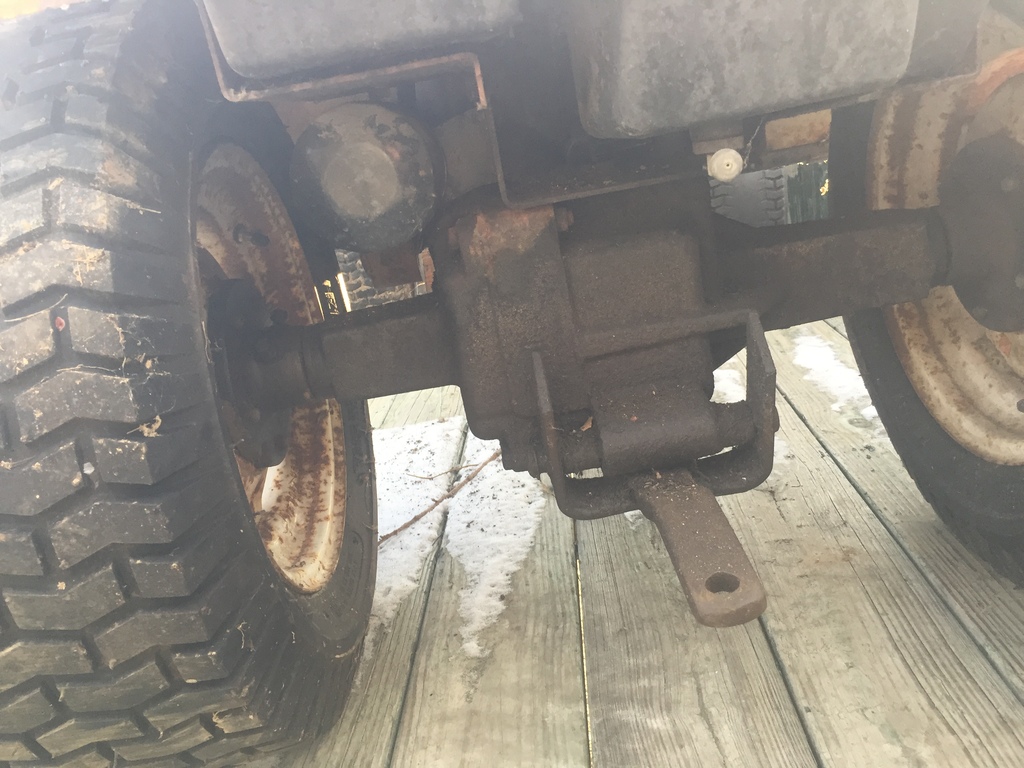

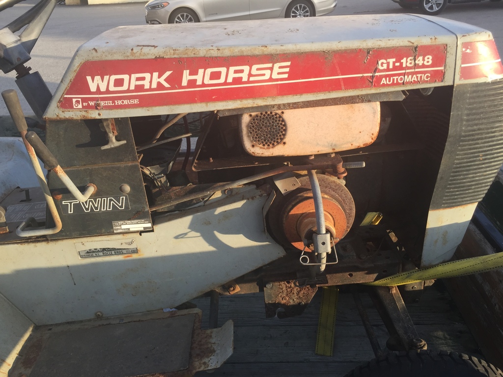

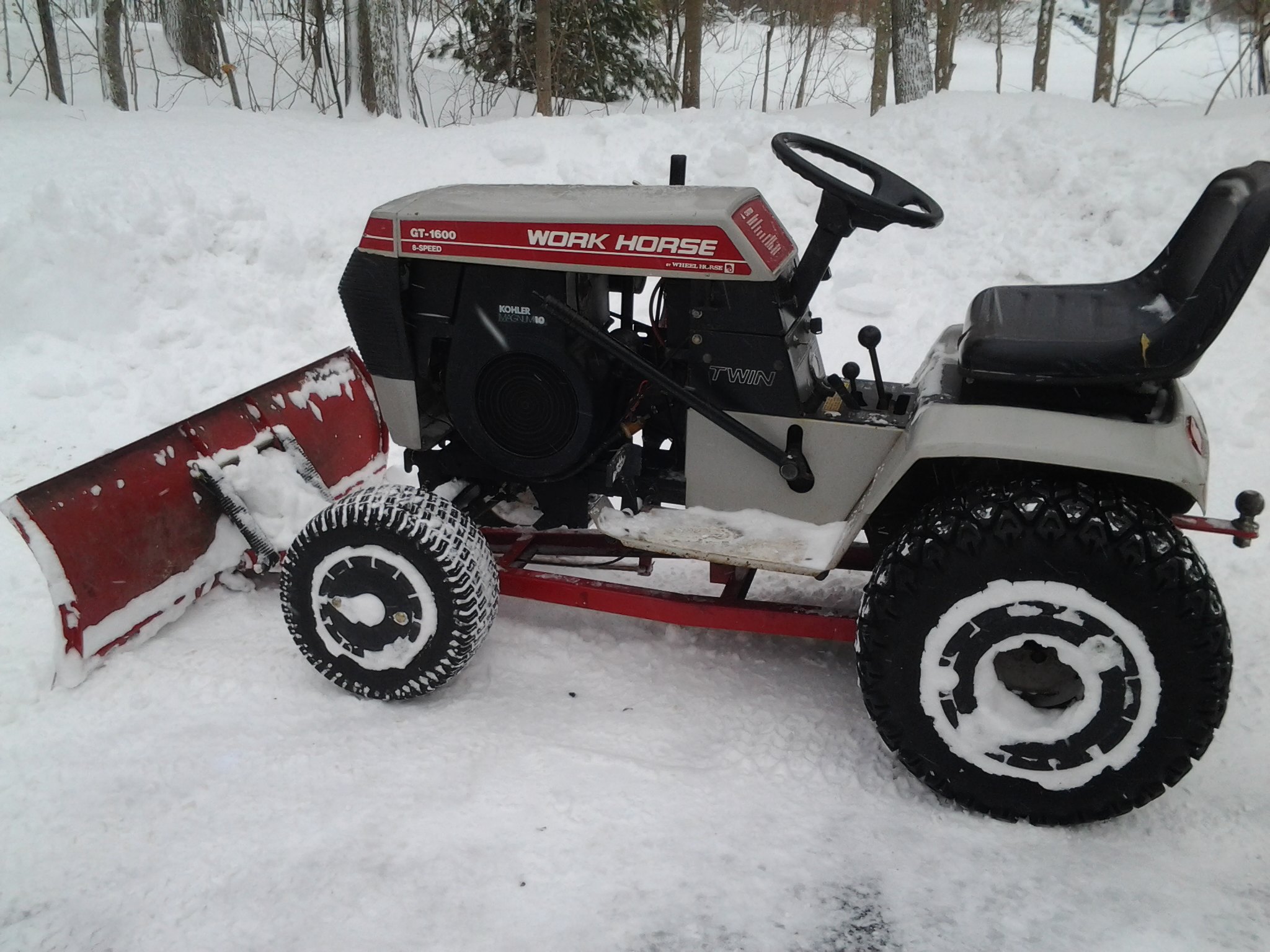

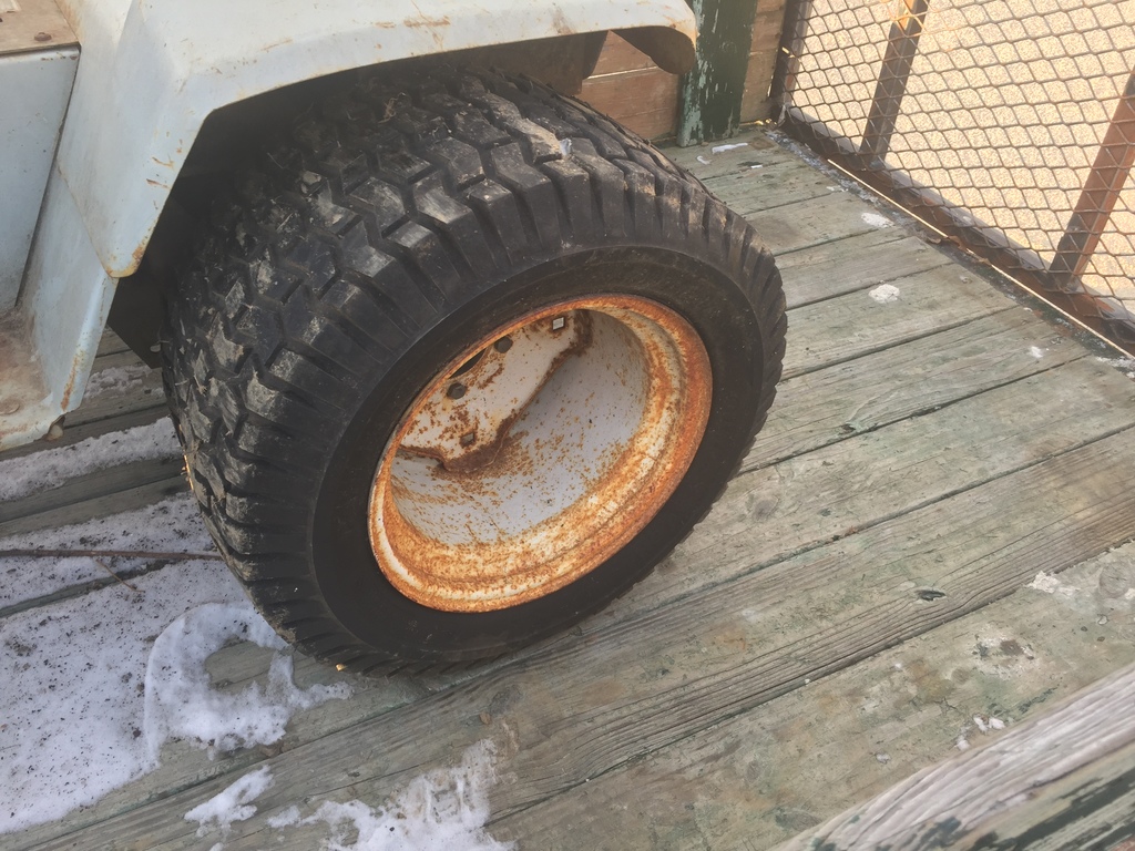

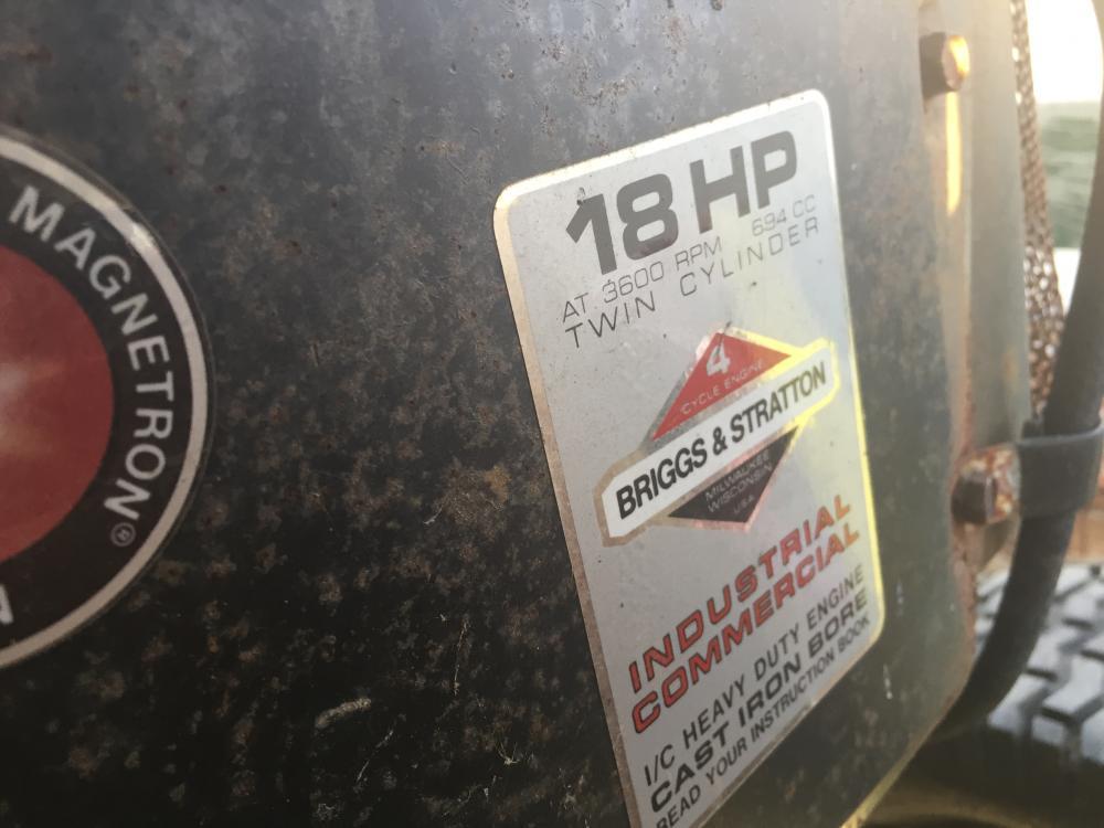

Sparky-(Admin) 26,200 #6 Posted March 11, 2017 Regardless of the color it's all Wheel Horse. It has the Eaton 1100 hydro with hydraulic lift. I'm not a fan of the Briggs motors but plenty of guys here have em and they are still running strong. The rear axle is geared a bit differant than most hydro's and is a bit faster (I think that's a cool feature!), and if the rear rims are original they are the wider 8.5" rims and are very sought after. If you find the motor is shot you can install another Briggs or go with a nice Kohler. Good luck with it! Mike.... 6 Share this post Link to post Share on other sites

Red144runner 659 #8 Posted March 11, 2017 (edited) 50 minutes ago, AMC RULES said: Is this the one? Yes I had a simplicity broadmoor with a twin Briggs and it ran well. Hopefully the trans is good if the engine is shot I could swap another in. I plan on a restoration for work. Meaning, clean it, get it running and operating reliable and strong and some paint. Seat too. I really like the look of the work horses so I'm stoked to find this. Looks like the wider wheels too Edited March 11, 2017 by Red144runner 6 Share this post Link to post Share on other sites

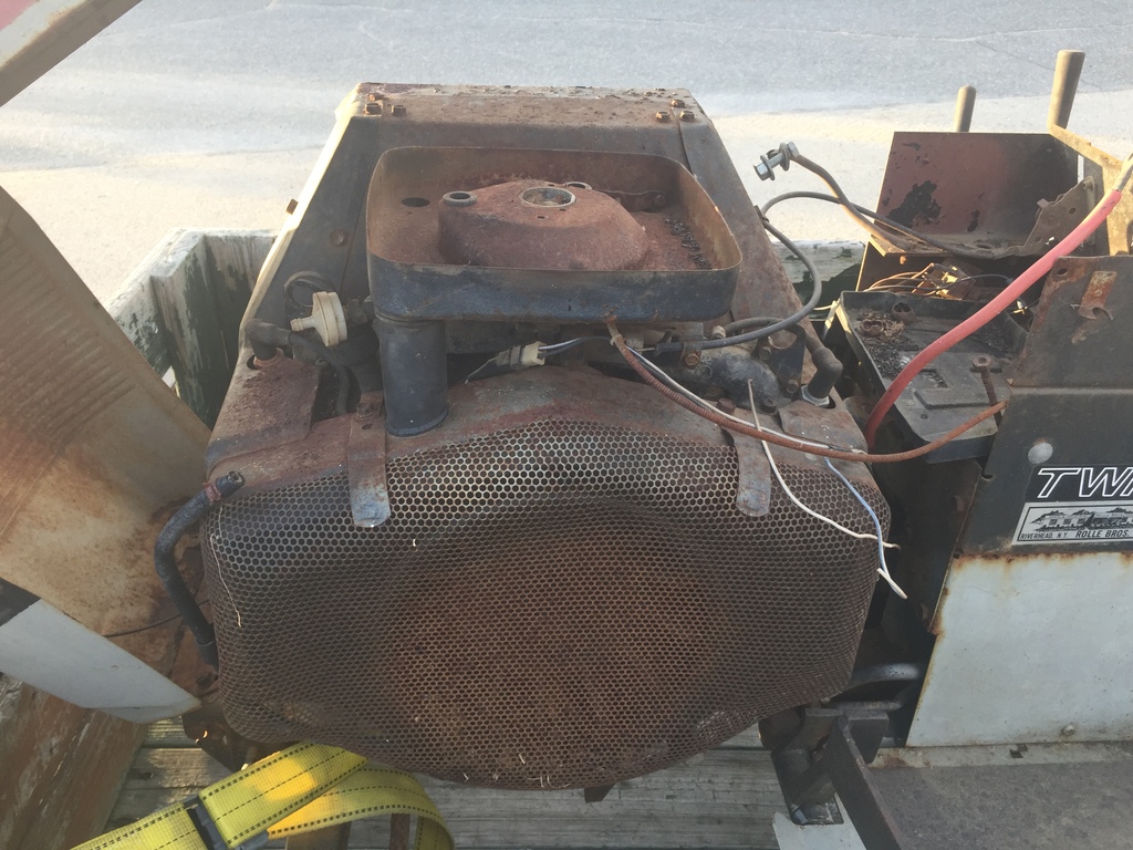

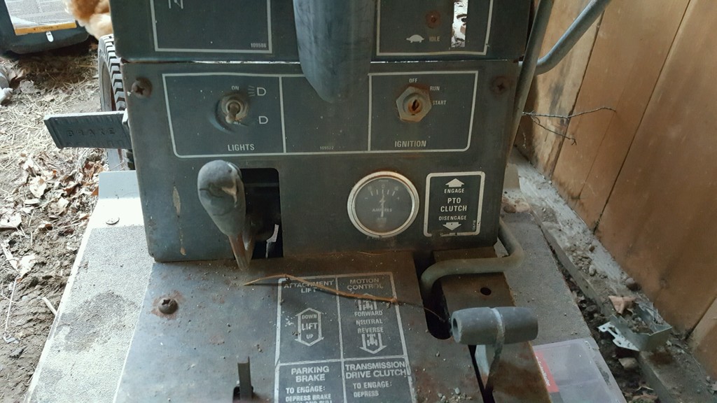

Red144runner 659 #11 Posted March 11, 2017 So we took the ride out an hour and a half to get it. Worked well since we are listing our house and couldn't be there till 6pm. It's rough for sure. Front tires are pretty bad, rears are like new and wheels are the 8.5"! I do have the a/f cover too. Engine...won't know till I dig into it. I didn't even try to turn it by hand, I suspect it's not stuck. Electrical looks sketchy but this isn't my 3/15 so should be straightforward. Trans moves free in neutral, motion lever moves as does brake and pto. The cooling fan is shot, again I have to strip this one down to see what it needs. Paid $100, maybe overpaid but I've wanted this model. Also subsidized this project by selling 2 commercial walkbehind 36" mowers earlier for a decent profit. The plan is see if I can get it running/moving. The big Briggs doesn't scare me but I've never worked on an eaton 1100. Hopefully it is ok. Then strip it down clean, sand, repair, replace, paint it and put it back to work. Will take a while but should be fun 3 Share this post Link to post Share on other sites

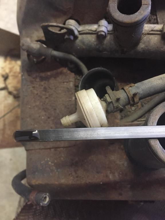

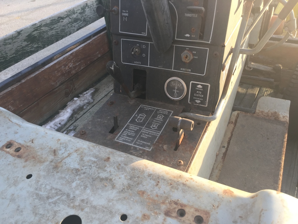

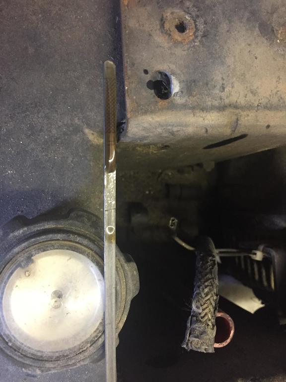

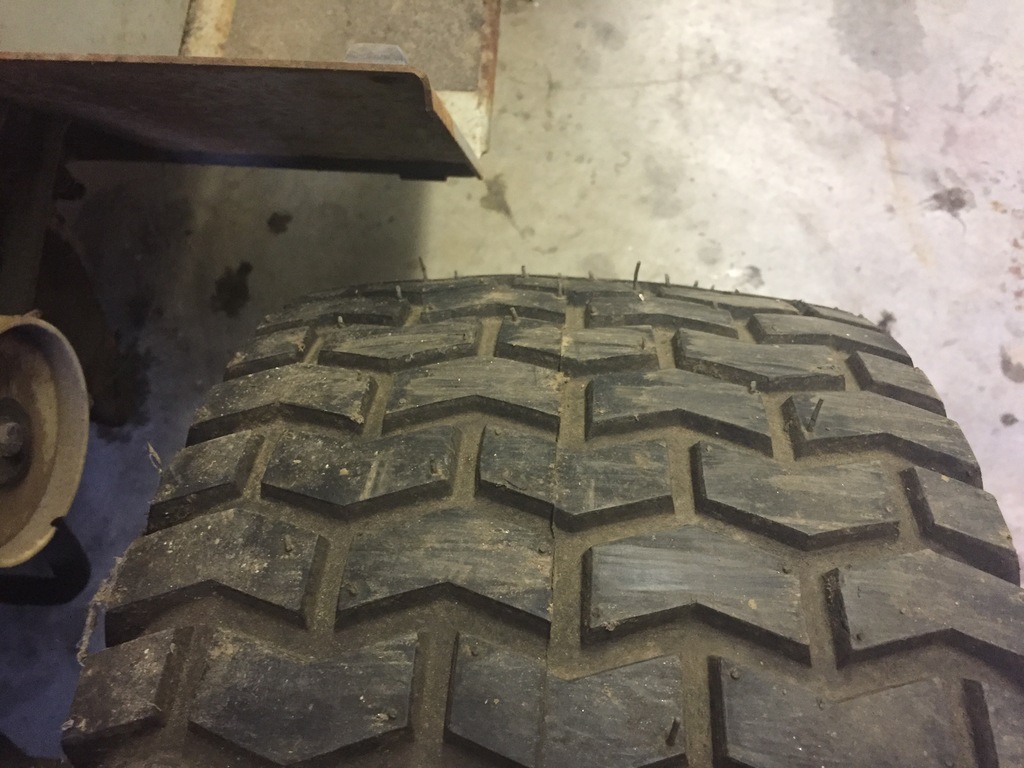

Red144runner 659 #14 Posted March 12, 2017 Got it off the trailer and in the shop cause I had to go to work for a couple hours this morning anyway. First, got the screen off the flywheel, loaded with mouse debris. I didn't think it would turn, but it did, and felt good could feel compression but no grinding or friction, could change when a stater spins it over but for now, it's good. Next took the seat tin off, checked gear box oil, and again pretty good. Not milky, a little dark but full. Engine oil was dirty and a little low. So far it's better than I thought. Rear tires are near new, the cooling fan is toast Share this post Link to post Share on other sites
c-series don 12,349 #15 Posted March 12, 2017 Those wide back rims are worth 100 bucks alone. At least to me they are! Please keep us updated on your progress. 2 Share this post Link to post Share on other sites

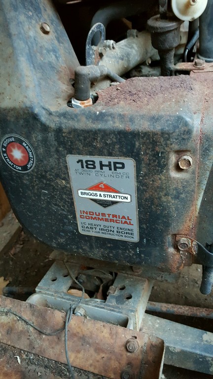

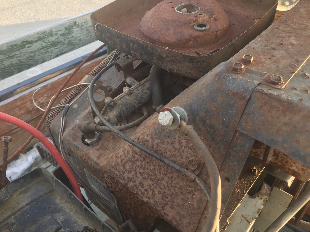

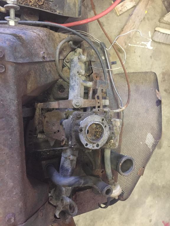

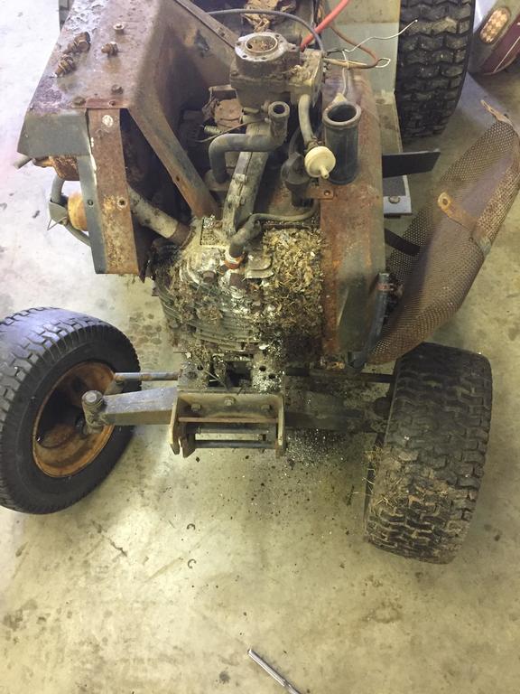

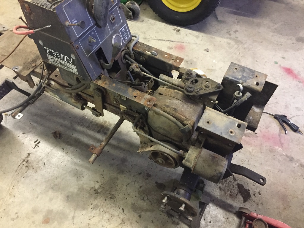

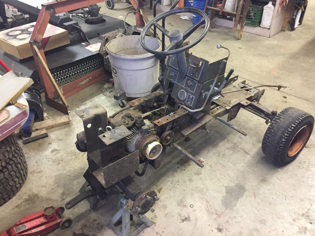

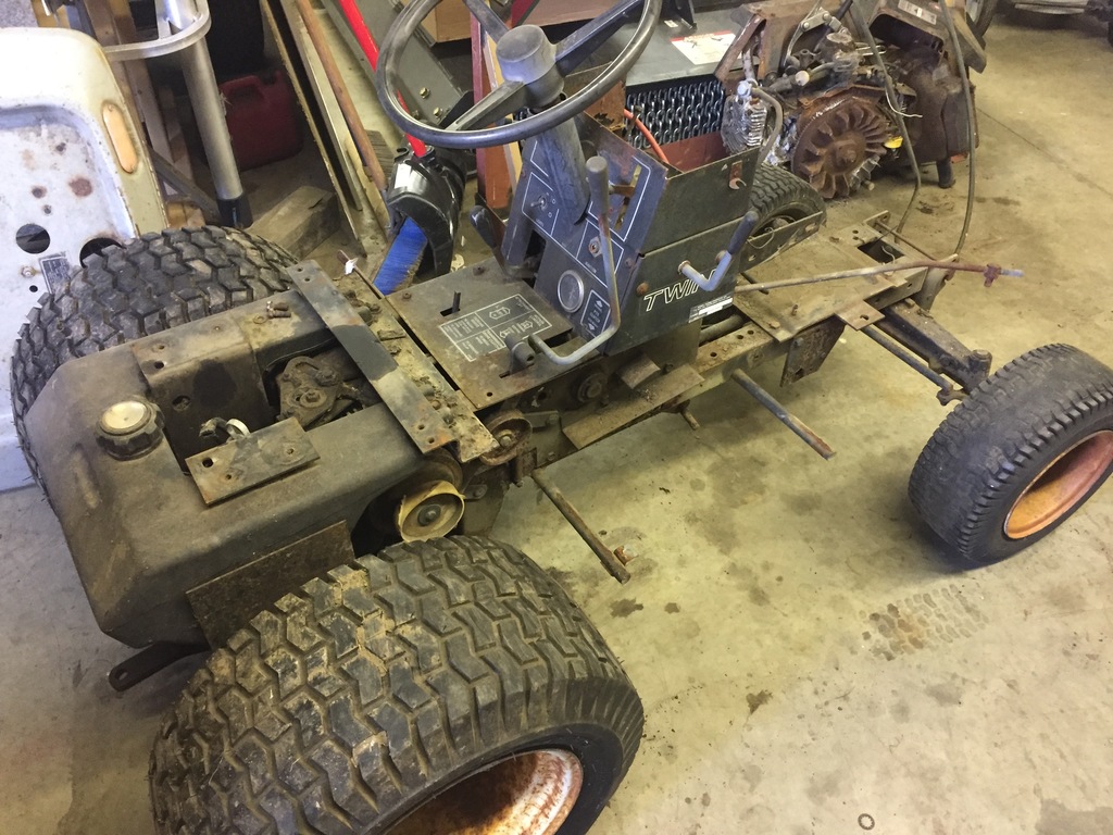

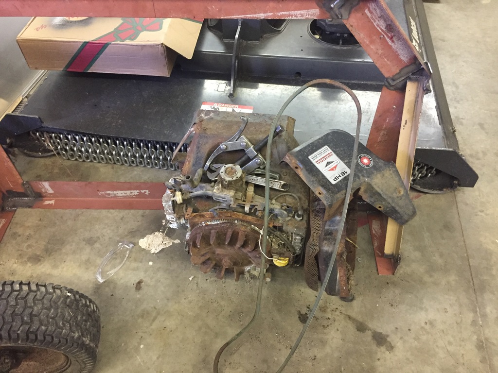

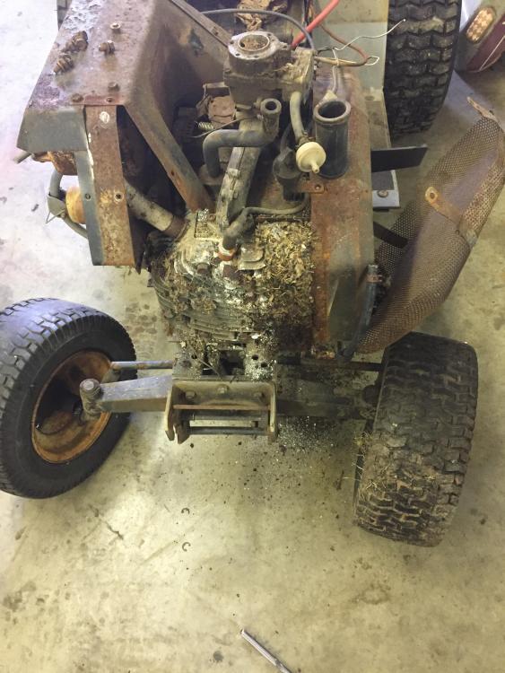

Red144runner 659 #21 Posted March 14, 2017 Looks like the engine is no good. Damn mice made an absolute mess under the shroud. The ammonia smell burned my nose for 2 hours. The problem is that the mice excrement created a corrosive reaction with the aluminum engine block and destroyed the cooling fins. Poking it with a screwdriver I couldn't find hard aluminum on the front most jug on the flywheel side. Even if I could get it going I doubt this engine would last. Its a setback, I would have liked to keep the original power plant but now I'm looking. I'd like to stay above 15hp. Kohler, onan and Briggs are my options. I'd take a Kawasaki in that range too but none are cheap. Hopefully that trans is good. Fluid was full and clean and it rolls good Share this post Link to post Share on other sites
can whlvr 994 #22 Posted March 14, 2017 dam mice,i blew up a 10 hp kohler once due to plugged cooling fins from mice Share this post Link to post Share on other sites
Red144runner 659 #23 Posted March 14, 2017 13 minutes ago, can whlvr said: dam mice,i blew up a 10 hp kohler once due to plugged cooling fins from mice I believe it. I've never seen one this bad Share this post Link to post Share on other sites

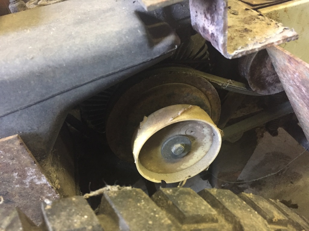

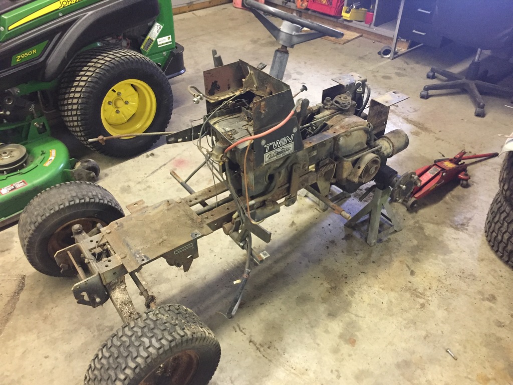

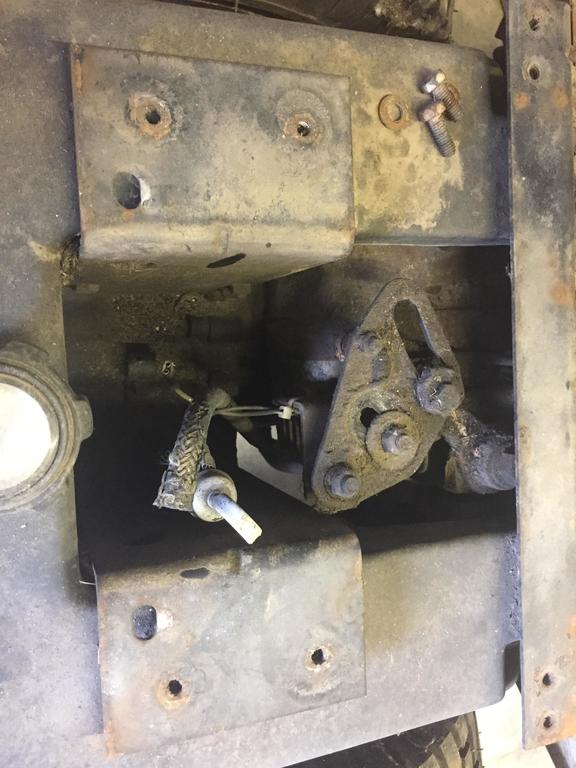

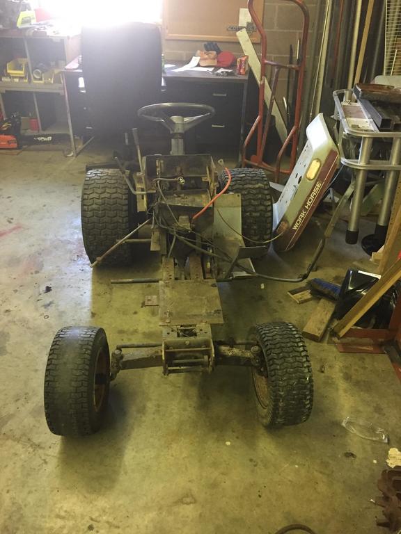

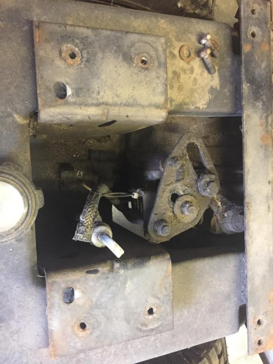

Red144runner 659 #25 Posted March 14, 2017 Dug deeper into tractor. All tins off except dash, fuel tank and rear wheels. Rear end looks good. Little oily, but hoses, fittings, gaskets and seals look good. Axles feel tight and turn smooth but can feel gears. I got a little nervous, but in my foolishness I thought Turing the input shaft on trans would make axles turn. So I called my dealer who told me they need 700rpm to move or for the pump to move the fluid. So far 2 Share this post Link to post Share on other sites
