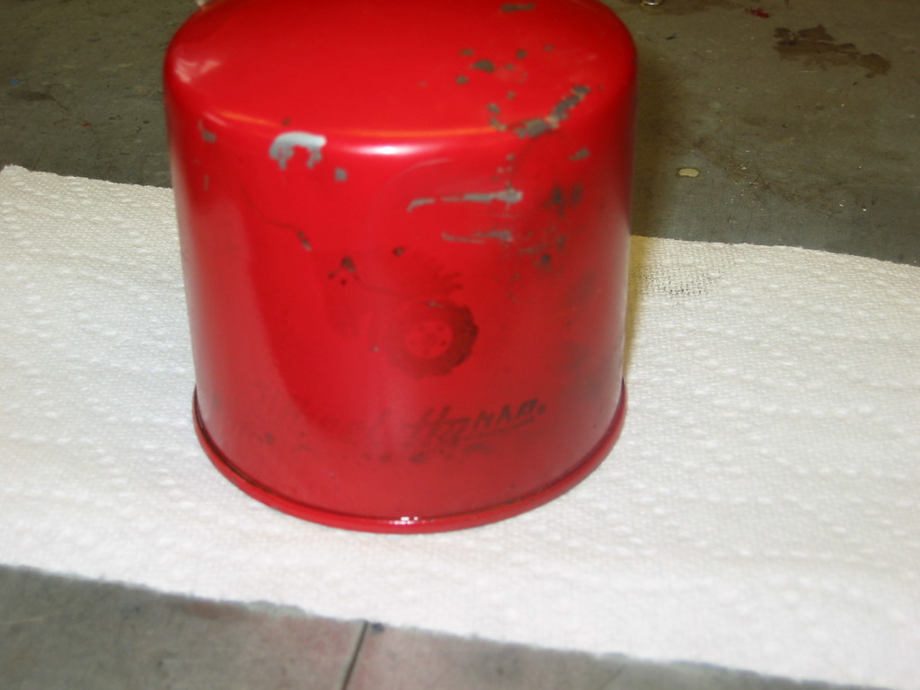

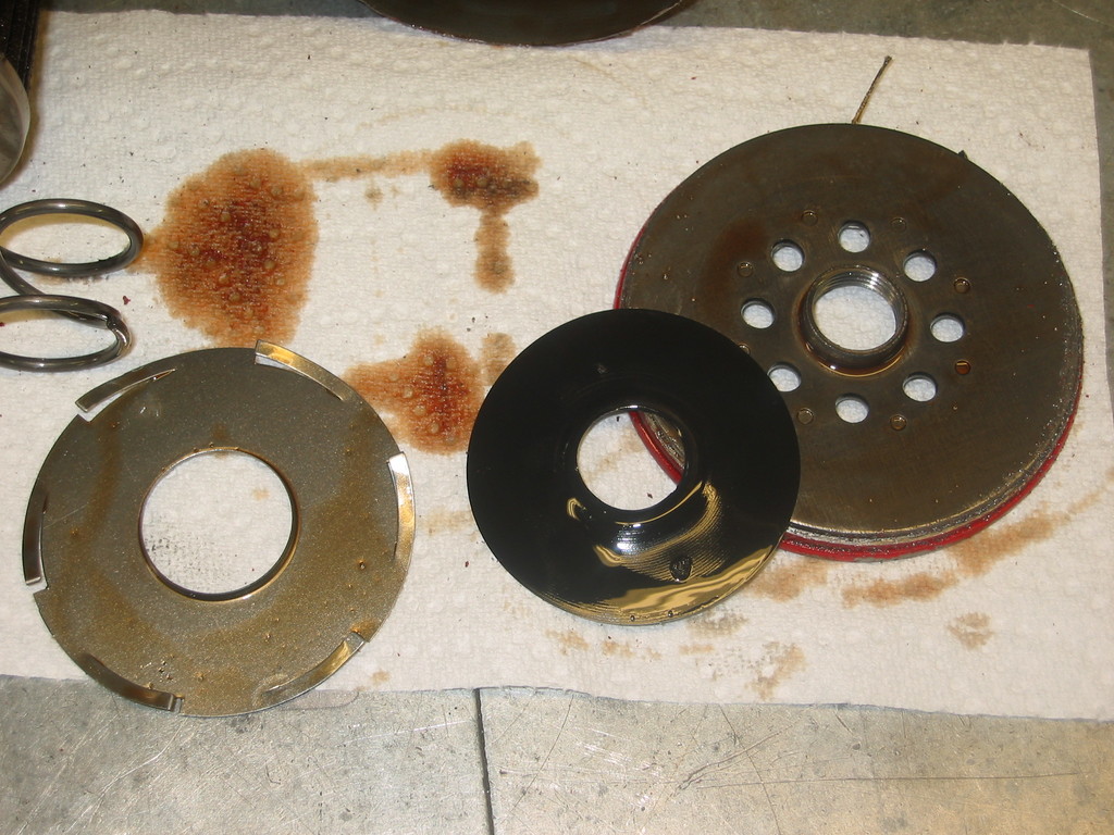

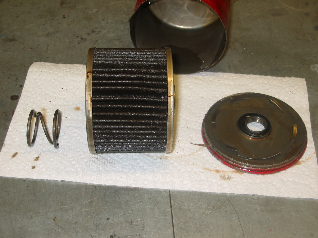

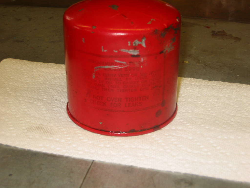

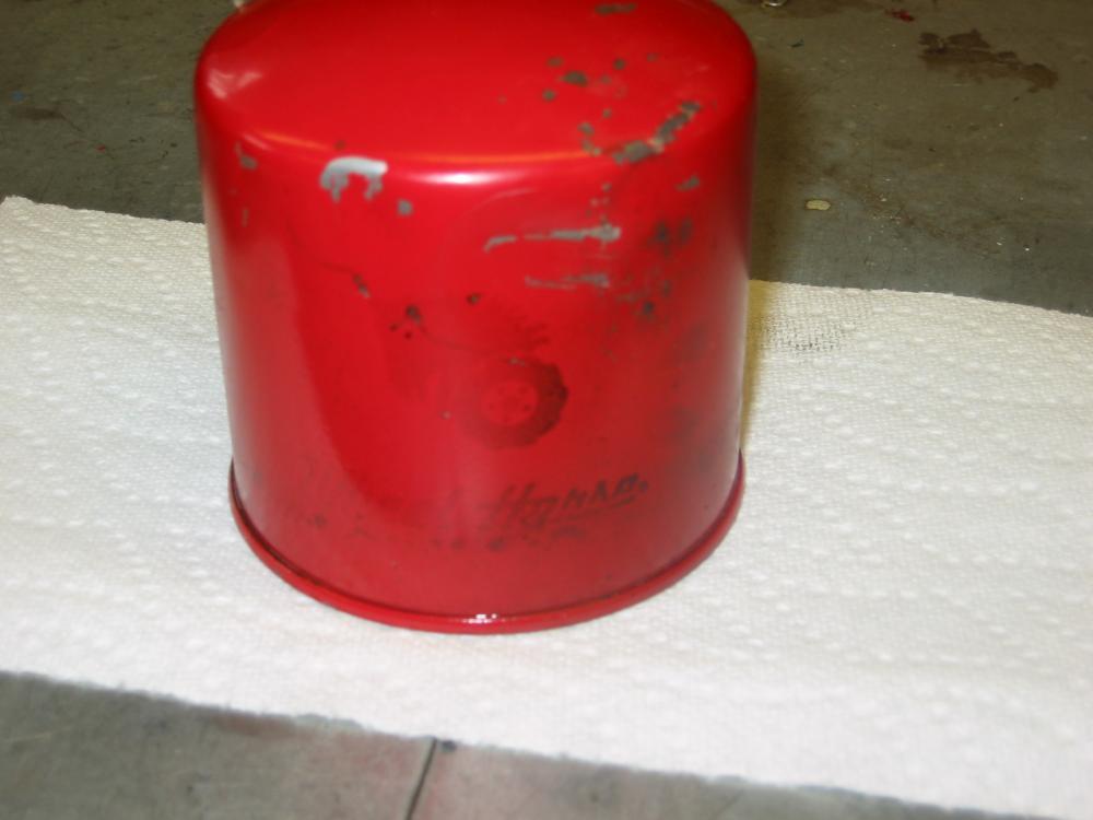

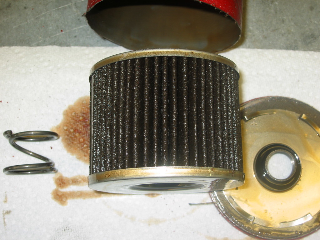

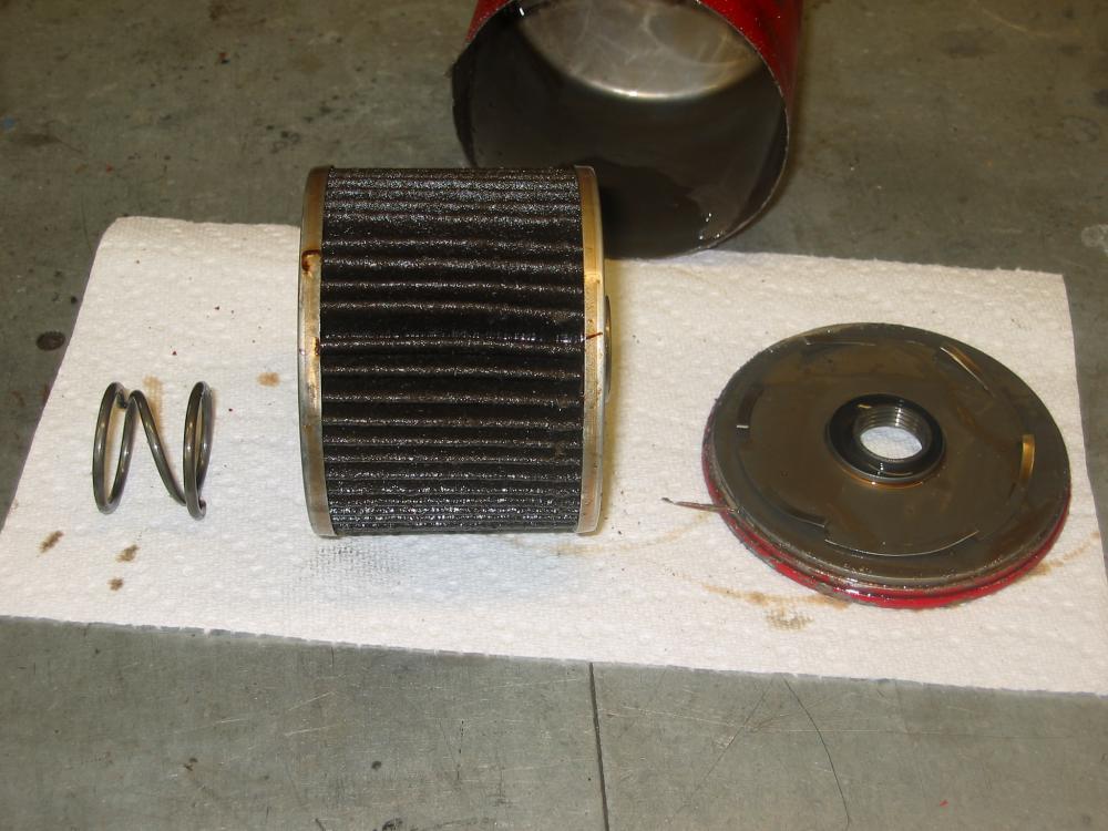

pfrederi 20,680 #2 Posted March 10, 2017 I picked up a Electro 12 awhile back that had an original Red Wheel Horse filter 5990 (Doesn't speak well of the POs maintenance.) Here are some pictures . I do not know who makes the toro filters and I would imagine over time they have changed suppliers. they also look to the lowest bidder I would guess. Consider how long they are using one filter 79-5270 to replace two older numbers on on different systems (Sundstrand/Eaton) some with ATF some with motor oil. Part of that is probably about simplifying their supply chain. 4 Share this post Link to post Share on other sites

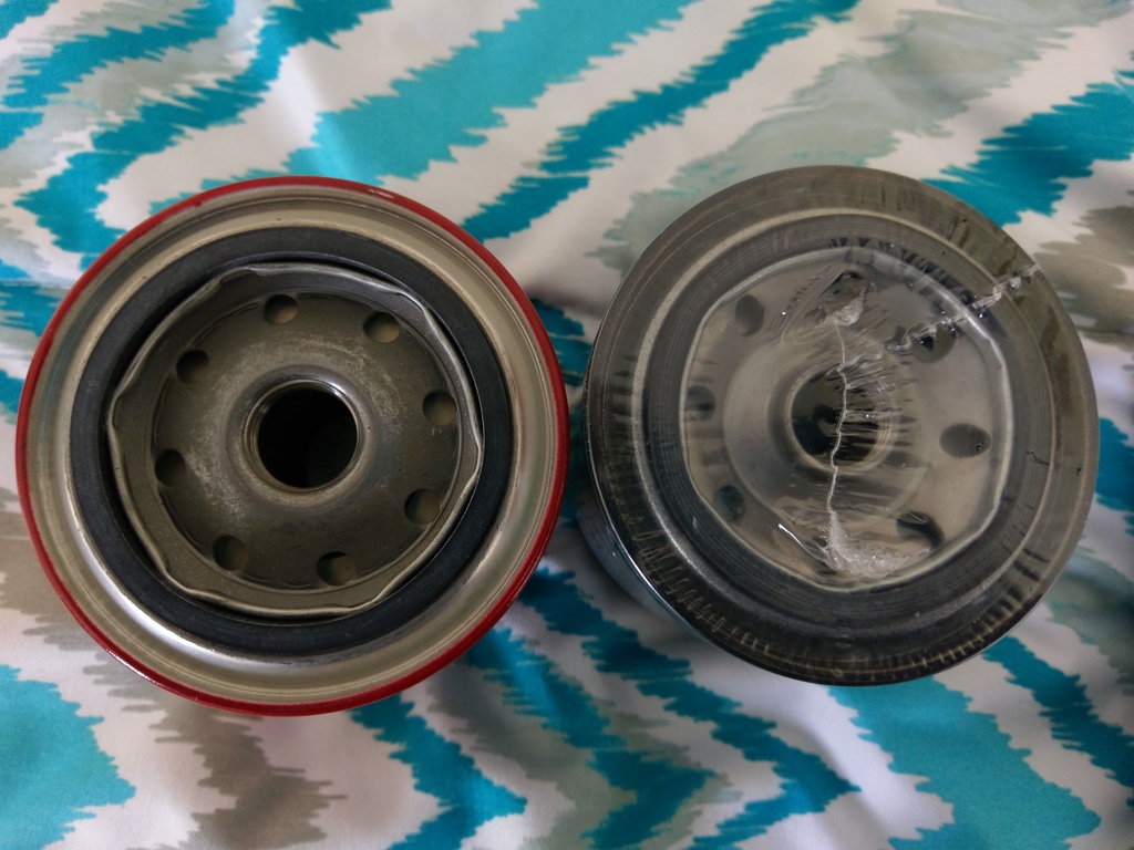

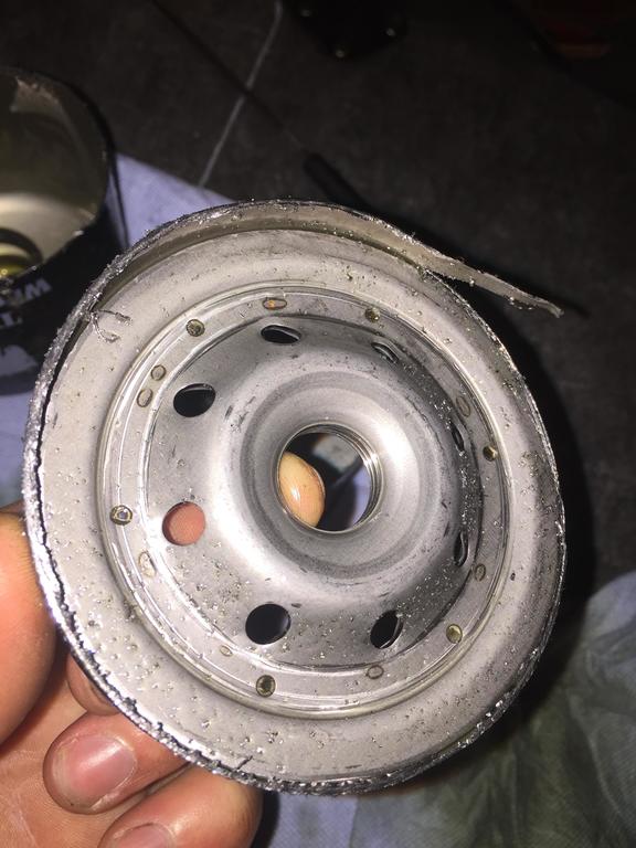

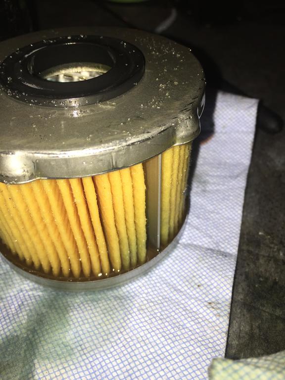

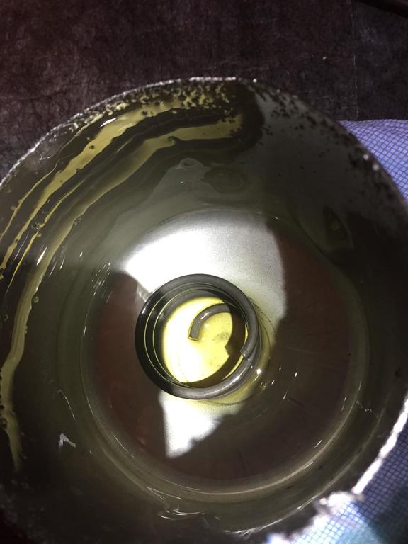

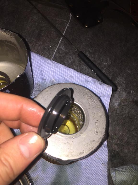

squonk 46,895 #3 Posted March 10, 2017 That filter that Paul cut open is nothing like the Black newer Toro filter I cut open a few years back. It actually looks like it was a decent filter. I was disappointed with the Toro one. Use a Napa 1410 3 Share this post Link to post Share on other sites

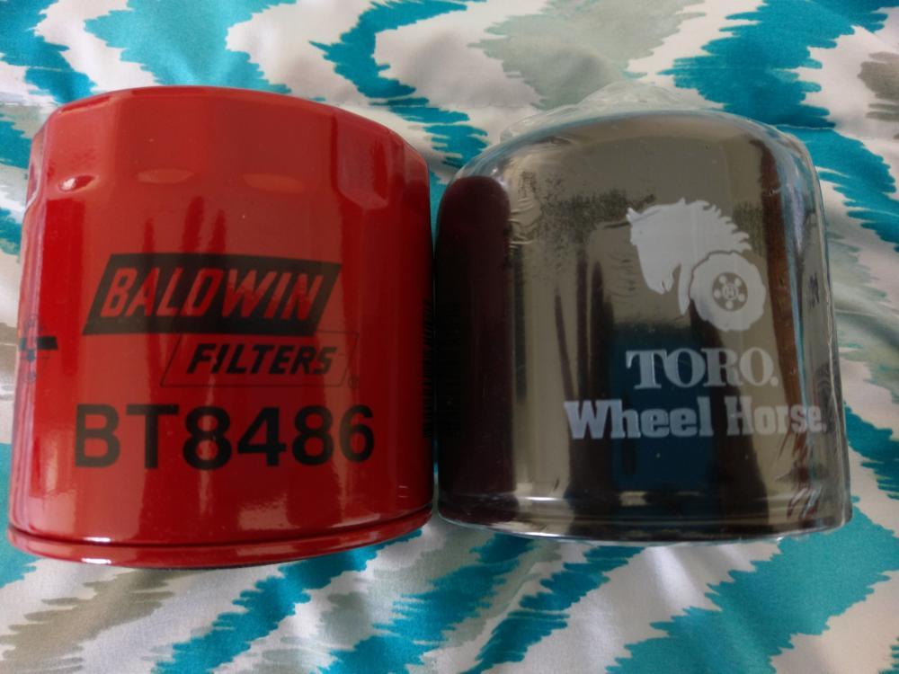

varosd 1,185 #4 Posted March 10, 2017 wasn't there a Baldwin filter for WH thread some years back/ might have been for the Eaton tranny filter Share this post Link to post Share on other sites

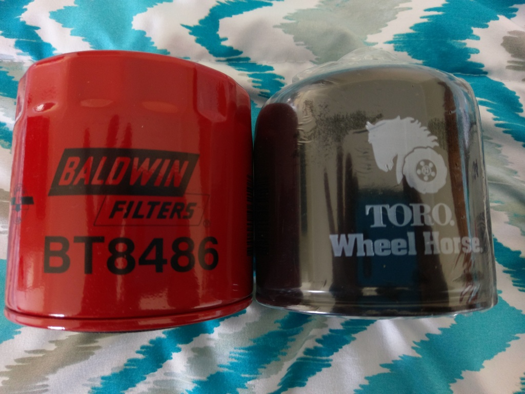

squonk 46,895 #5 Posted March 10, 2017 2 minutes ago, varosd said: wasn't there a Baldwin filter for WH thread some years back/ might have been for the Eaton tranny filter Baldwin BT8301 or BT8486 1 Share this post Link to post Share on other sites
WVHillbilly520H 10,378 #6 Posted March 11, 2017 Baldwin BT8486 on and extra came with the last 520(with bagger) I bought, says automatic transmission filter on the box , but the hydro was/is quiet and responsive, Jeff. 1 Share this post Link to post Share on other sites
BrianK 58 #7 Posted March 11, 2017 Interesting, fellas. 8 hours ago, pfrederi said: I picked up a Electro 12 awhile back that had an original Red Wheel Horse filter 5990 (Doesn't speak well of the POs maintenance.) Here are some pictures . I do not know who makes the toro filters and I would imagine over time they have changed suppliers. they also look to the lowest bidder I would guess. Consider how long they are using one filter 79-5270 to replace two older numbers on on different systems (Sundstrand/Eaton) some with ATF some with motor oil. Part of that is probably about simplifying their supply chain. I agree. Over the years who knows how many times they've switched because of money, some engineer, penny pinching bean counter or otherwise. I can't imagine having the original filter on that Electro...good lord, I would have melt down. 4 hours ago, squonk said: That filter that Paul cut open is nothing like the Black newer Toro filter I cut open a few years back. It actually looks like it was a decent filter. I was disappointed with the Toro one. Use a Napa 1410 See...this is what im afraid of. After my rebuild I put on a Napa/Wix filter. I have nothing but good to say about them, been using them on all my engines for 15 plus years. I don't know Toro, it scares me. In fact, I called them today and they couldn't tell me who made it for them. The guy couldn't even tell me the specs on the filter. WTH? Gave me a number to an authorized dealer....yea OK, ill call THEM, sure. I have a Toro one on now, but I don't like not knowing. I went through a lot of work on that pump and motor to just throw on a filter made by friggin FRAM or some other disgraceful puke of a company that stuffs their filters with paper towels. Not sure if you can tell its bothering me or not haha. 1 hour ago, WVHillbilly520H said: Baldwin BT8486 on and extra came with the last 520(with bagger) I bought, says automatic transmission filter on the box , but the hydro was/is quiet and responsive, Jeff. Hmm, even differences in the design of the two filters you posted. I went to Baldwin's website for a cross-reference and they don't have an equivalent filter for the Toro 79-5270. Looks like they have some quality products FWIW. Share this post Link to post Share on other sites
JoeM 10,038 #8 Posted March 11, 2017 Filter people are like snake oil salesman. They all promote the best but will not tell you what's the ingredients. When I managed a maintenance program for a large mining company, I was lucky enough to draw the short straw and get assigned to a sourcing team for filters. What an education. As we interviewed and researched "the best filters", It become very clear our choices we limited. The heart of the filter is the quality of the media, as it turned up, there we only about two manufactures of media. That is were all the filter manufactures got their media. Of course, there were specifications for the media, but mostly that was pretty much dictated by micron and number of pleats. (dirt holding capacity). Of the dozen or so managers on the team, housing quality or failures with all manufactures were not evident. It was amazing how many of us were using different manufactures filters, all with good results. Most of what we learned was the filter manufacture had contributed less to equipment failure then a poor maintenance schedule. As pfredri pointed out, the PO maintenance schedule was the crime. On the WH 1100 trans, If I remember correctly, that filter supplies all the oil to the hydro, so flow characteristics are most important. If you run in a very dusty, dirty conditions, change outs should be come more frequent. If not, I follow the OEM guidelines. Oil sampling was abut the only way to test filter performance and a key ingredient in the change cycle. Not going to sample WH oil, but if you want to, I guess you can! When choosing, I pretty much go back to using OEM filters because I know whomever they (OEM) buy their filters from, the filter are manufactured to specification. The other good choice would be like Mike said, NAPA/Wix, they make an honest effort to duplicate OEM specs. (Might even find out these guys supply TORO?) I went through this same exercise looking filters for my SRT dodge and the results once again were confusing. (I did have a spare hemi engine filter and screwed it on a Eaton 1100, ran good). As it ended up, my service intervals we so frequent, the filter manufacture became less of an issue. I found this pic and it pretty much shows the difference of three high quality filters, acceptable for the application. Choices Choices 1 Share this post Link to post Share on other sites

squonk 46,895 #13 Posted March 24, 2017 1 thing I also noticed is that the Wix/Napa filter weighed more than a Toro. These were brand new when weighed. This was also a few years ago both manufacturers may have made changes in the filters since. 1 Share this post Link to post Share on other sites
