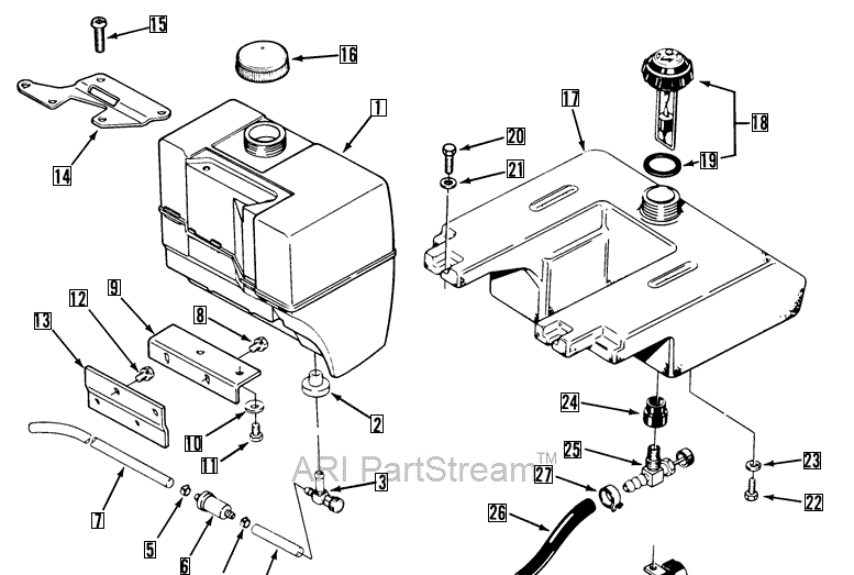

pbwfury 3 #1 Posted February 28, 2017 First off I would like to say hello, so hello, second of all I just bought a 1988 (I think) 308-8 and I'm having a real hard time removing the tank from the 8hp kohler engine. Are there some bolts hiding that I cant see? Any help is appreciated. Thank you, Paul Share this post Link to post Share on other sites
can whlvr 994 #2 Posted February 28, 2017 2 in bottom,2 on top,thats all there should be Share this post Link to post Share on other sites
rmaynard 17,575 #3 Posted February 28, 2017 Is your tank under the seat or attached to the engine? 3 Share this post Link to post Share on other sites

pbwfury 3 #7 Posted March 1, 2017 Thank you all for your help! Thanks for the exploded view Maynard as well! Share this post Link to post Share on other sites

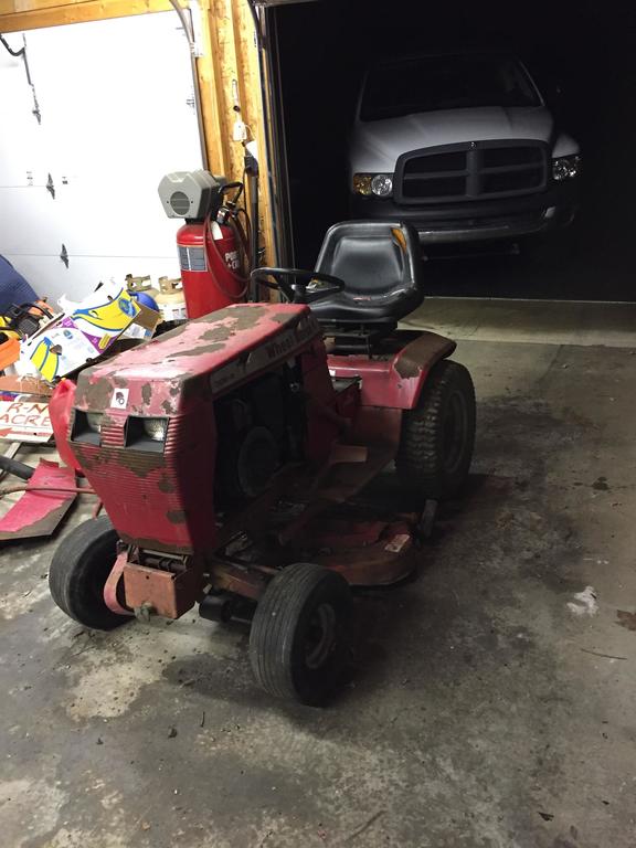

pbwfury 3 #8 Posted March 1, 2017 This is what I bought for 150.00 I'm not into good looks! Just functional! 3 Share this post Link to post Share on other sites
rmaynard 17,575 #9 Posted March 1, 2017 Nothing wrong with that one that a little sandblasting and paint won't fix. The M-8 engine matched with a uni-drive transmission is a good little tractor. By the way, how far are you from Falling Waters? Share this post Link to post Share on other sites

razorback1995 1 #16 Posted March 31, 2022 On 2/28/2017 at 5:24 PM, rmaynard said: Is your tank under the seat or attached to the engine? I'm having this same issue. I cant find the bottom screws to remove the tank. Do i need to take the whole engine off first? I've removed 14 and 15 in the diagram above What are the other bolts? Share this post Link to post Share on other sites
Handy Don 17,463 #17 Posted March 31, 2022 48 minutes ago, razorback1995 said: I've removed 14 and 15 in the diagram above What are the other bolts? Looks like 11 (with washer 10) Share this post Link to post Share on other sites
