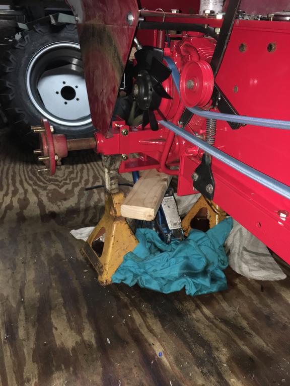

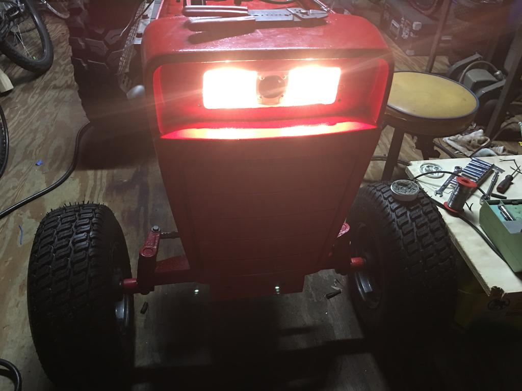

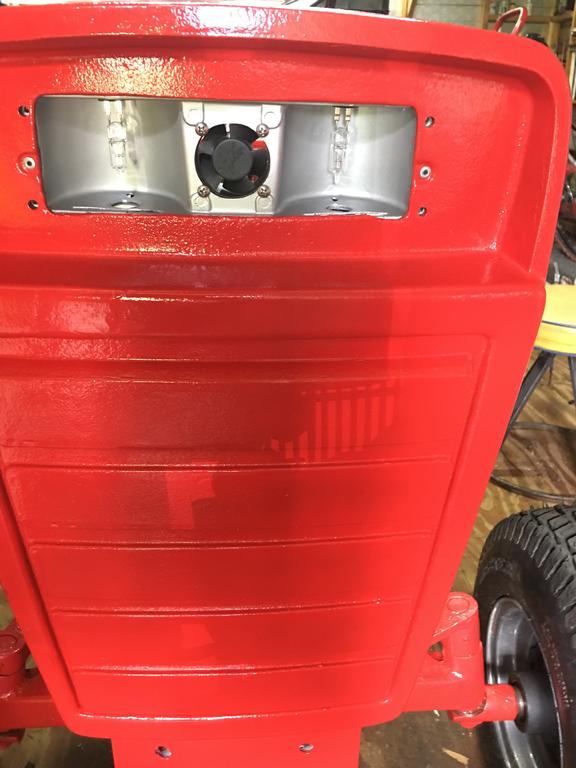

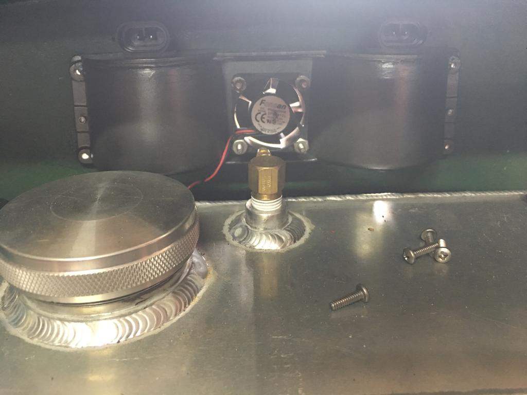

19richie66 17,932 #376 Posted May 28, 2018 (edited) Well she runs. Amazing what a set of points and a condenser will do for you. Oh and not having the fuel pump on upside down. Don’t ask, it was a late night when I put it on. Not good with staying up late anymore. Took all the power steering stuff out and went back to factory steering at least till after the show. Might leave it that way and use the PS on something else. All hiem joints except for onerod end. Steers good to me. Also got the headlights installed and they seem to work. Had the lense on for a little while and the fan running and the lense didn’t get hot. We’ll see how long it lasts. Half the fun of building stuff for me. Also have a pic of my helper for the day. She wouldn’t leave me alone so I let her jump in. Edited June 5, 2018 by 19richie66 4 10 Share this post Link to post Share on other sites

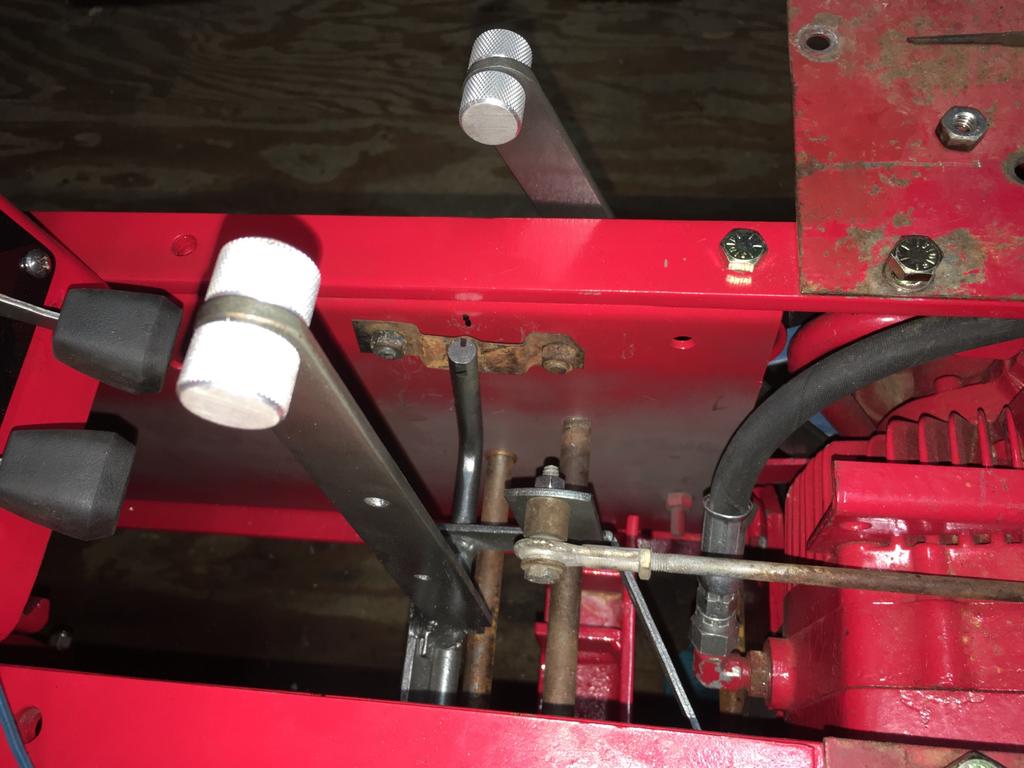

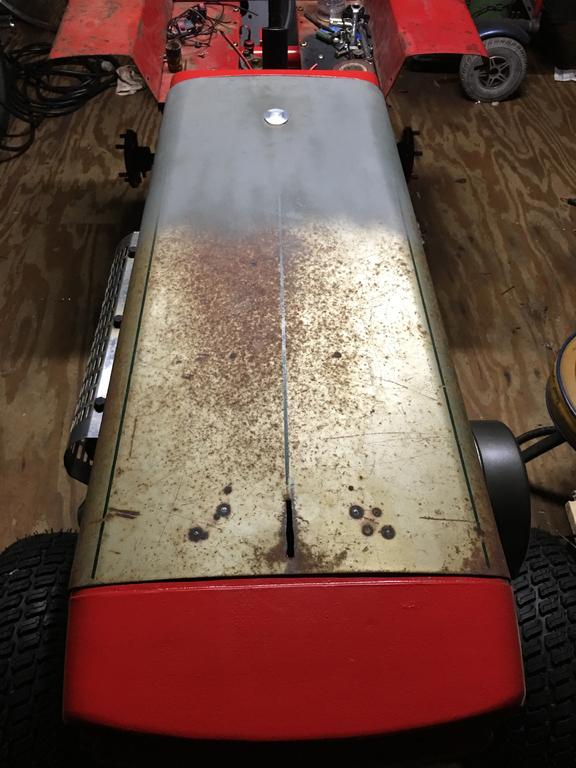

19richie66 17,932 #378 Posted May 30, 2018 Tonight I got the correct belt for it, installed it and put on the fan @wallfish. Pulled the rear wheels to paint the hubs and axles/axle spacers. Filled her with oil, retighten all the lines after a small spill and worked all the air out of it. She moves forward, backwards and when the brake is pressed, she stops and goes back to neutral. Also installed the 418-A neutral detent and adjusted her to where she doesn’t creep. Finished up my hood latch button. Still need to weld up the slot in the front if the hood. Getting down to the nitty gritty. 2 8 Share this post Link to post Share on other sites

953 nut 68,268 #382 Posted June 4, 2018 6 minutes ago, 19richie66 said: it moves! She is strong feeling too. Moves pretty good, and those lights are blinding in the full sunlight! 1 1 1 Share this post Link to post Share on other sites

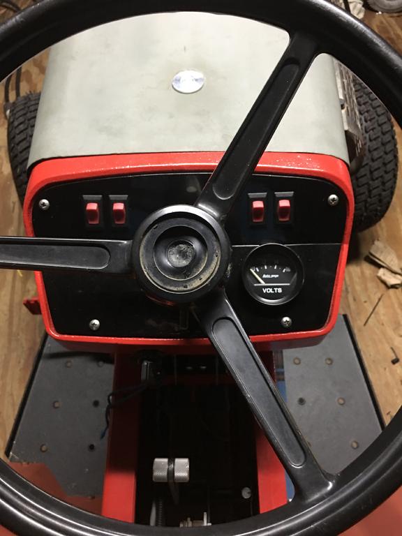

19richie66 17,932 #389 Posted June 4, 2018 Added a volt meter. Also when you can’t find a good seat adjuster plate, you just fix the one you have. 2 7 Share this post Link to post Share on other sites
WHX?? 57,661 #390 Posted June 4, 2018 (edited) I was gonna say Ritchie you look like a pretty tall dude and a little cramped in the saddle. Edited June 5, 2018 by WHX19 2 Share this post Link to post Share on other sites

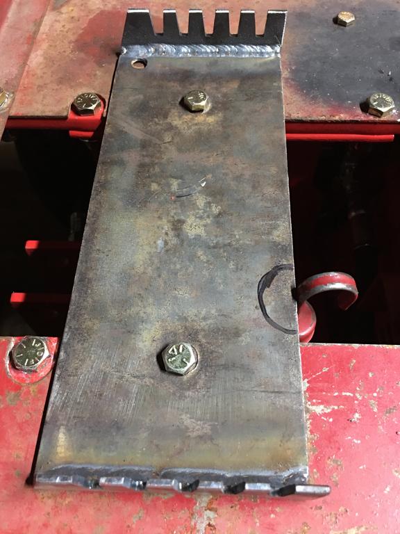

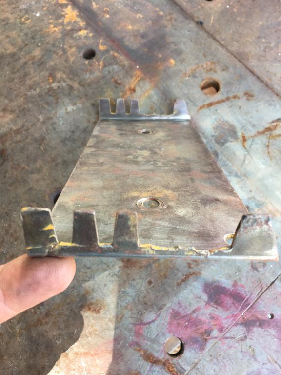

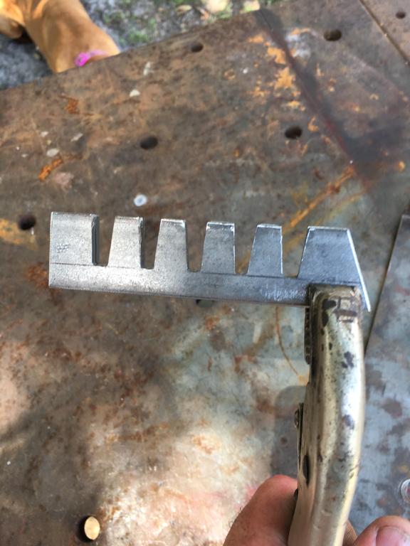

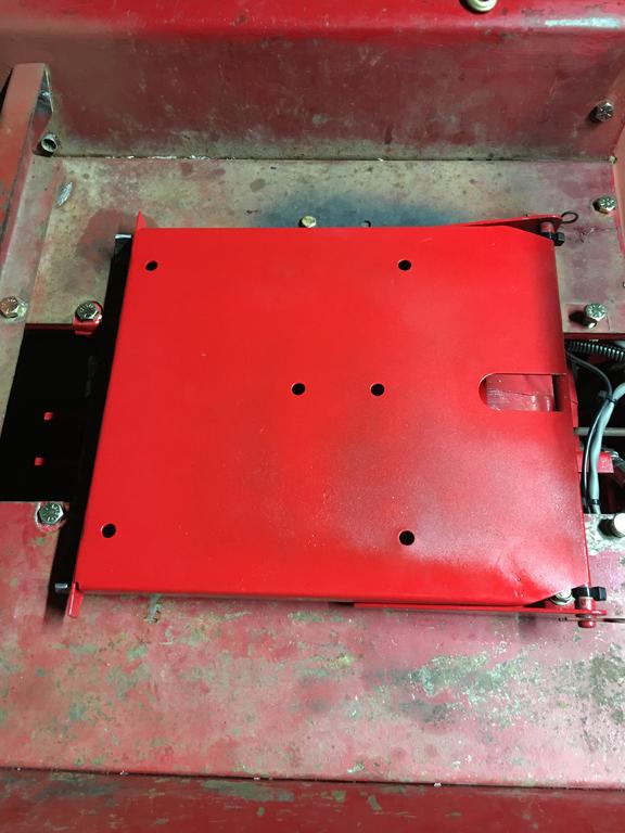

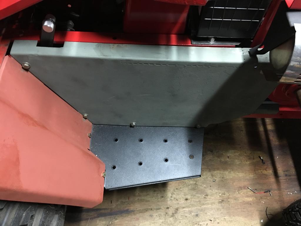

19richie66 17,932 #393 Posted June 5, 2018 Welded up the seat adjuster plate, installed the seat base for a test fit. Still have to notch the adjuster plate for the trans dipstick. Hope to get me a seat this week. Also test fit the side cover. The lower guide is a little too long and is bent a little. Now I can put a little more downward bend in it where it sits below the pulley. It rubs the belt just a hair. Also have to make a mounting tab for the front that will slide under the battery tray. Had to cut the front tab off because my “replacement” engine doesn’t have the outer ring of mounting holes that a factory engine does. No big deal. Got it already figured out and will make it tomorrow. 8 Share this post Link to post Share on other sites

Aldon 4,832 #396 Posted June 5, 2018 If you want to start production on heavy duty seat adjusters let me know. I’ll be your first customer:-) nice job! 1 Share this post Link to post Share on other sites
19richie66 17,932 #397 Posted June 5, 2018 I can set you up but it will be after the show. 😁 2 Share this post Link to post Share on other sites
