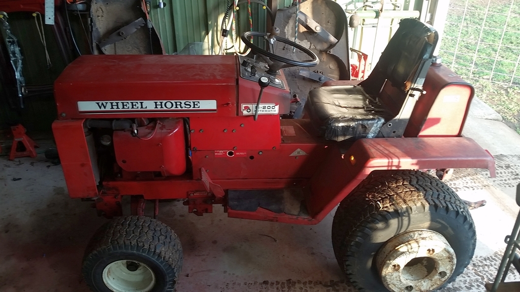

A D200 followed me home from Missouri.
It has a blown engine so I am pulling the 20hp Kohler out of my D180.

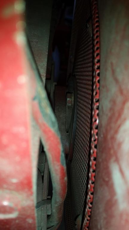

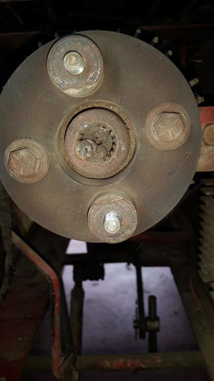

Is it just the two bolts I can see to seperate the flywheel from the pump? I have everything else off, ready to pull. These bolts:
  • Like 9
"D"- Man
I have replied to a topic, posted on March 20th 2013 entitled D - Series Questions  with pics showing this area in reply #36 The engine, once unbolted, should be able to slide forward in order to disengage the splined cast coupler from the hydro pump shaft assuming that it has not been drilled and retrofitted with a roll pin or bolt through.  Here are some pics from that post.

Well tugged a few times and no budging. Removed the two bolts and slid her off. Found some "custom work."
