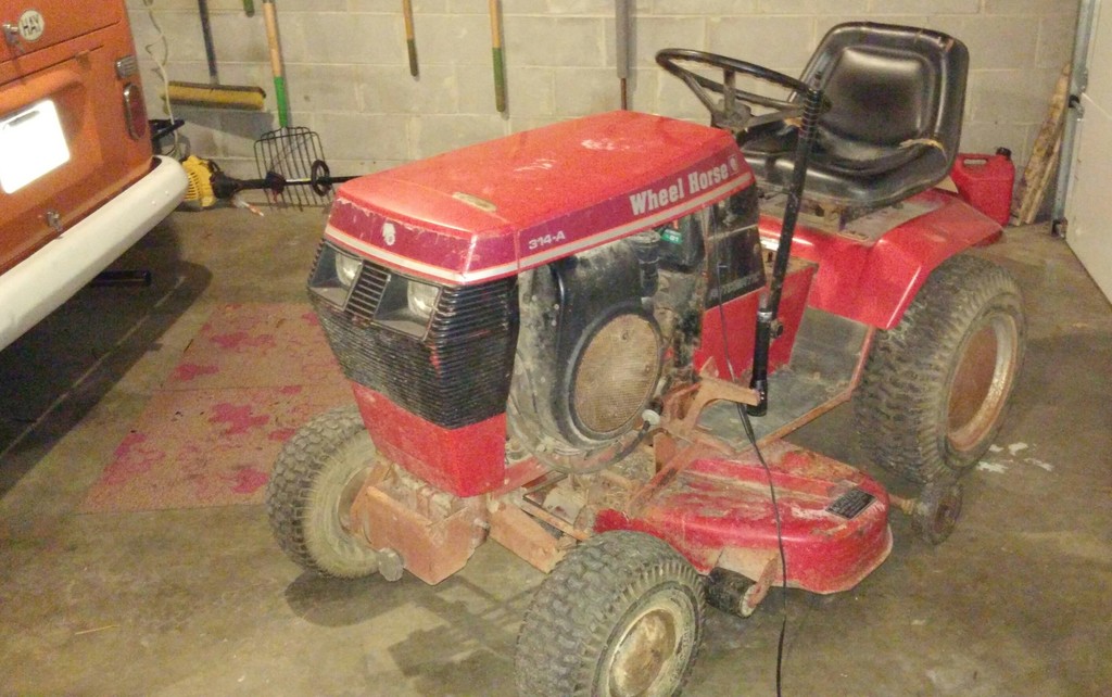

Busman 14 #1 Posted February 26, 2017 Hi guys, I've been reading the forum for a while but just got my first horse today. I picked up this '85 314-A about an hour from me for $250. It's got some surface rust and needs a choke cable but runs great and the mower works too. I'm going to go through and do a full tune-up including oil, air filter, clean up all electrical grounds and connections, drive belt, new blades and definitely a wash. What else would you suggest? 4 Share this post Link to post Share on other sites
Sparky-(Admin) 25,991 #2 Posted February 26, 2017 I just brought home a 312 hydro today myself! As well as what you mentioned I would make sure the rear hubs are tight on the axles, take the PTO bell off and apply a thin layer of grease and then make sure you give all the grease zerks a nice shot of grease. I think there are about 6 zerks. Mike...... Share this post Link to post Share on other sites
608KEB 829 #3 Posted February 26, 2017 Clean and grease PTO. Check front wheel bearings. Change sparkplug and fuel filter. Possibly replace fuel lines. Clean underside of mower deck and grease. 🙄 Share this post Link to post Share on other sites
