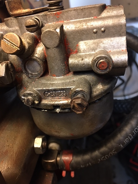

PSully 61 #20 Posted February 28, 2017 I used my Dremel today to remove an air cleaner support screw (I believe it is a #6 32) from the carburetor on my k181. I used a thin cutting disk to cut a screwdriver slot into the end of the screw. I had to cut into the aluminum of the carburetor in order to get my screwdriver slot deep enough, but that's fine. I then heated the screw with my soldering gun, and tried melting wax into the threads. This is a trick that I heard from a mechanic friend. I heated it more, and gave it shot of liquid wrench, then I heated it about two more minutes. When I was convinced that it was worth trying, I found the right size screwdriver, and I was able to remove the screw pretty easily. I might not had had to heat it at all because the threads looked pretty clean once I had it out, but I didn't want to chance messing up the slot. 2 Share this post Link to post Share on other sites
