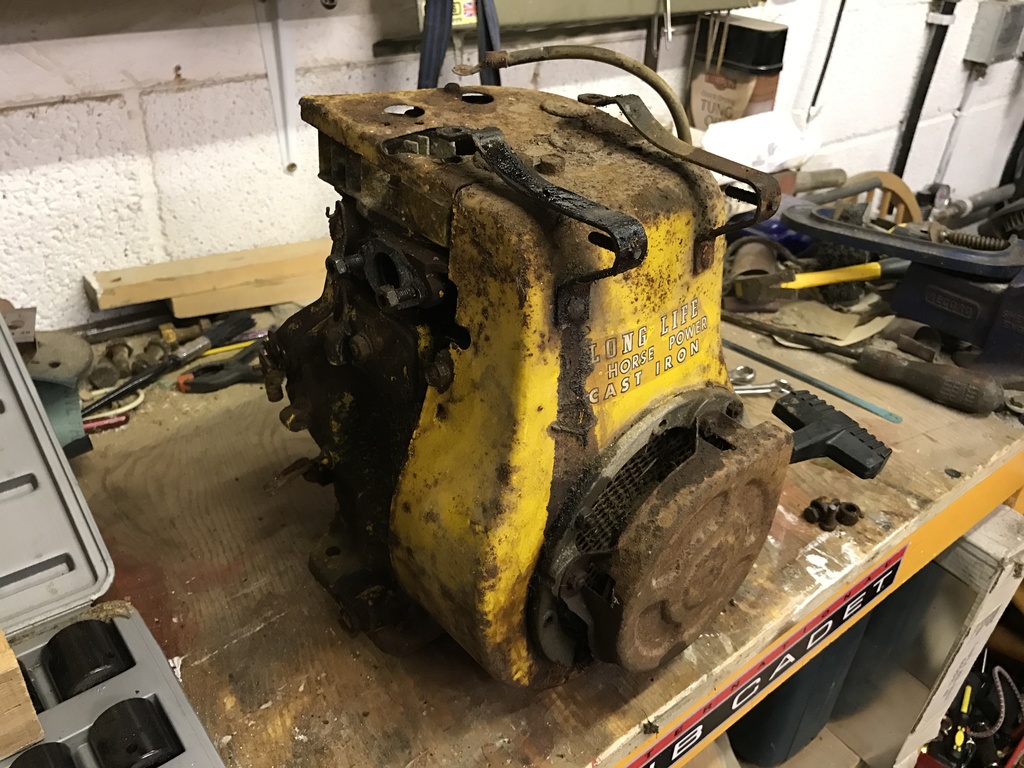

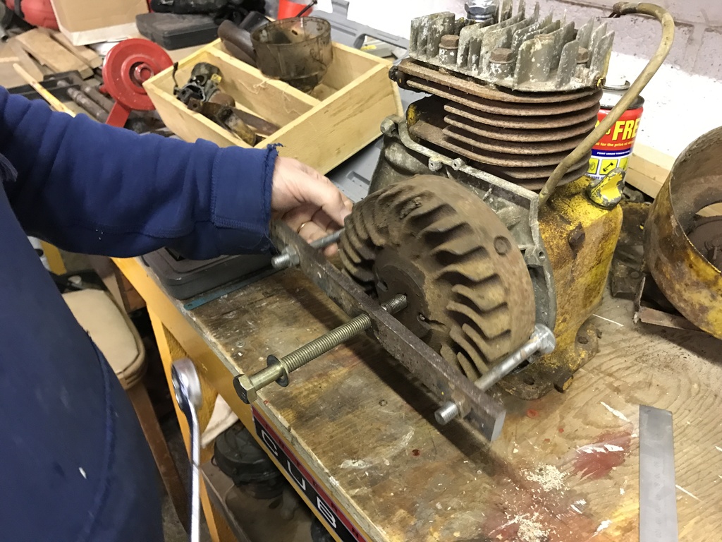

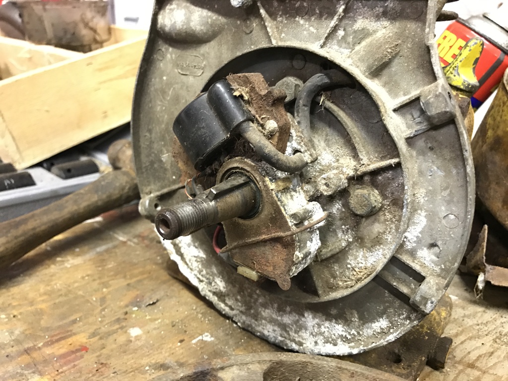

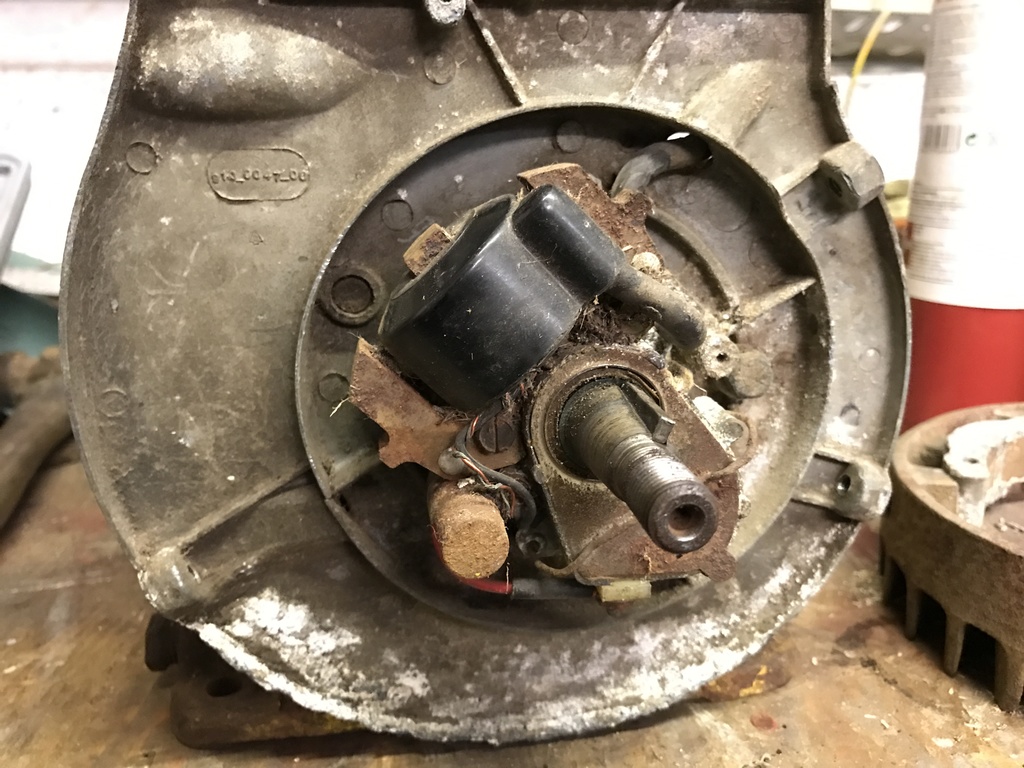

Hi, I recently bought a Clinton engine for my RJ 58 but it has no spark. We have removed the flywheel, what shall we do next. Thanks

Clean the magnets in the flywheel, clean the coil, clean the points, replace the condenser, check the air gap and hope for the best!
I did all this and still had erratic spark on a Clinton....Come to the conclusion the magnets had lost their strength!
  • Like 1
wallfish
Remove this points cover and clean the points contacts or replace them, might as well replace that condenser and clean up all the wire connections while you're in there.

Was this "engine" being used as a boat anchor?:ROTF:
  • Like 1
wallfish
HA, does appear so doesn't it.
Those poor guys across the pond have it tough when dealing with American engines but it's nice to see they're up to the challenge of turning boat anchors back into horse power
  • Like 3
woodchuckfarmer
It is a little crusty around the edges.
  • Like 1

Cleaned and set the points but still no luck, Going to buy a new condenser first and see what happens.
